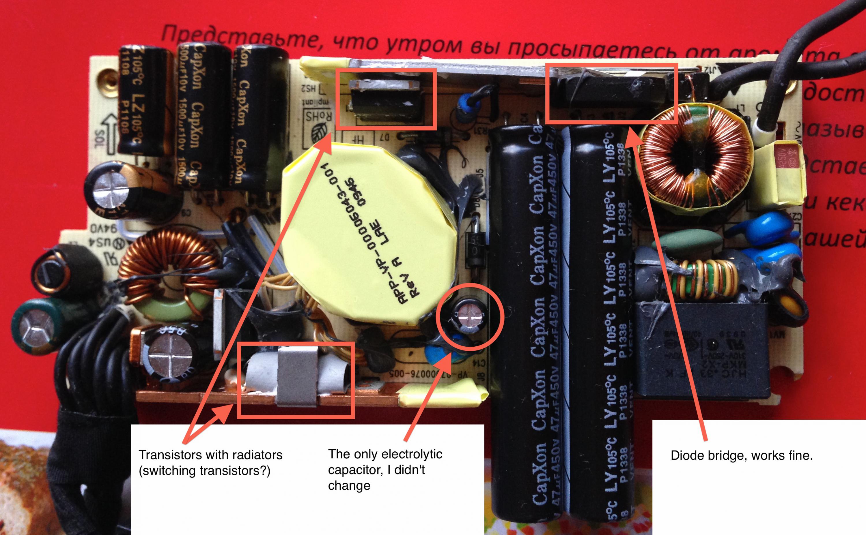

    Hello! I'm not very experienced technician… Just trying to repair power adapter from Time Capsule. Maybe anybody have experience in these units?
    This power adapter must output 5V and 12V. But now it outputs 0. I made full recap. Also, I checked voltage at output diode bridge - it's DC 220 V, so diode bridge is working.
    I don't have scheme so I don't know what to check next… So I'm ask maybe anybody know what the most possible can be broken (if no capacitors) in such power adapters. Manufacturer - Flextronics.
    Some photo attached. Thanks for any help!

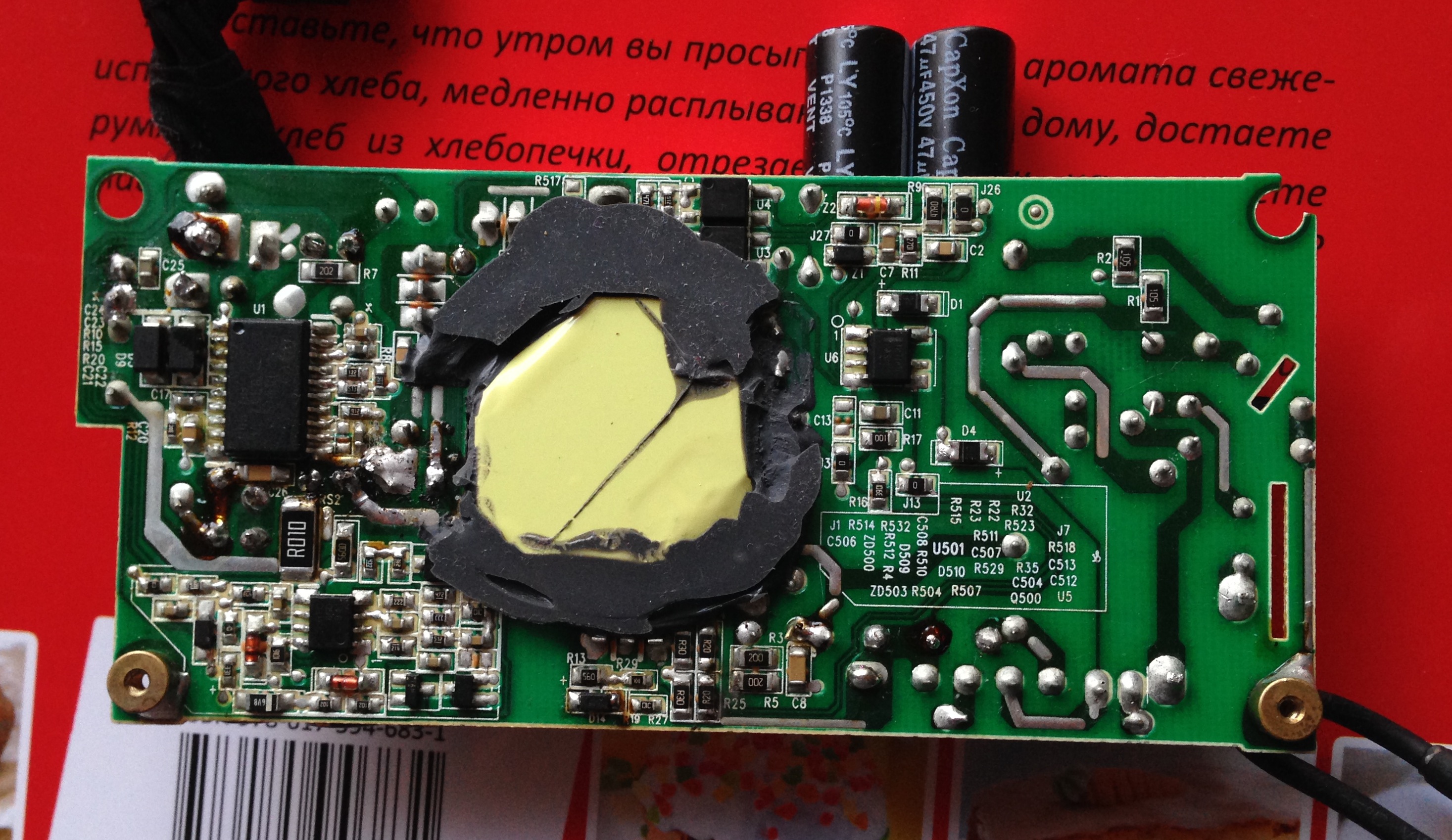

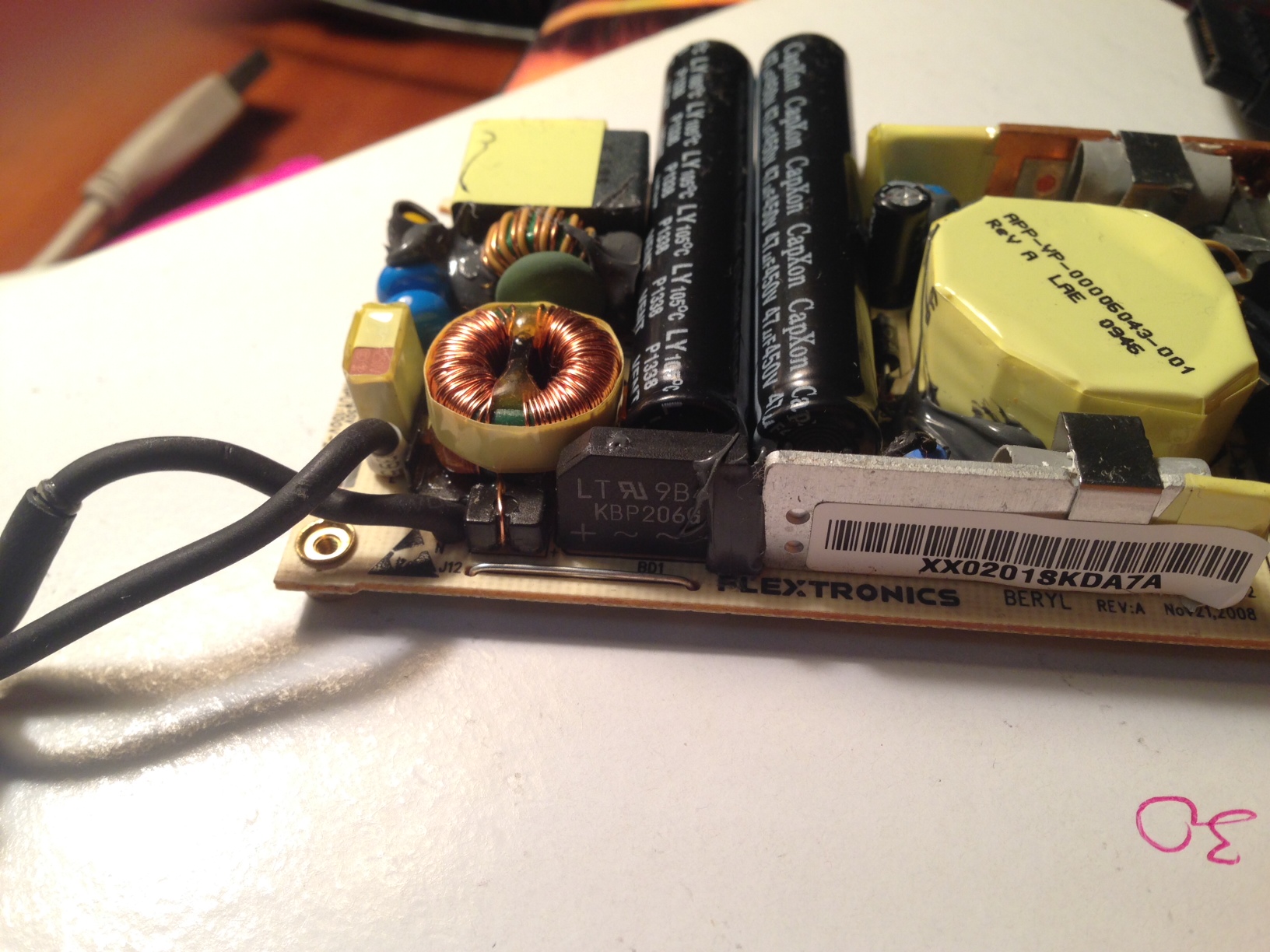

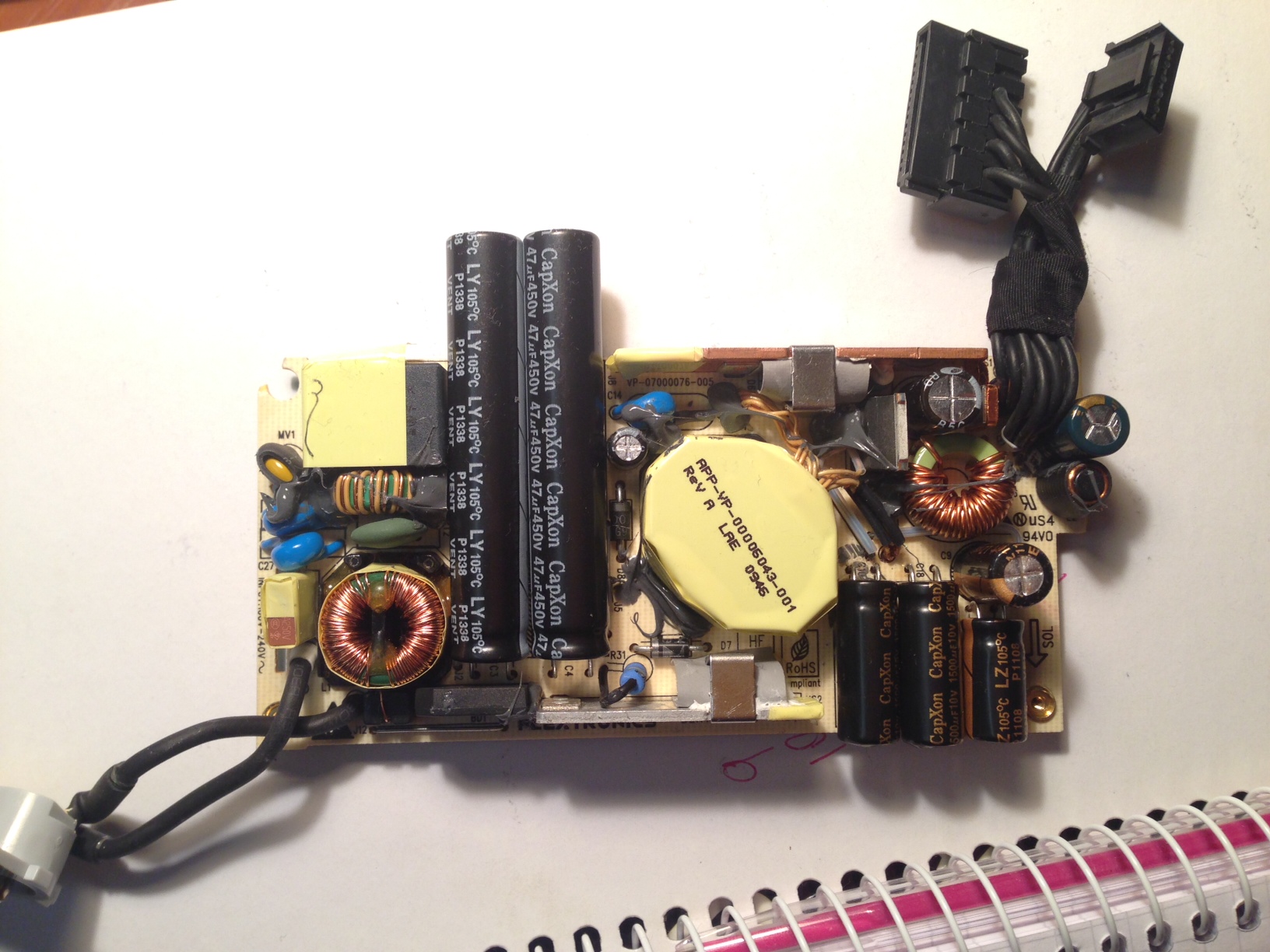

            Re: Power adapter from Apple Time Capsule - 0V at output
            Post good clear straight shots of both top and bottom side of the board, it can be as simple as bad start up cap (the small electrolytics cap next to those two 450VDC filter cap) in the primary side.
            The power MOSFET mounted on the heat sink on the primary will usually failed shorted circuits which will cause the main fuse to blow, but since you are getting the DC on the main cap, the main fuse is OK.
            You can try heating that start up with hair dryer to see if the circuit will start up if the cap is not too far gone, you can also measure the DC voltage at the two legs of the startup cap, just be real careful since you will be working in the deadly primary side of the circuit.
              I have made good (good, not perfect) quality photos of board. Also, I added some comments. Attach them here.
              As I understand, I need to try heat up small electrolytic cap (in red circle on my picture) during start up to see if the board will work under heating?
                That is the start up cap, I would replace it (try heating it to see if the power supply will start up), that device mounted on the heat sink is the power MOSFET which drives that yellow power transformer.
                Also take the DC voltage reading right at the two legs of that start up cap.
