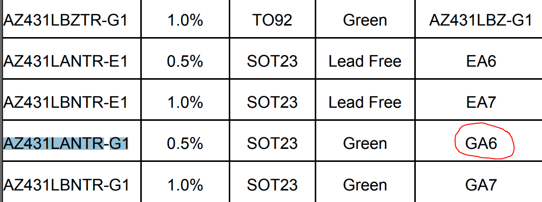

Help identifying this part in AP-396AM Sony tv psu
    Looking for a replacement for this. It's in the 3.3v standby section.
    I think it reads GA6

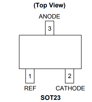

    I could be an A6 switching diode but I'm not sure because pin 2 is connected.
    Any help would be much appreciated
    IC951
    Thank you!
    I'm now thinking it may be a APL431L Shunt regulator as it connects to the optocoupler that gives the primary side driver ic feedback
      GA6 - AZ431LANTR-G1

        GA6 - AZ431LANTR-G1
        Thank you. I've been searching for GA6 and was not able to find this. really appreciate the response
