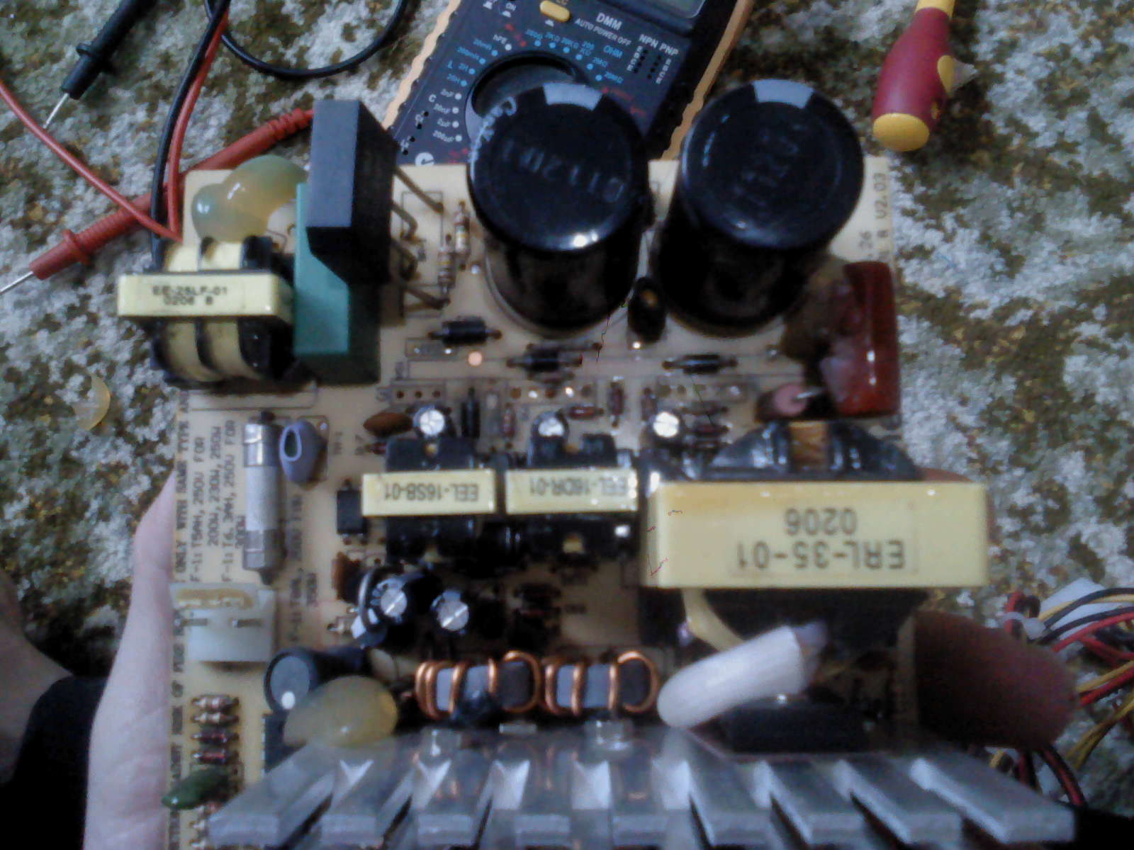

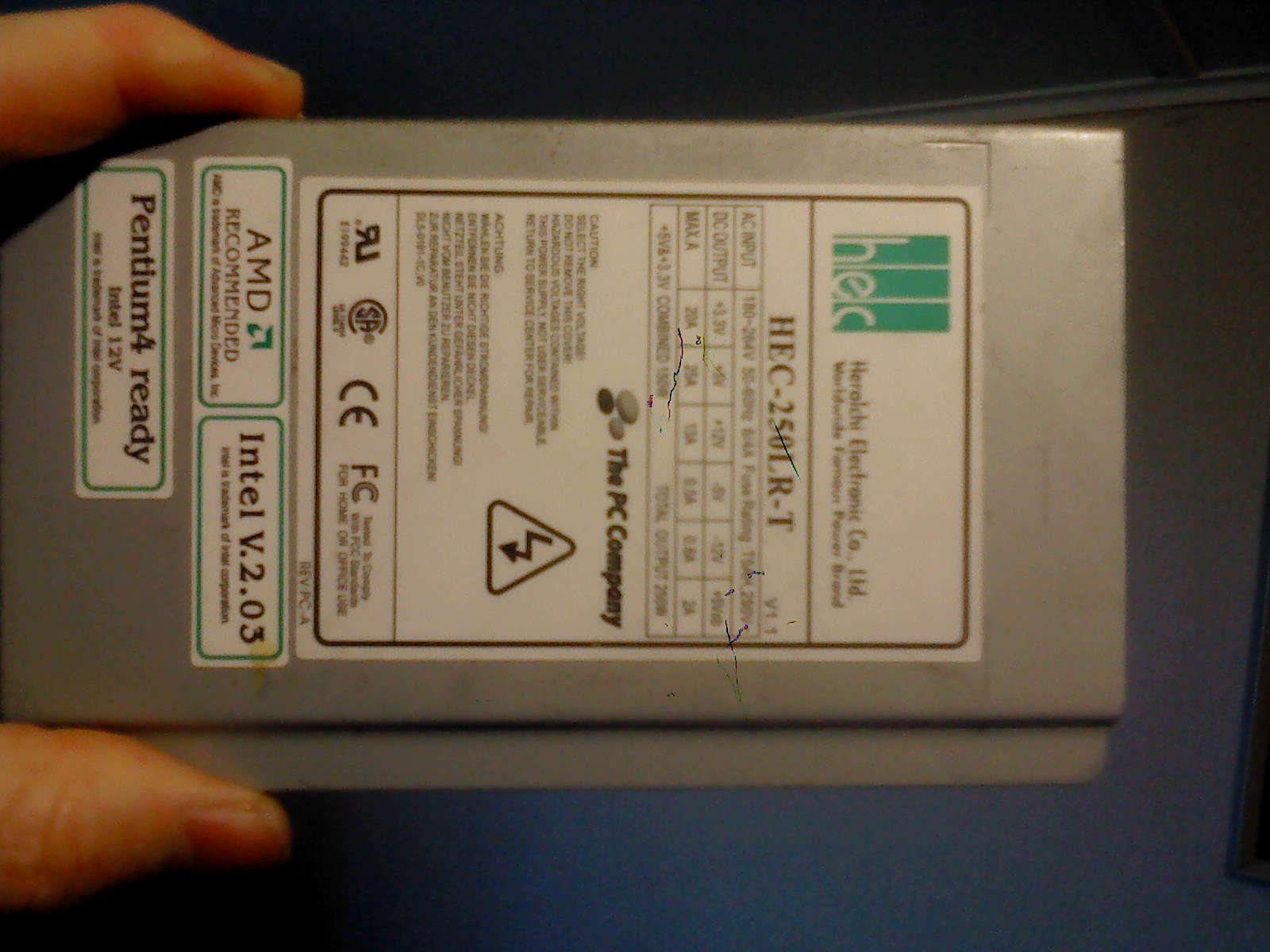

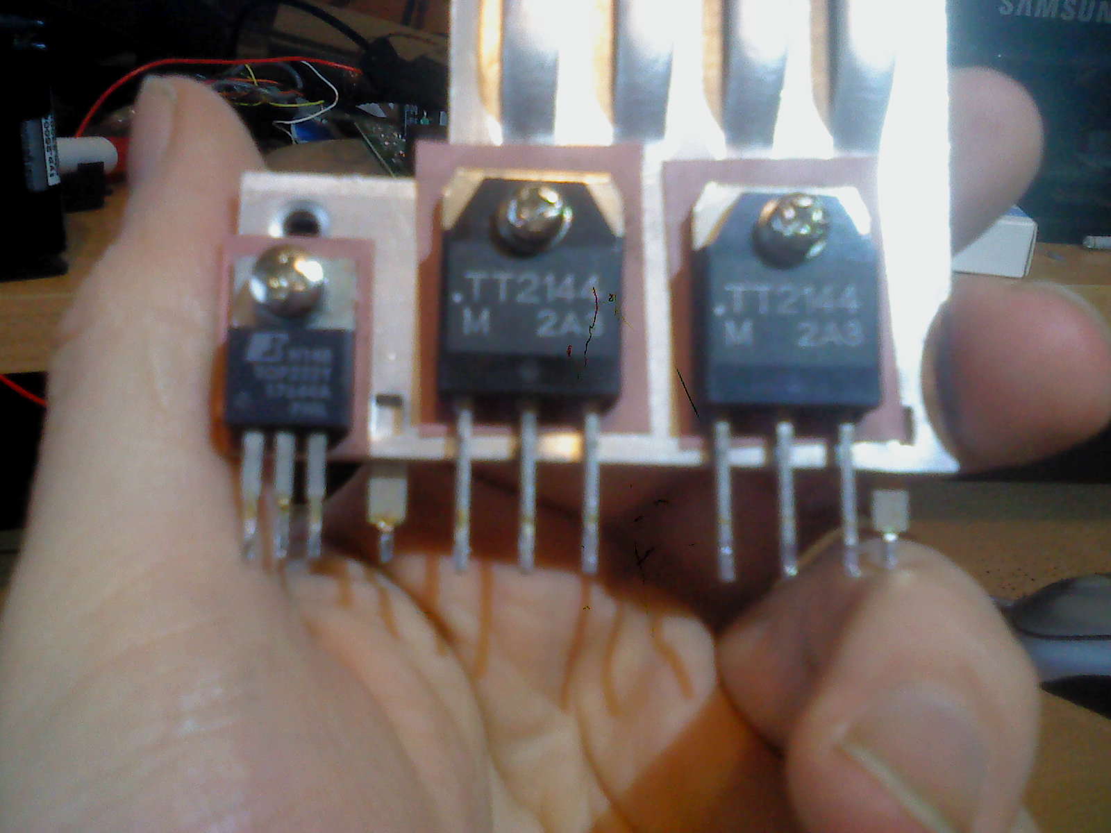

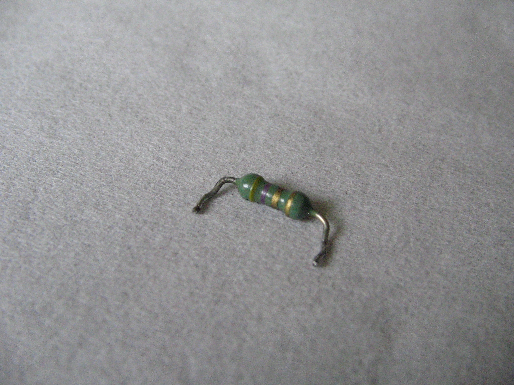

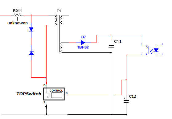

    Hello my power supply for my old pc went pop during a power dip when ups kicked in.
    Found the 5vstb controller a TOP222Y has failed 42ohms drain to source,
    and a resistor that I can't identify it's color code is "yellow violet gold gold" that is what made the pop sound.
    My pc

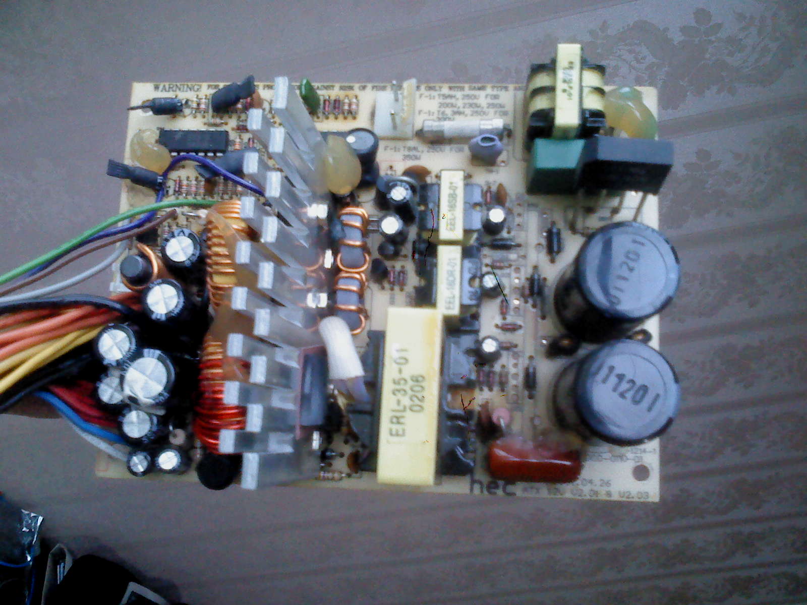

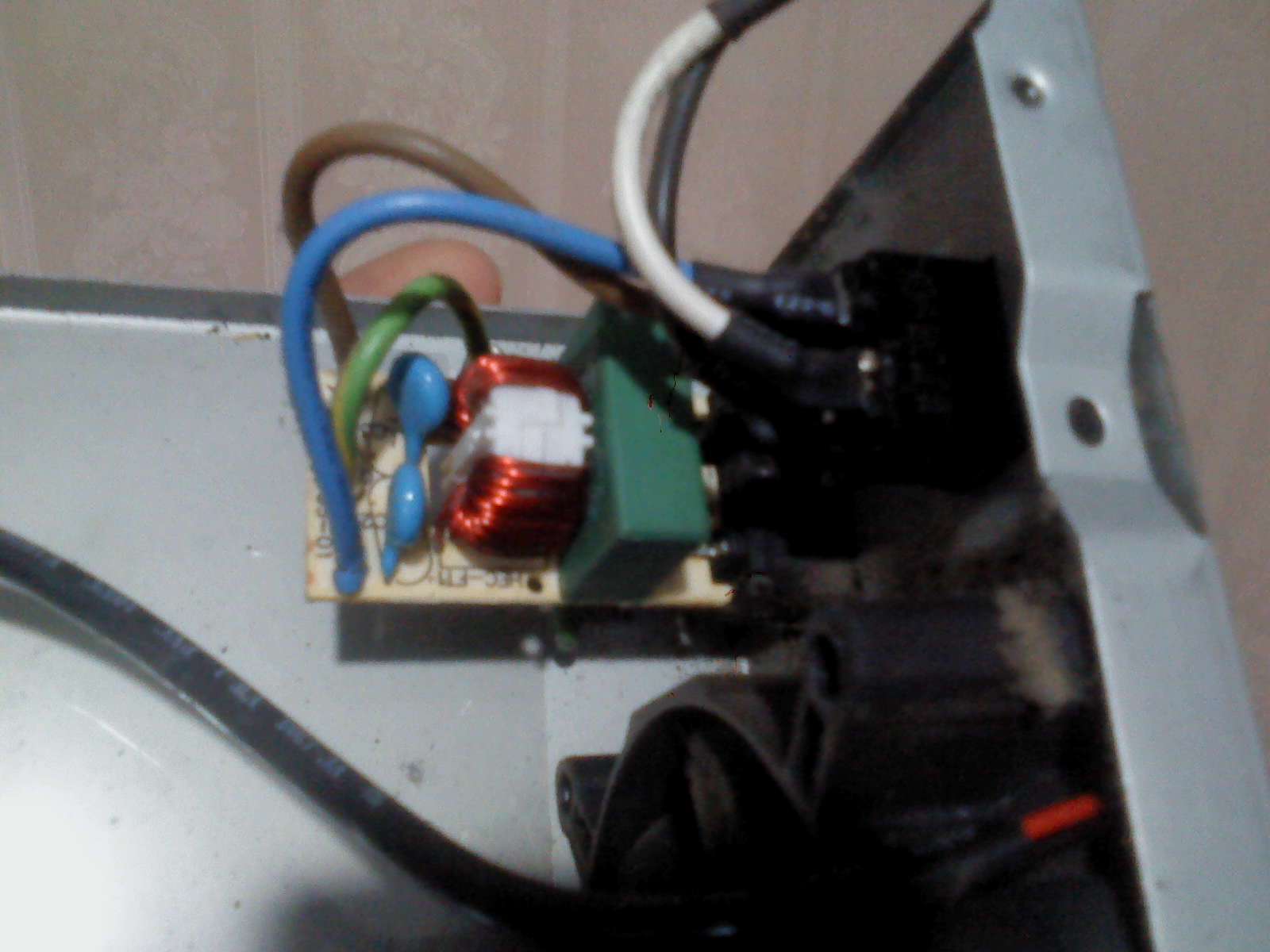

    Re: HEC-250LR-T ATX Computer psu
    Guessing no MOV's in there? Pictures?
    • joshnz
      • Feb 2011
      • 969
      • New Zealand
      Not much too see does have mov's
        I think the resistor value should be 47K, but I am not sure . Can you draw a schematic for 5VSB Primary Section only . And have you any datasheet of TOP222Y Mosfet ?

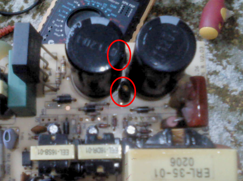

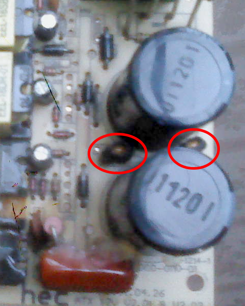

          There are two MOVs between the primary caps:

            Here is circuit same as in data sheet.

              All i need to know is resistor value to replace and replace TOP222Y.
              And hope no high voltage pulse went out the secondary.
                Then It should be a fusing Resistor of 4.7Ω/1W . Use a 100W series bulb tester at test condition for avoiding damage .
                  It is a 1/4watt or less I know that much by its size.
                  It will be a over a month for replacement top222y to arrive.

                          • everell
                            • Jan 2009
                            • 1514
                            I would argue that the resistor value should be 0.47 ohm.
                              That is what I was thinking due to it been smaller than a 1/4 resister.

                              • kc8adu
                                • Nov 2003
                                • 8832
                                • U.S.A!
                                that 3rd band could be silver...
                                it looks different than the 4th.
                                which is gold.
                                  I have one of these HEC-250LR-T v1.1 sitting here, also dead. As long as the same resistor isn't blown I can tell you what yours is supposed to be, tomorrow.
                                  What's the refdes of your dead resistor?
                                    Well, that's interesting. R011 is OC on mine too. But I can confirm it's Yellow-Violet-Gold-Gold, so assuming they used a normal code then it's 4.7 Ohms, 5%.
                                    My TOP222Y though measures 30 Megohm G-S (both directions)
                                    Also there is a missing component near the comparator, looks like R41. Is that same component missing on yours? (see approximate center of photo)
                                    A first I thought it might have vaporised since there are leads but no body, but there are no burn marks or carbon so maybe that's not the case. Very strange.
                                      Ok agent I seen your thread on this psu I'll have a look at mine when I get home.
                                      They top222y is not a mosfet it is a ic with a mosfet built in.
                                      It has pins
                                      Drain negative of transformer
                                      Source DC -
                                      Control VCC and Feedback
                                      What is the reading between Drain and Source.
                                        Sorry, where I said "gate to source" should have been "drain to source"
                                        Or in other words, the two right-most legs on the package when viewed from the front.
