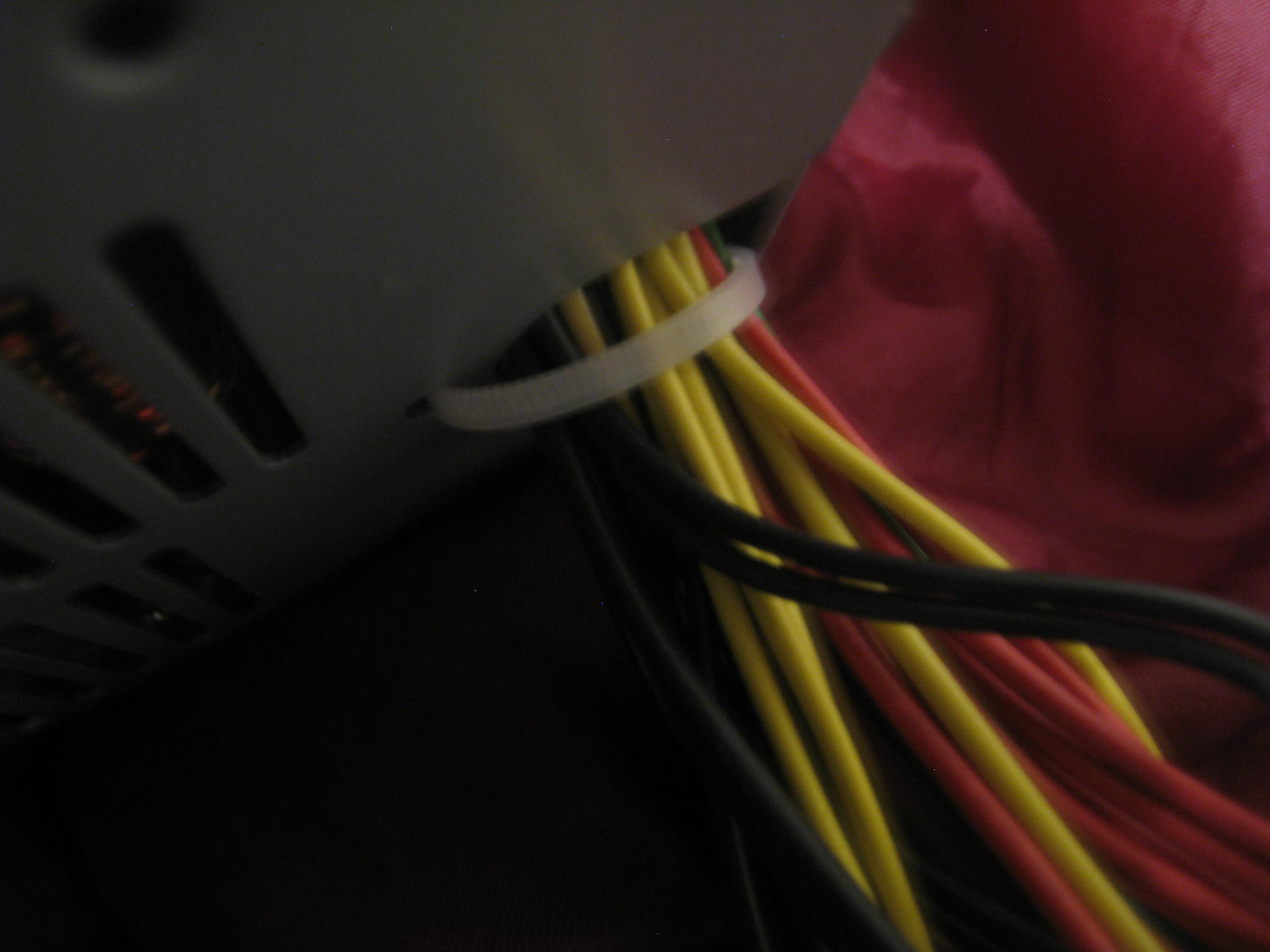

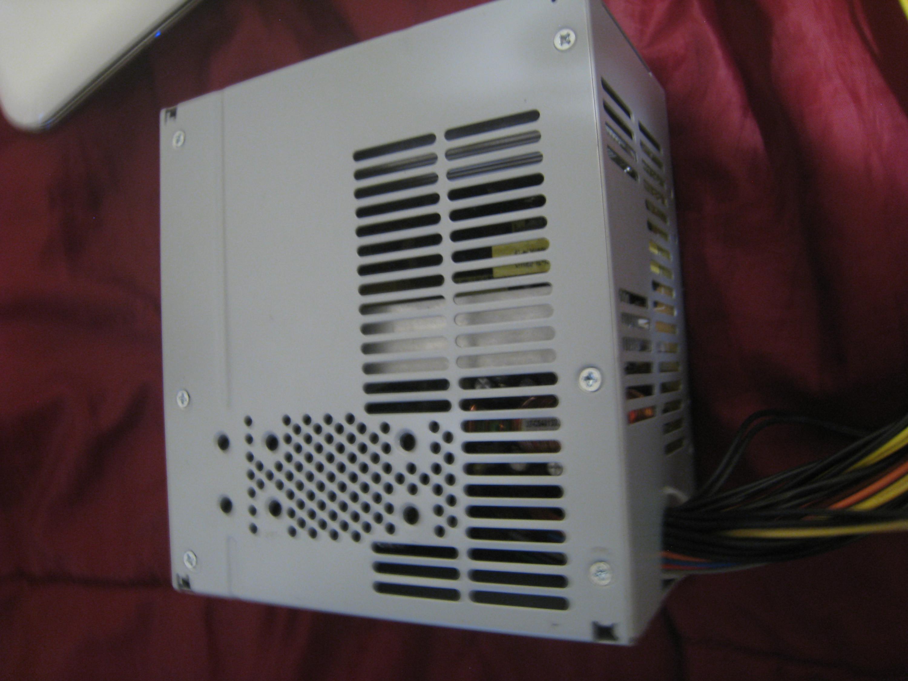

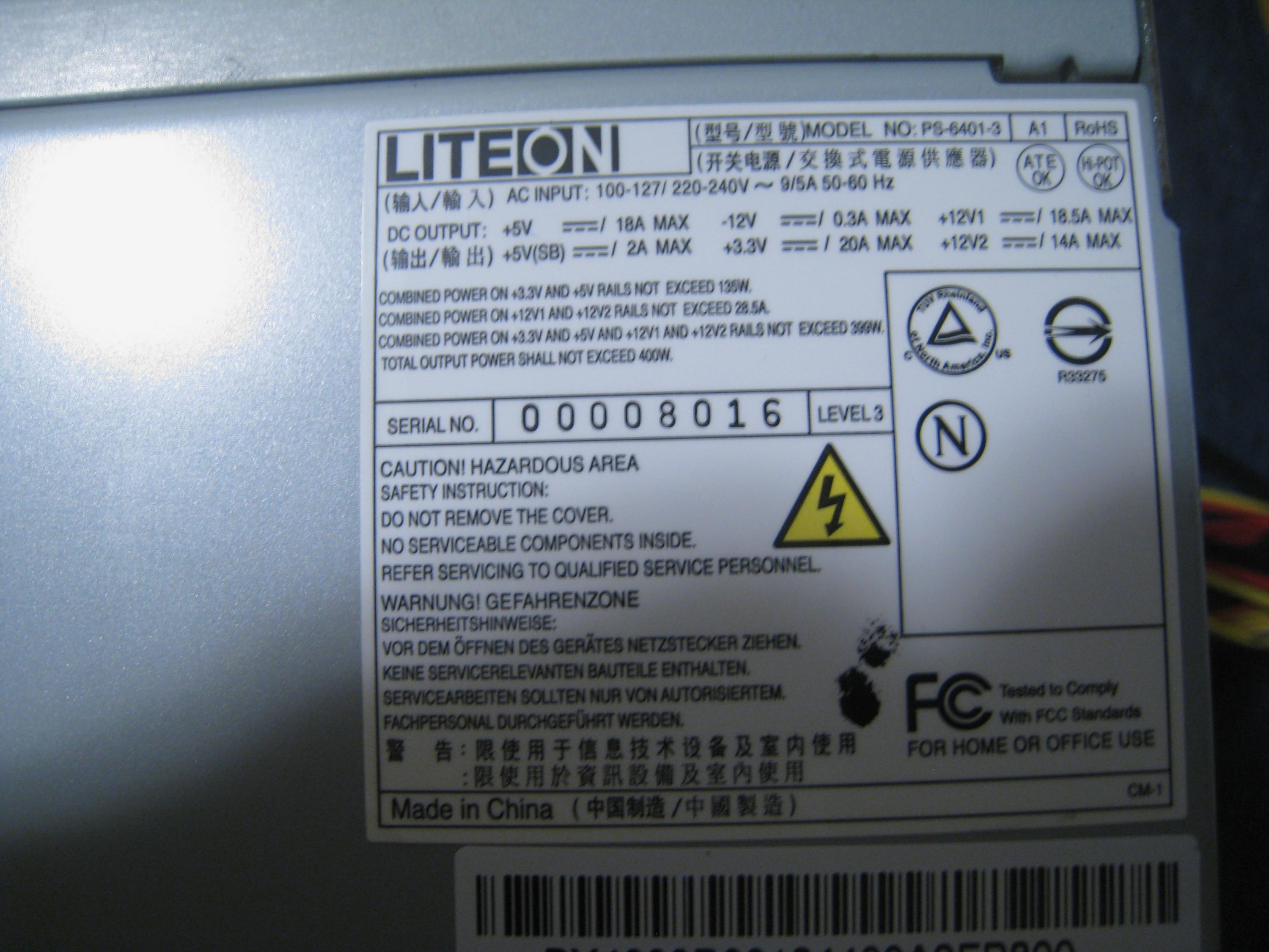

    Came from a friend awhile back.. Working pull.. I may have cleaned it but looks new.. I have this sitting around as a backup PSU... Keep it? Trash? I'm sure the caps aren't the greatest.. I can see some OSTs on secondary.. Not sure if I posted about this PSU before.. Works fine.. Very lightly used.. Haven't cracked it open yet..

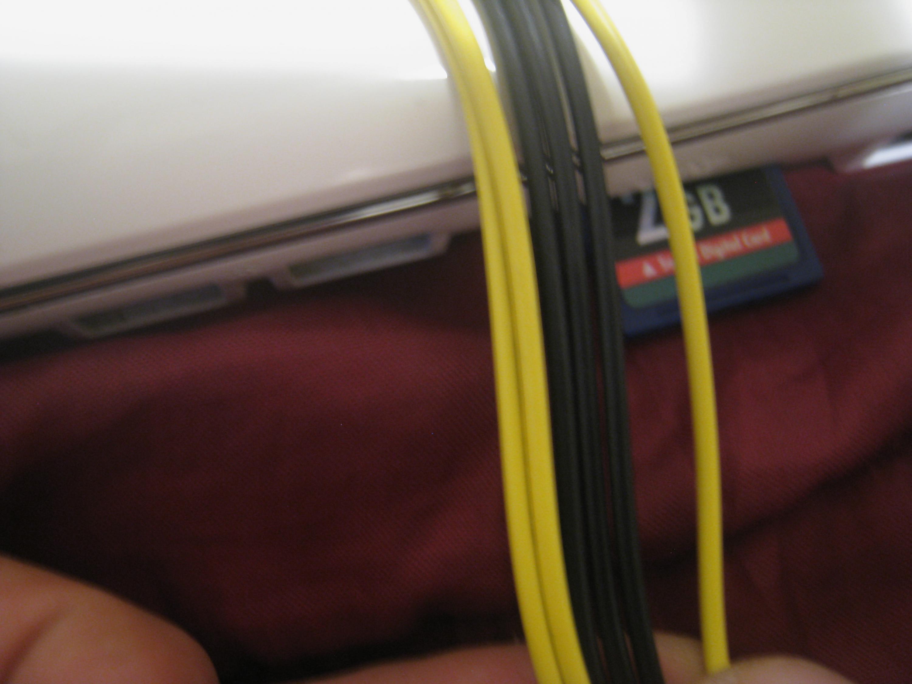

    No shielding for cabling.. Thinnish wires.. A zip tie as a guard unless the actual guard fell inside.. It packs some ok weight, alot more then a cheap cheap unit from a surplus store etc.. Will have to see whats inside soon..
    1 x 24 Pin Motherboard Connector
    2 x 6-Pin PCIE GPU (PCIE1>>PCIE2) Connectors
    1 x Very short 12V CPU Connector
    1 x Long Sata >> Sata >> Molex Connectors
    1 x Short Sata >> Sata >> Floppy Connectors

    Meh. Lite-On is generally okay. It can probably do its rated wattage. OST caps are 2nd tier, so while not great, they're better than, say, Fuhjyyu or CapXon.

      Keep it. Even though they may use mediocre capacitors, LiteOn PSUs are pretty good otherwise and will do their ratings. The PSU also has dual 12V rail. Should be plenty to test just about anything you come across (minus a setup with multiple heavy-power graphics cards).
