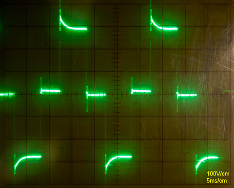

      Don't think so. Many of them do "sine wave aproximation" what ends like this
      That is an actual UPS (APC BackUPS 500 VA) with Seasonic S12-II. I have the feeling the X-Bit Labs do this testng with each PSU they review and most of them do not work together with such UPS properly. And their PSU has "iteration aproximation of sinus-wave" which should be "hunchbacked" sinus, not that stuff at this picture and still, some of them almost do not work at all.

        Re: Non-sinusoidal UPS+active PFC -> DC feed?
        That's the exact setup that I have, and everything works fine.

            What version and what PSU? They made like 10 of them. Just read through X-Bit labs reviews, most of the PSUs do not work over 300 watts.

                  I don't think it's loaded that heavily. It's a Seasonic S12II Bronze 520W, and now that I looked closer, it appears that I actually have a 600VA (APC) UPS, not a 500VA.

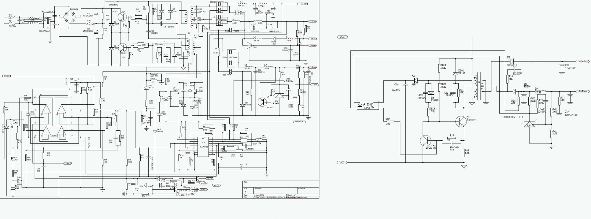

                          well here is a schematic for an newer 400 watt ATX12 PSU and i don't see anything before the mains rectifier...
                            This is either no- or passive PFC PSU, it has voltage doubler.
