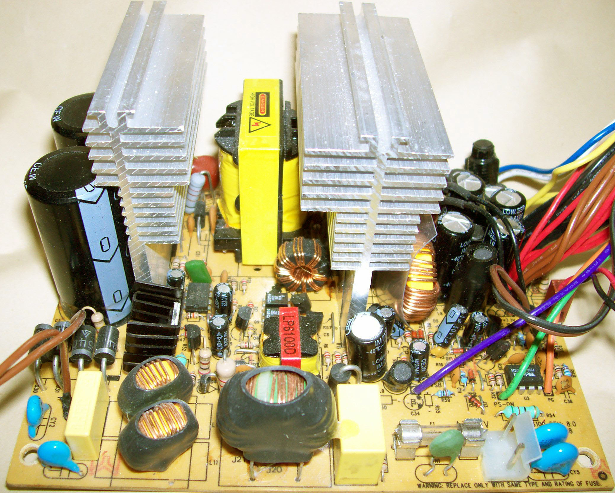

                          Here's a Leadman identical to Pentium4's CompUSA unit, right down to the April 13, 2001 production date, only the +3.3V has a choke in its output, and the heatsinks are different.

                            #53
                            Re: Found a brand new Comp USA PSU
                            Originally posted by larrymoencurly
                            I had an ATX that may have originally been an AT design because its 5Vsb was on a separate circuit board. PC Power & Cooling featured it in a magazine ad to show how bad a PSU could be.
                            Those are actually nice heatsinks ... big rectifier diodes, probably 1N540x type? The transformer isn't one of those really tiny ones, and there is proper EMI filtering ... only bad thing is the caps .. rulycon on the output? :P

                                      #58
                                      1N5404 diodes and all JEE brand capacitors, most of them swollen. The transformer is the same size as those in 300W Antec SmartPowers.
                                      I had an even older Leadman PSU with Leadman brand capacitors in it.
                                      Originally posted by Pentium4
                                      And at least yours has a little heat sink on the 5VSB transistor
                                      I added that because every other ATX power supply I saw had that transistor mounted on a heatsink.
                                      Back in the olden days, CompUSA got its brand of PSUs from many suppliers, including Win-Tact (used by PC Power & Cooling), but there was no way to tell from the cardboard box, and CompUSA wouldn't let us open it unless we paid the 15% restocking fee.
