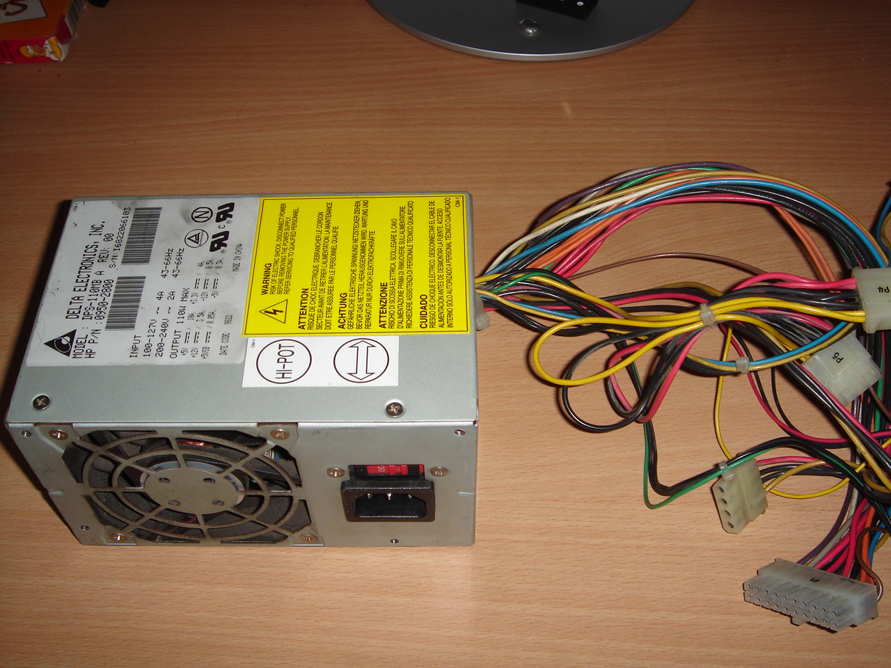

    Hello All,
    I have a "retired" HP Pavilion 6305 Desktop PC with a wierd shaped PSU. It uses the 20PIN ATX connector, but it just doesnt boot!.
    I tested the fuse and it is fine. When i plug it into the wall, nothing happens, no boot, nothing. It just died one day when it was left on for a while.
    Anyone got any ideas? It still works with a standard PSU though.

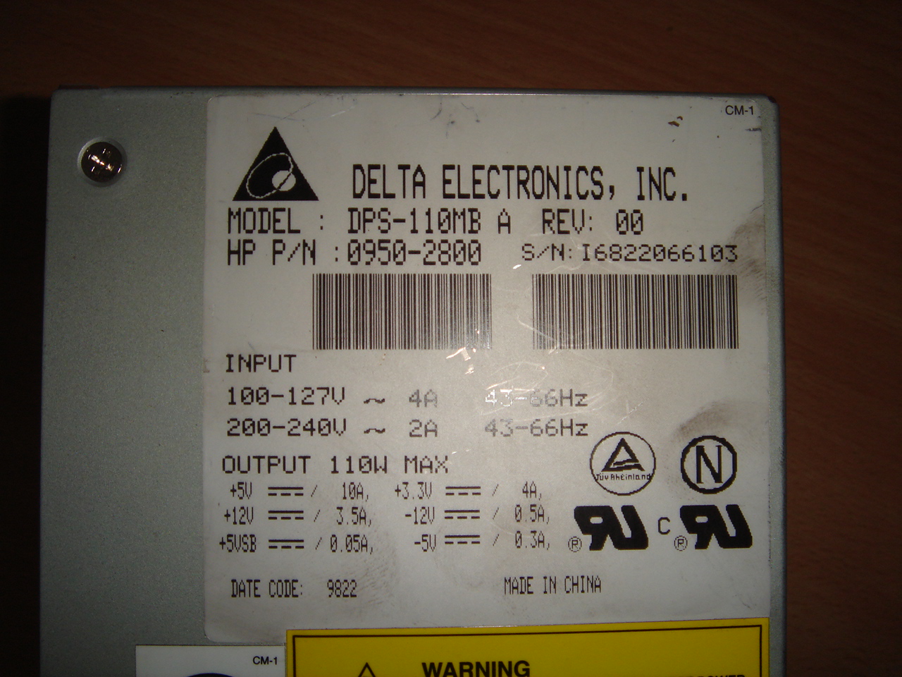

      Re: HP Pavilion 6305 PSU
      Thanks Linuxguru for the advice, but it's not a Bestec power supply.
      It is a Delta electronics DPS-110MB A REV:00, HP P/N 0950-2800.
      I inspected inside it and it appears to have KZG chemicon caps, and none are bulging at all. The fuse is still intact actually. And yes, it's one of those small grey piglet tower ones.
      There seems to be a lot of dust in it though. Most likely because it's been in a mechanic workshop and left on 24hours a day. It even smells like car oil !!!! everytime i touch around in there, my fingers even go black because of the oil dust in the air!!.
      Could the dirty nonsense be the cause?
      Thanks.
            there are 2 470k resistors in it that go open.
            one on the edge of the stand up board and the other nearby on main board.
            this is the startup source for the pwm chip.
            very common.
            i use 1/2w in place of stock 1/4w
                Ok, i got some images, i hope this helps....
                Thanks.
