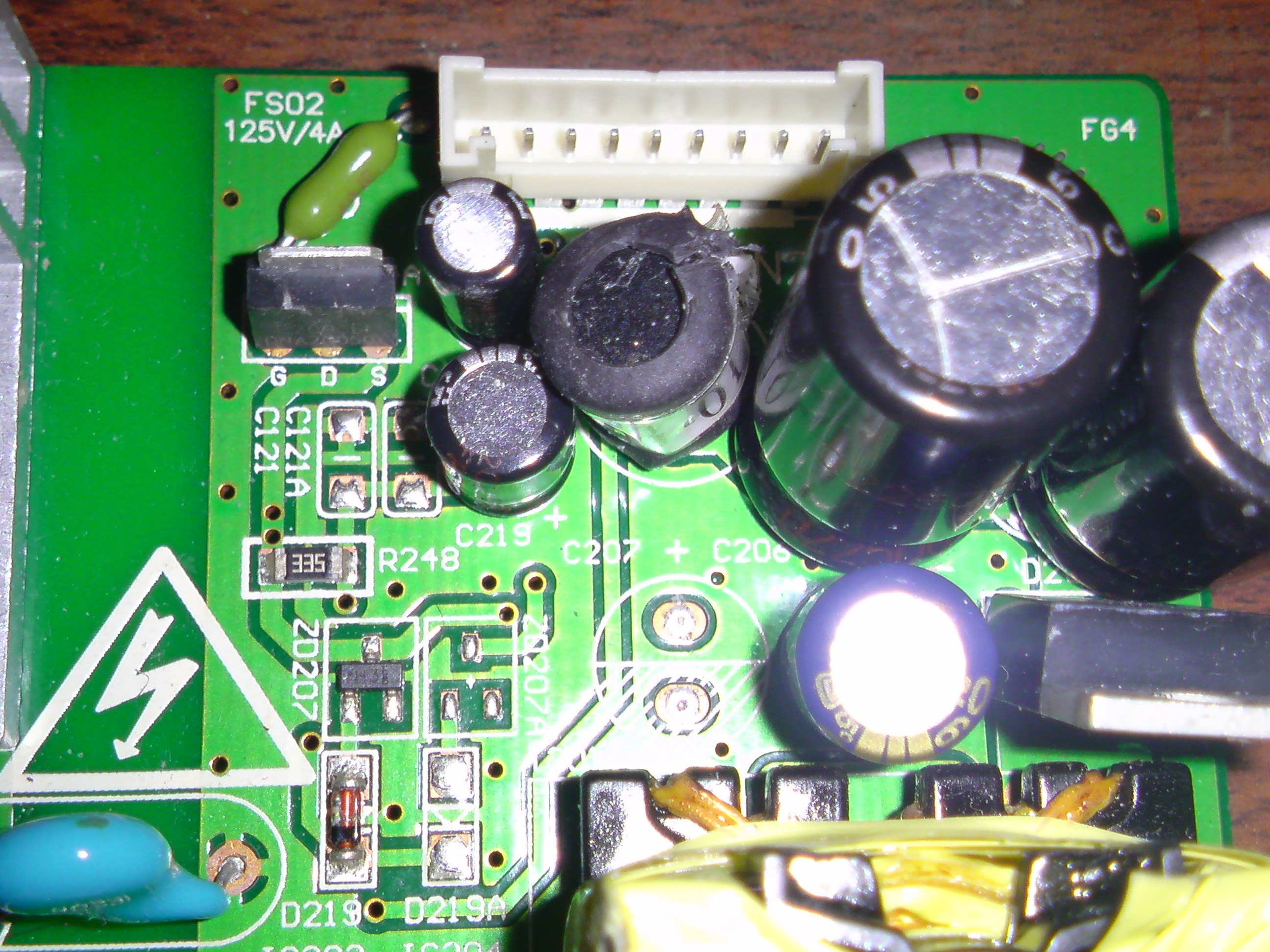

        Originally posted by subarub4
        Are you talking about the short one next to the TO-220? That's a brand new cap btw.
        I am well aware of that LOL
        I want to know if there is a short across it, not the capacitor itself.
        Have you tested that green fuse fs02?
        Muh-soggy-knee
        • subarub4
          • May 2013
          • 77
          #84
          Re: Infocus power supply isssue
          lol ok then just making sure, the fuse is ok and I don't see a short.

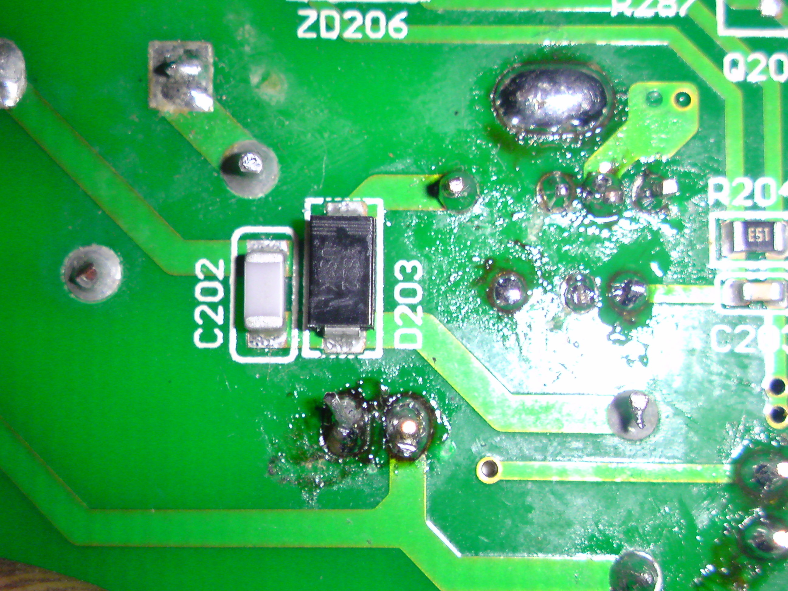

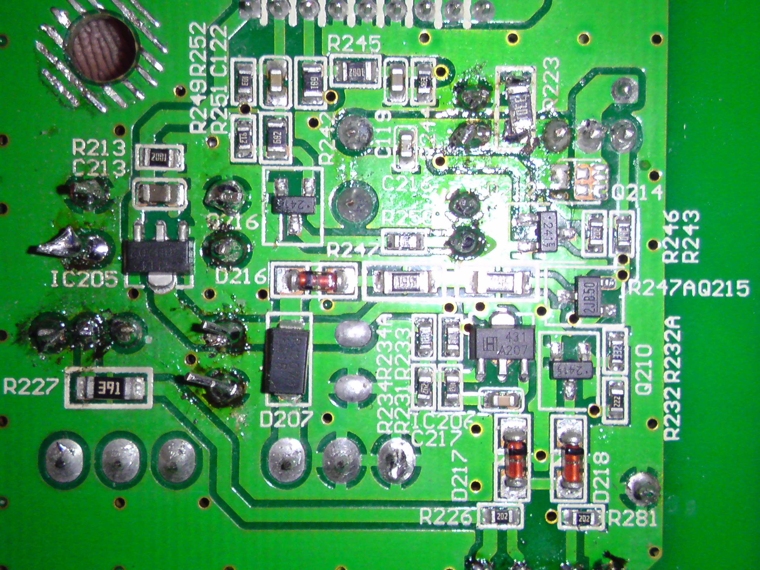

            Could we get some macro shots of the bottom of the board on the secondary side?
            And, on the bottom of the board on the primary side? (Near the mr4010)
            Also, on the top of the primary side? (Again, near the mr4010)
            Muh-soggy-knee
            • subarub4
              • May 2013
              • 77

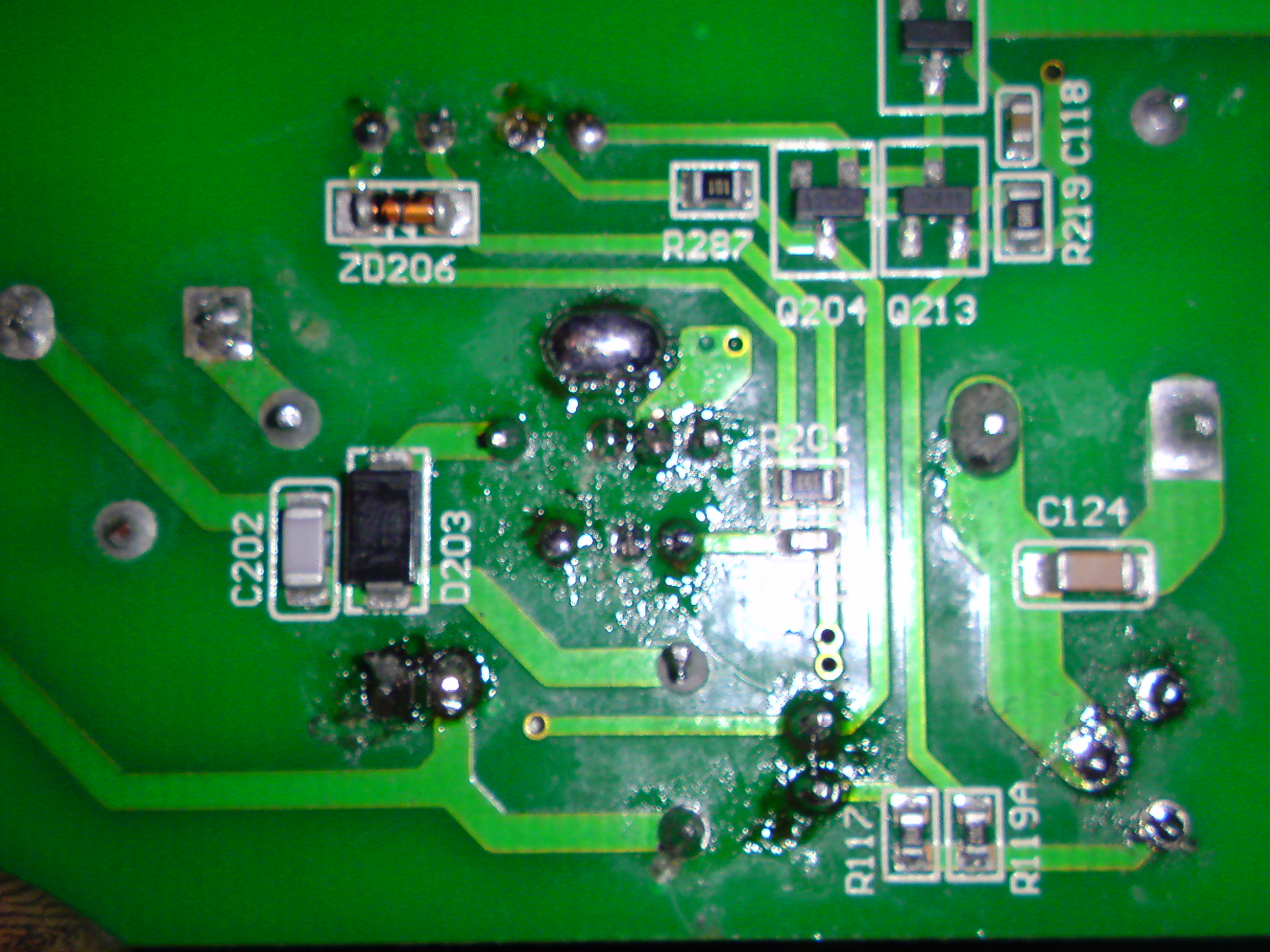

              #86
              underside looks a little rough with all the flux..

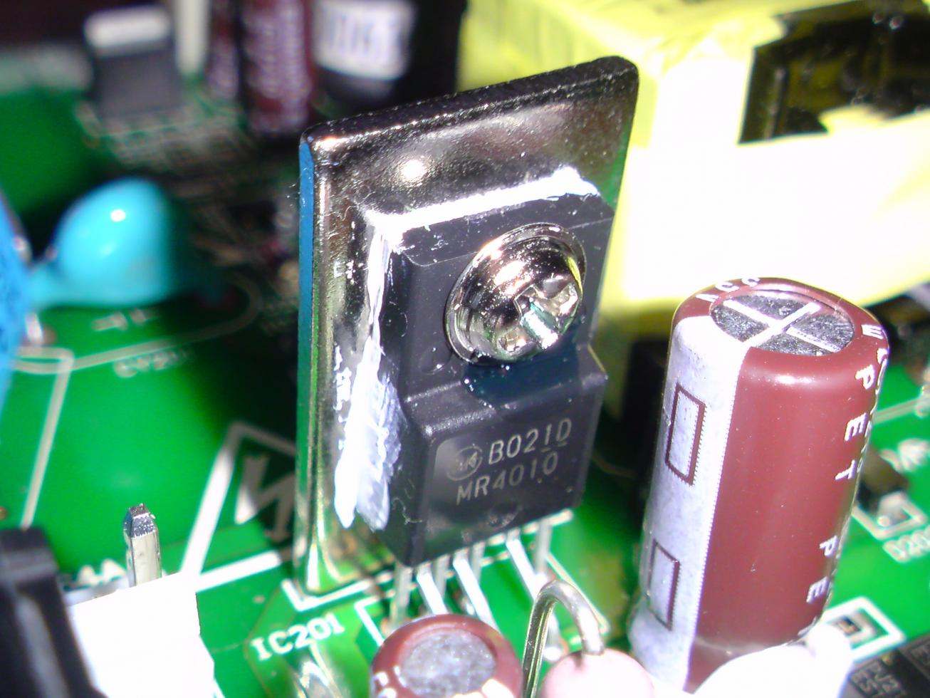

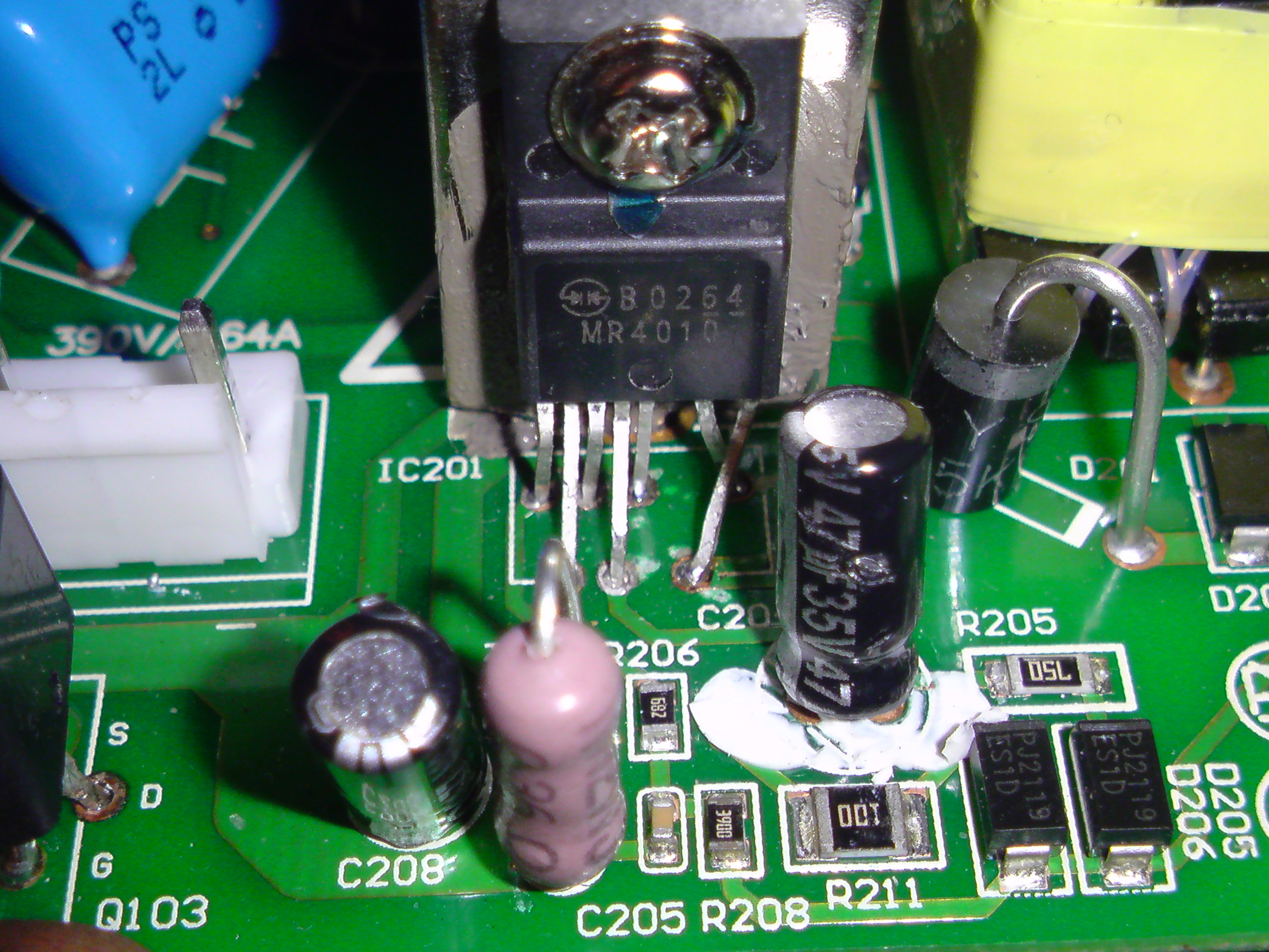

              • Khron
                • Sep 2006
                • 1350
                • Finland
                #87
                Ummmm... Why are the last two legs of the MR4010 "twisted" like that, pray tell?
                Did the original one look like that, as well?
                Edit: Nnnnnnope...
                https://www.badcaps.net/forum/attach...0&d=1368496802
                What you did there, was (most likely) reverse the Source and Drain pins of the FET inside the MR4010 (so basically you're putting the +160Vdc through the Source-Drain parasitic diode, straight to ground). No wonder you blew the fuse...
                Edit 2: Correction - you reversed the Drain with the Vin pin, so you shoved +160v DC into the low-voltage section of the PWM chip. Pins are numbered for a reason, y'know...

                  • subarub4
                    • May 2013
                    • 77
                    #89
                    The pins are not twisted it's just how it is, I did not bend the pins in the same way the original was.
                    And for the info it still gets as hot as the original did.

                      #90
                      What the replacement looked like...
                      and the original with it's machine bent legs..

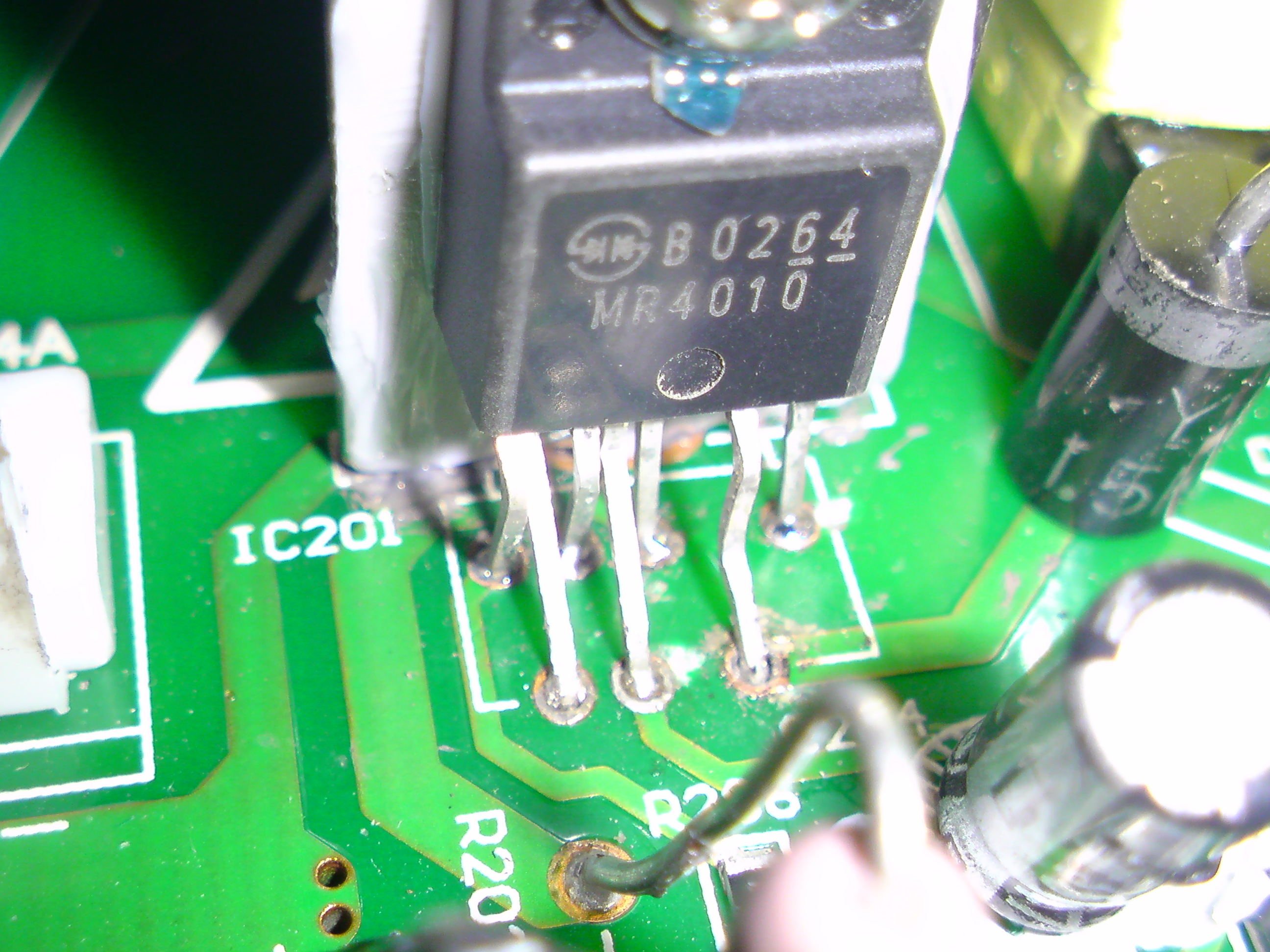

                      • Khron
                        • Sep 2006
                        • 1350
                        • Finland
                        #91
                        The replacement "only" had its pins bent in different directions compared to the original, that's all. The order (and function) of the pins should be the same. By "different directions" i mean front-to-back, *NOT* side-to-side.
                        Quick comparison (original vs replacement):
                        Pin 1 - straight vs. bent backwards
                        Pin 2 - bent forwards, both
                        Pin 3 - straight vs. bent backwards
                        Pin 4 - bent forwards, both
                        Pin 5 - straight vs. bent backwards(?)
                        Pin 6 - cut
                        Pin 7 - bent forwards vs. bent backwards
                        Pin 8 - cut
                        Pin 9 - straight vs. bent forwards
                        Not sure if you've noticed, but these multi-pin SIP (Single In-line Package) solutions, where the pins are bent, they're bent *ONLY* along the forward-backward plane, and *NEVER* from side to side. What you did was simply reverse where pins 7 and 9 go in the circuit, and, well...
                        Quite likely, 1) you toasted the new MR4010, and 2) less likely, caused further damage in the primary "half" of the power supply.
                        "Assumption is the mother of all f**k-ups" - you'll have to excuse the harsh language, but i've seen that adage proven true time and time again
                        Edit:
                        The original doesn't seem to have its legs crossed, as opposed to the new one: https://www.badcaps.net/forum/attach...7&d=1369707694

                          So I want to ask you when I do it your way (throwing out the way Infocus did it) and it blows then what do I do? Why do you think I brought two of them
                          btw I had the same voltages as I did before with the original.
                          • ben7
                            Capaholic
                            • Jan 2011
                            • 4059
                            #93
                            This time, please show us the chip before you plug it in, so we can tell you if it is soldered in the right way.
