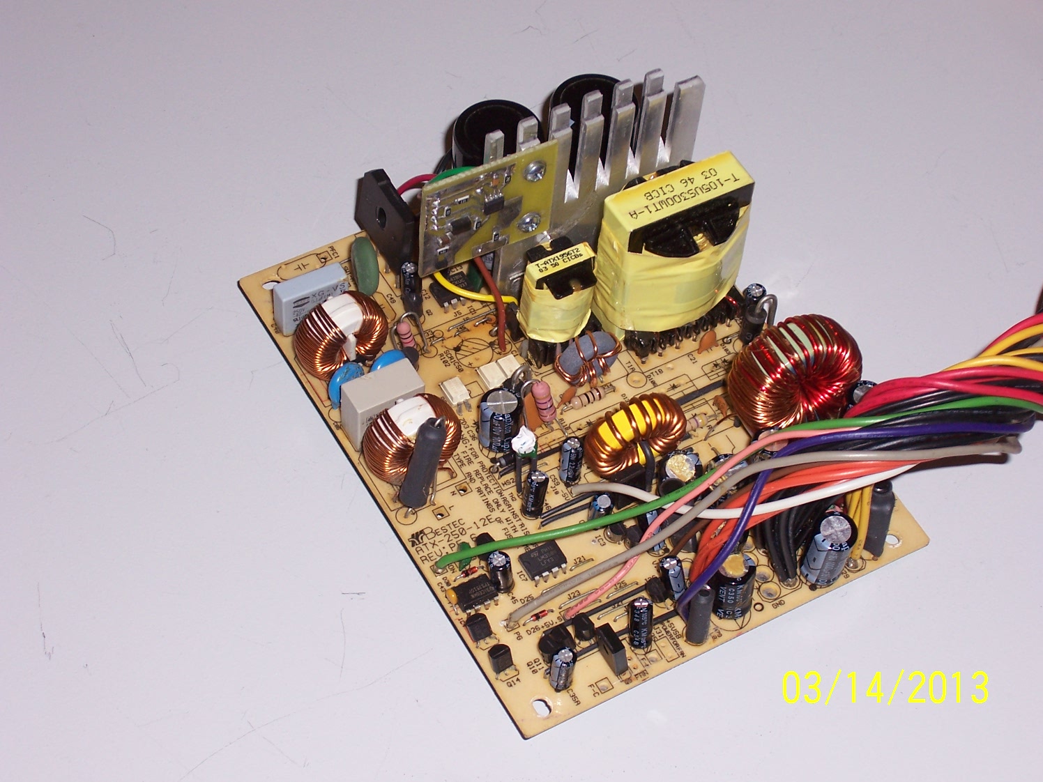

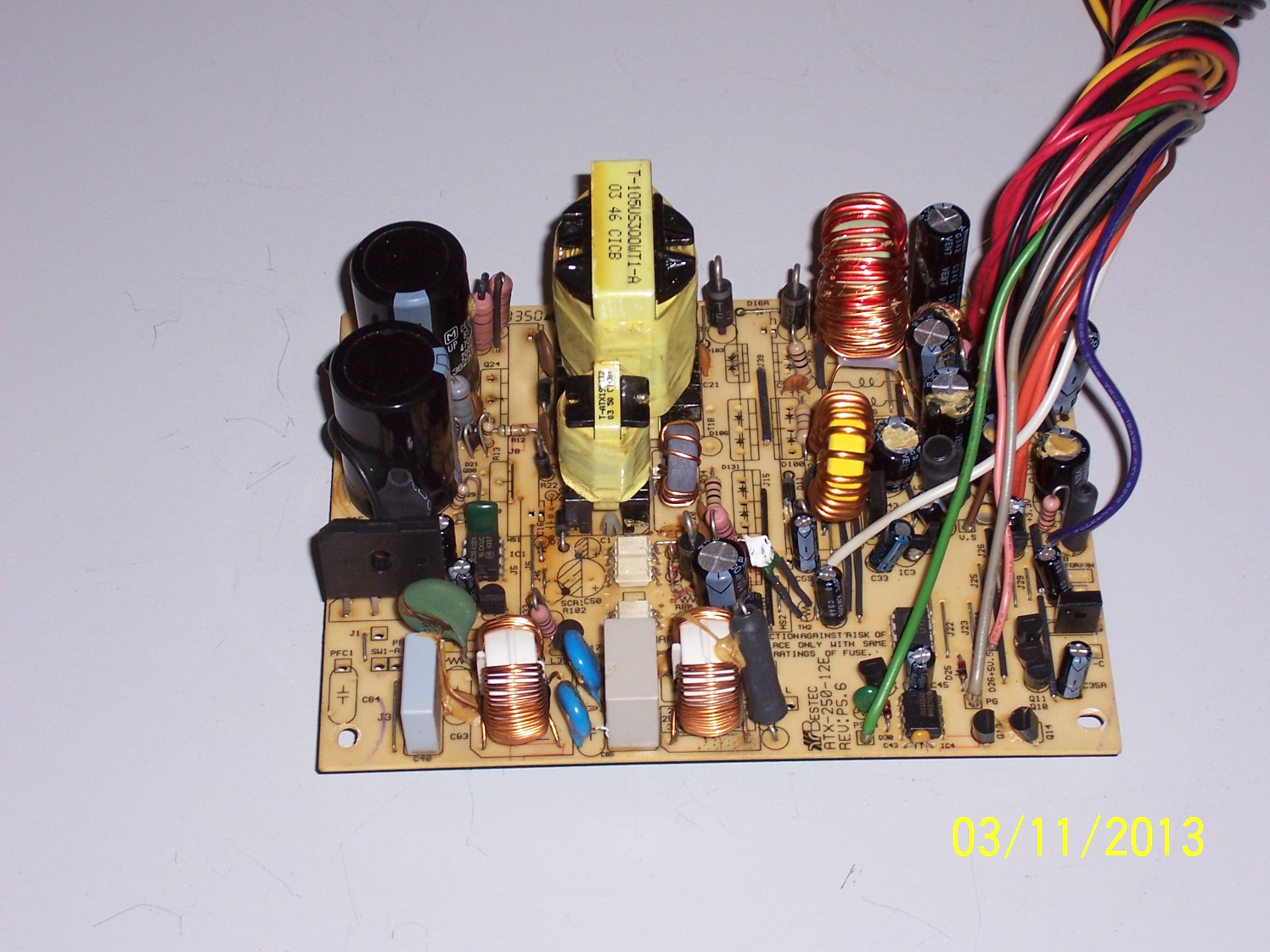

I have been wanting to try building a super 5vsb mod which will do 5 amps or so output (and survive!). I figured what better psu to use than the motherboard killer Bestec ATX-250 12E. Found one cheap on ebay, so here we go. First step is to remove both heat sinks and clean all that resistive glue off the pc board. So here is what it looks like stripped down.
Super 5vsb mod for Bestec ATX-250 12E
Re: Super 5vsb mod for Bestec ATX-250 12E
Next step was to gut the old 5vsb parts from the pc board, make the replacement mod board using the NCP1216 pwm chip, attach the mod board to the heat sink, and reinstall the heat sink. My thanks to ldsishere for helping by making the pc board for this project. The original 5vsb power transistor which was attached to the heat sink was replaced with a power FET 20N60. I figured it would probably handle any amount of current this circuit could throw at it! Besides, it was a part out of my junk box.Old proverb say.........If you shoot at nothing, you will hit nothing (George Henry 10-14-11) -
According to the data sheets, the NCP1216 is just an "enhanced" NCP1200 with some better features. They are supposedly pin for pin compatable. So I decided to try the later version chip.Old proverb say.........If you shoot at nothing, you will hit nothing (George Henry 10-14-11)Comment

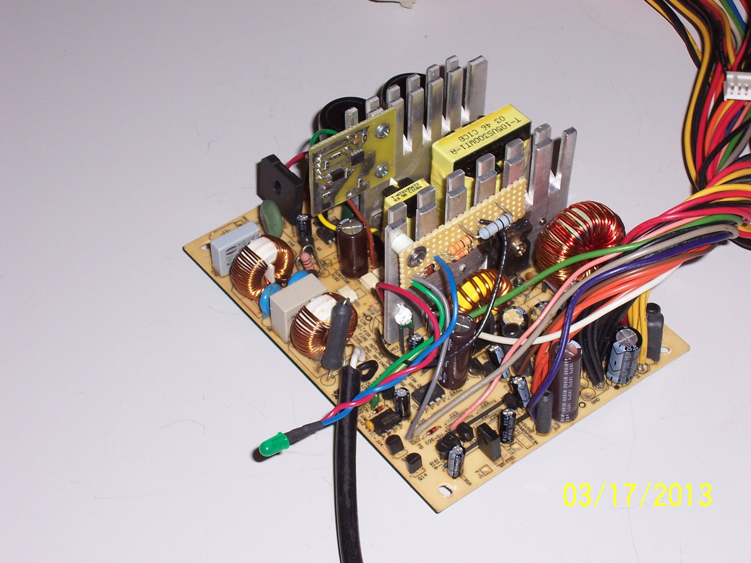

Next step was to build a add-on 5vsb indicator LED. You can see the mod on a small piece of perf board mounted to the other heat sink with all the output diodes. Then I reinstalled this remaining heat sink. This gives me a visual indication when the 5vsb is on.Old proverb say.........If you shoot at nothing, you will hit nothing (George Henry 10-14-11)Comment
That is awesome everell, thanks for sharing it looks greatKeep us updated! this is probably a stupid question....how come you left those 3 optocouplers, aren't those part of the 5VSB circuit? or are those used for the voltage regulation on the output rectifiers?

Looks like it can do just about 5A before the 5VSB voltage goes out of spec on the lower limit (4.75V). Very impressive mod!
I think you just may have reached the limits of the 5VSB transformer. 5A at 4.74V is nearly 24W! I'm sure Th3_uN1Qu3 has a better idea than me of how much that transformer can handle, though.Comment
After doing some high tech troubleshooting (probing with the DVM ohmeter) I determined that the diode in the 5vsb output circuit was shorted. I removed it for identification. It is a SB340. That means it is a shottkey barrier diode rated for 3 amps at 40 volts. Considering it reached about 6 amps before shorting, I would say it was a pretty good diode! I ordered some SB540 from Digikey, and the power supply is now back in operation with the same output voltage measurements. I ordered SB540 made by Vishay because it had the least amount of forward voltage in their specification. The lower the forward voltage the less the heat.
Lesson learned: If you are redesigning the 5vsb to do 5 amps or so, need to change the diode to one rated for that much current.

everell, an 8A or 10A rectifier would be a better choice, unless this is more an experiment than something you want to use for an extended time. Using parts at their full rated current is not a good idea unless you have really great heatsinking and a decent amount of cooling air. An 8A or 10A schottky will also have a lower V(f), resulting in better efficiency.
Another thing to look at, if you have an oscilloscope available to you, is the gate drive to your MOSFET. While it should have a nice, low, R(D-S On), you need to be sure it is turning on and off quickly. High current MOSFETs often have very high gate capacitance, resulting in either relatively high drive currents when being switched or relatively slow switching if the available gate drive current is too low. I'm not suggesting you have a problem, only saying it's something to look at as a sanity check.PeteS in CA
