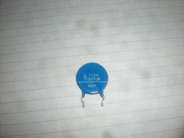

    Hi Guys,
    I am trying to repair an APC BK500M UPS unit. One of the MOVs was completely toasted, and I am trying to find a suitable replacement. I have attached a photograph of one of the good ones. It appears to be a 150V MOV made by Siemens. I did find a datasheet for it, but it is in German, and I can't read German (Spanish and French, but not German). Any help in finding a suitable replacement would be very much appreciated. I've managed to identify all other burned components, this is the last part I need help in identifying.
    Thanks,
    Justin

    Re: Help in finding replacement part
    May have helped if you gave the link you have -save our time looking it up!
    150 is max acv 18 is nominal diameter if it will fit a s20k150 should do
    http://www.digikey.co.uk/product-det...1416-ND/593850
      Thank you, if I had known it would have helped, I would have posted the datasheet, in the future I will do so. But, thanks for pointing me in the right direction with this part.
