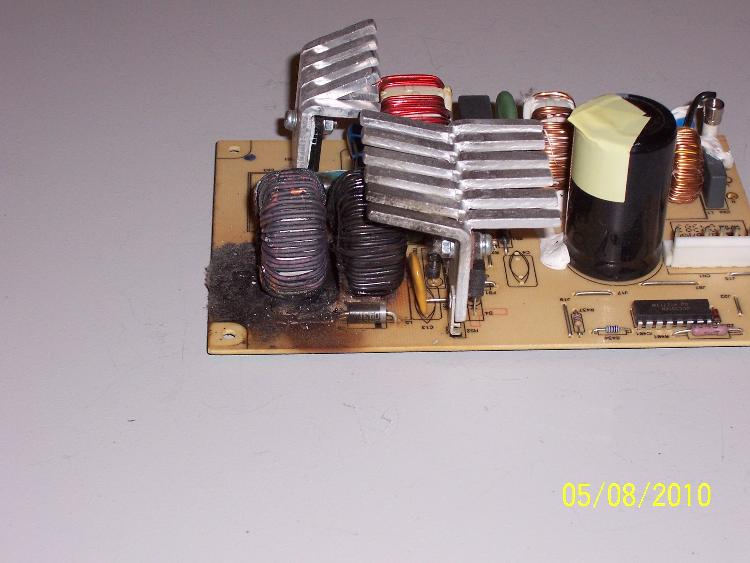

                    What brand and model. Need some pictures. Booster coil running too hot then causing FET to short is not an unusual problem. My OPINION,,,,the core material used is cheapo, the wire may be undersized, and you are expecting too much from what is there.
                    Old proverb say.........If you shoot at nothing, you will hit nothing (George Henry 10-14-11)

                        Every APFC circuit I have fixed had burnt coil and shorted FET switchers. Replacing the FET transistors did not solve the problem as the new FET transistors shorted.
                        The coil always showed some signs of being burnt, and the short was always near where the coil wire was soldered to the pc board. Measuring with an ohmmeter or DVM is useless because you can't distinguish between low resistance reading and shorted coil. BUT.....I purchased a Ring Tester....and without taking the coil out of the circuit, a shorted coil indicates short whereas a good coil has a good ring.

                          The dc resistance of the coil is low, so when the mosfet would short, there would be a large current in the coil. So large that the fuse will blow before the coil will even get hot.

                              Here is a picture of two APFC coils in series in a Delta power supply. They were definitely burned, probably shorted. I tried winding new coils, but they also ran very hot. I was using cores from junked out psu's, so the core quality was probably very poor. I ended up completely replacing them with commercially made "booster coils". Still runs hot but has not burned up. I think there is not enough engineering done on these booster coils for long term service. Just get it out the door and sold. Then worry about heat problems later.
