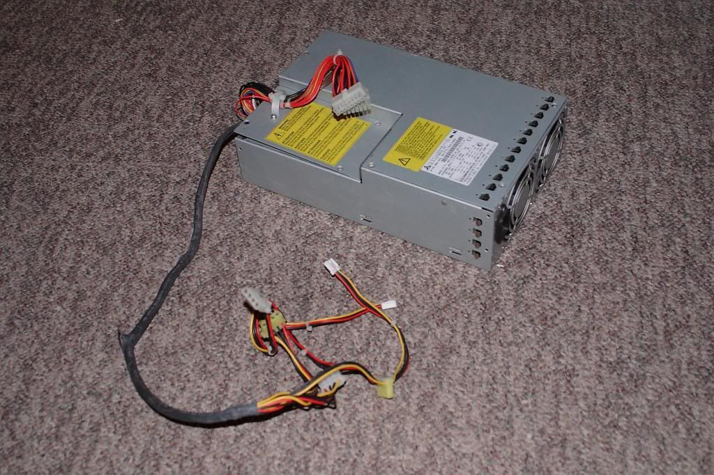

          Can you post some good pictures of the supply? Also what are the exact voltages it is putting out on 5vsb, 12V, 5V and 3.3V lines?

            Here's your pics.
            As said, the PSU is doing something. The system controller comes up however the instant the system is expected to turn on it dies and resets as if it switches over to another voltage rail which has not come up.
            +5sb is 5.11v
            +12, +5 and +3.3v are dead, which make sense because the PSU isn't on.

              Re: Delta/HP PSU 3.3v short
              I noticed in your first post that grounding PS_ON would not start the supply. Would it twitch the fans at all?
              If yes, then I would check the voltage on each rail while grounding the PS_ON wire. If you have a Fluke meter with a Min/Max function this would be a good time to use Max.
              The next step would be to identify the supervisor IC. This should be the chip that is giving you the PS_ON voltage, this chip should also be connected to the Power Good wire which is normally grey.
              The idea is to see if the supervisor chip is sending a signal to the primary side to start up. Determining this should allow you to tell if you problem lies on the primary side or secondary side and where you should focus your attention.
              Out of curiosity how old is this computer? The date code on the supply reads 9851. Could that possibly be the 51st week of 1998?
                It's a dual PIII Xeon system so it is in that timeframe.
                To make the fans twitch, first you must short ON/OFF to ground, then you have to short the FANS lead. It has to be done in that order or else nothing happens.
