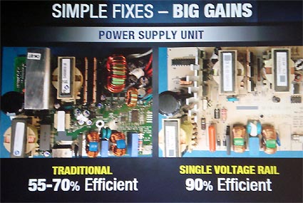

        I have these slides from the IDF.
        This is in regards to Google bitching about their servers costing so much to power.
        A single rail PSU would be more efficient in size and easier to cool because of this, and it is possible to make it more energy efficient, but while components are still requiring different voltages, additional DC to DC "point of power" converters will be needed.
        So let's say you make a single 12V rail PSU and it's 85% to 90% efficient. You're still going to need to regulate voltage down to 3.3V for RAM, 5V for logic, etc. So we use mini point of power DC to DC power supplies. These can be 90% to 95% efficient. 90% of 90% is 81%. You're now LESS efficient than you were with a single multi-rail PSU.
        I do agree with them on UPS's. Especially the Online UPS's that they use in the Google server farm and illustrate in one of the slides from the IDF. You're converting AC to DC to AC and then go to the PSU where you're converting back to DC. Why not just make the UPS AC to DC and then use a DC to DC power supply in the PC? Wouldn't that makes more sense????
              That is the key, then. Lets's have some regulator/vrm for those two lower voltages on the motherboard, like the old days (when psu didn't have 3.3v yet).
              How much is the efficiency on usual cpu vrm on motherboards? (12v -> ~1.5v)
                  Still not 100%. Around 90 to 95%. That's going to add up and you're over all efficiency is only going to be 80 to 85%.
