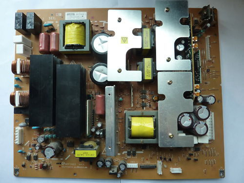

    Hi, thought I'd post my problem in here on the off chance someone can help. I been trying figure out why my TV makes a clicking noise under load (when brightness and colour etc are turned up) it doesn't do this when all setting are low.
    I've figure out the clicking is (I think) coming from inductor I think that's what it's called, biggish component 4cmx4cm with coils rapped around something.
    I've got some answers on this, one chap reckons I should replace 2 caps and resolder some connections, there's the thread if any ones interested:http://www.tv.quuq.org/forum/index.php?topic=6669.0
    Any thoughts on this before I try to fix it.
    Thanks Jon.

          No this is def the PSU board, it's not a whining or buzzing noise more a fast clicking that speeds up when load it put through the PSU. (turning brightness to full).
          If a grip the inductor it dampens the noise, I could be mistaking a whining noise for a clicking noise but to be honest its much more clicky then whinny.

            Might be internal arcing then - difficult to fix...

                        Did you try the superglue? shouldnt do any harm even if it doesnt work.
                        Are there any numbers on the inductor - how about a close up picture then we can all look.

                          Hay , will try the super clue today, my camera's out of action, here's one of the hole board, the noisy inductor is top left near the 2 big caps.
                          I've had a good look at it (haven't taken it out of the board) not shore weather taking it out will help?seems to look all right.
                          The only number on it is 1v001 E3YR have no idea what that means (some sort of voltage maybe).
                          Would a close up picture help more.
                          This super glue idea, should I remove the yellow tape to get to the coils or remove the inductor to get better access.
                          The help is appreciated at least I'm getting somewhere.

                            Well the super glue didn't help, what are my chances of finding a replacement. I have been looking but like tom said could be impossible but I must try.
                            I'm going to look into fixing the arcing but again this might proof very hard.
                            Any more tips before I junk it.
                              Re: Faulty MPF7409 PSU from Hitachi pd5200 plasma.
                              This PSU is cross compatible with a lot of other LG power supplies, maybe you could sub it for one of those...

                                  Hmm. Possibly, it could be an unstable PFC circuit producing the sounds. You can get some new caps here: http://uk.farnell.com/panasonic/eetu...00v/dp/1198679
                                  Check what the original capacitors were - brand and series - so an exact match can be found.

                                        Regarding the caps this is every thing written on it:
                                        (M)
                                        HC CE(M)
                                        105 C
                                        270UF
                                        400V
                                        Japan
                                        Would the one you linked me to do the job, the only difference is the max temp is slightly lower 85 c as for all the other value's I have no idea.
