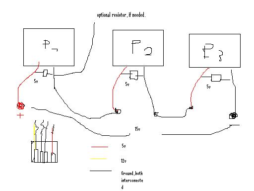

    Connect 3 psu's in series?
    Well I bought an 80w 16.1vmax peltier to see how effective they are at cooling the air in a case (ala Channel Well IceCube psu or Sytrin Nextherm case) and the answer is erm not very well...at 12ish volts. I don't want to buy a 16vDC power supply for something i may not even use, but i do have 3 working ATX psu's and I was wondering if i can connect the 5v outputs in series for a 15v source? If so, can someone explain in layman terms or diagram how to do this? How would I disconnect/connect the grounds is the part i'm most uncomfortable with. Thanks in advance.

            Theoretically you can couple those 3 psu`s, as the outputs are galvanically isolated. But i duno if this will do like with linear psu`S.
            In any way, it is up to you to try that .
            To contect some PSU`S in series, you have to conect the black wire from PSU 1 to the red wire of psu 2 and the black of psu2 to the red wire of psu3.
            Between RED on PSu1 and Black on PSU3 you should messure the added voltages e.g between 13,5 and 15,5v. But keep in mind that you need for many psu`S some minimal ballast that they can operate properly. May be you should ensure that with 3 power resistors or some light bulbs for every psu (betwen the 5v o/P and the corosponding black - wire).
            IOn any way. as stated abovve, i duno if the regulation of thos smps psu'S can handle that kind of operation or if they are afeckted from it. In theory i think it should work.
            EDIT: some crude getto style drawing.

                  • gonzo0815
                    • Feb 2006
                    • 1600
                    Re: Connect 3 psu's in series?
                    The pwm should theoretically work, as every PSU does only see his own voltage, e.g. the own 5v. Of course, the current and the voltage from the other PSU'S are running through the transfomer of each single psu, but as the input current is equall to the outputcurrent, the regulation shouldn`t be affeckted IMHO (the currents eliminate itself)
                      Look at the drawing, you will see the 5v marking between each geound and 5v o/p of every psu. The molex, conected only to one psu, is in parralel with that marking.

                        • 10
                        yeah it reads 15+v across any 5v lead on PSU1 in the diagram and any ground on PSU3. I didn't have to add any resistors since they all put out over 5v just powered on alone but PSU2 is an old Astec AT style and it wouldn't power up without a load and attaching an old cd-rom drive worked.
                        I thought that I'd have to insulate the common ground on like 2 of them but apparently not or maybe I got lucky and they aren't wired that way.
