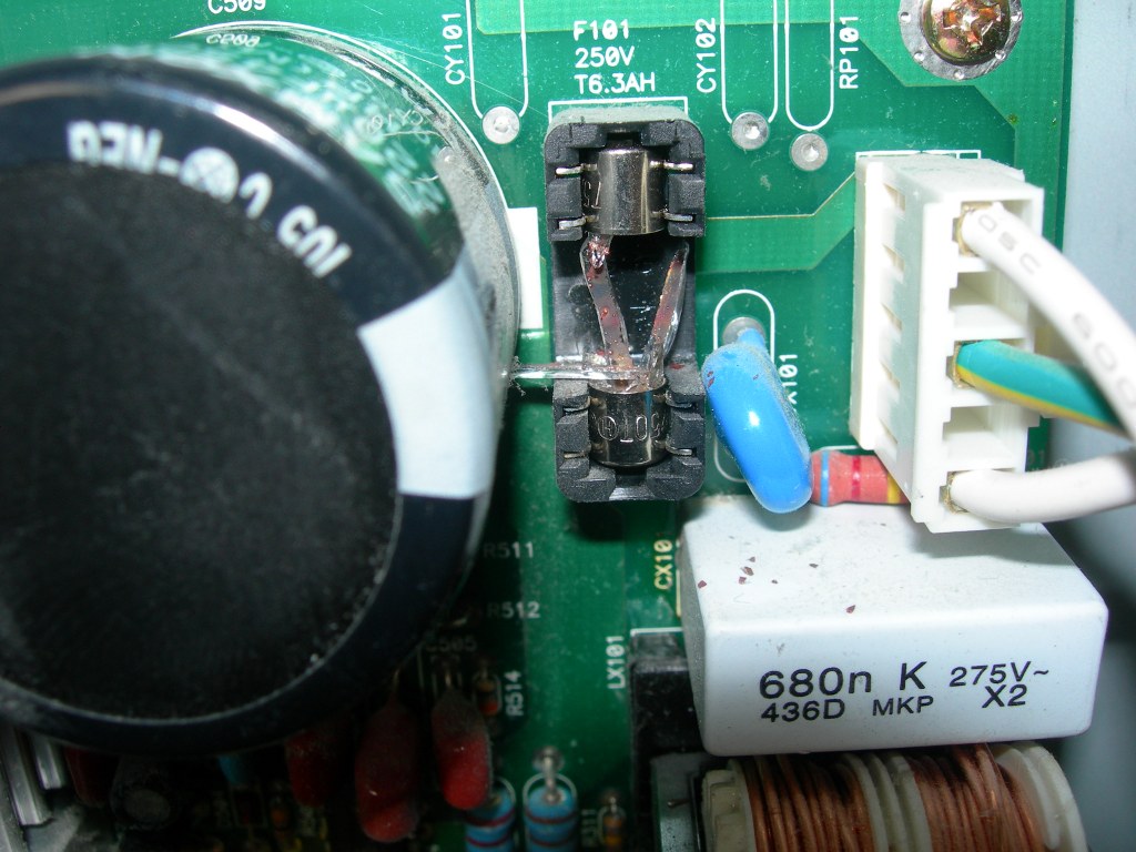

    Yesterday i was making the finishing touches on my +/-35v and +/-20v 600W unregulated SMPS for audio amps, as the amps will be put into full service starting tomorrow.
    The PSU is a heavily modified ATX supply with 120mm fan (used to be a 430W Spire based on the AT-2005B platform), the amps are TDA7294 modules, designed to power bi-amp speakers. Two bridges for the woofers and a stereo module for the tweets. A pair of 10000u 50v caps in series in the PSU secondary and another pair on each module. Total of 40000uF at 70 volts, enough that short circuit protection is basically pointless, as it will vaporize 18AWG wire.
    I wired everything up and hit the switch. Nothing. Took the PSU apart, and... not again. Primary transistors shorted b-e due to the current surge at power up (the PSU topology remained the same, half bridge with proportional base drive, and the base current at startup was too high and took out the transistors).
    I messed with the base resistors a little but this was clearly not the way to go as it affected efficiency too much. A proper soft start needed. So i turned the PSU off by the switch to put in the original base resistors (4.7 ohm) but forgot to unplug it. As i was unscrewing the board the screwdriver touched something and... BANG. Turns out the circuit was live.
    Damage:
    One of the primary transistors shattered, the other cracked in half. The one that shattered blew away a cap in the base drive circuit too.
    One MOV obliterated, blew away one of the primary bleeder resistors as well.
    NTC cracked.
    One of the diodes in the bridge (4A) shorted.
    And my left ear felt like it just received a flashbang.
    As i later found out the TL494 was gone too, not sure why as everything else in the secondary was fine.
    Obviously, a short of this magnitude popped the main breaker too. However, the fuse in the PSU stayed put. Now it makes sense why - the fuse ended up on the neutral and this was a live to earth short.
    One day's work later, PSU is fully operational and with proper soft start. Added a second NTC after the primary caps just in case. The fan in the PSU (thermally controlled 0-100% 30-70C based on primary heatsink temp) spins at like 1000rpm with the amps burning up. All in all, working great.
    I have to begin designing my own boards, these ATX mod jobs end up too much of a hack even for me.

        I wasn't so lucky. Powered up this TV with a shorted bridge rectifier. The fuse made a very nice pop and sent flying glass across the room. It tripped the main breaker too.
        I initially thought, "it's a glass fuse, they don't have great current interruption ratings."
        But I put in another glass fuse removed from another TV (so known to be safety certified) and it didn't shatter when it failed (a mistake of mine, I had a solder bridge between pins I didn't adequately clear.)
        I guess it was a counterfeit/fake fuse, sold by Maplin. Can't trust anything retail these days, it seems.

          Lesson learned: ALWAYS use double-pole mains switches, especially in countries with non-polarised sockets.
            Or just unplug the darn thing.
