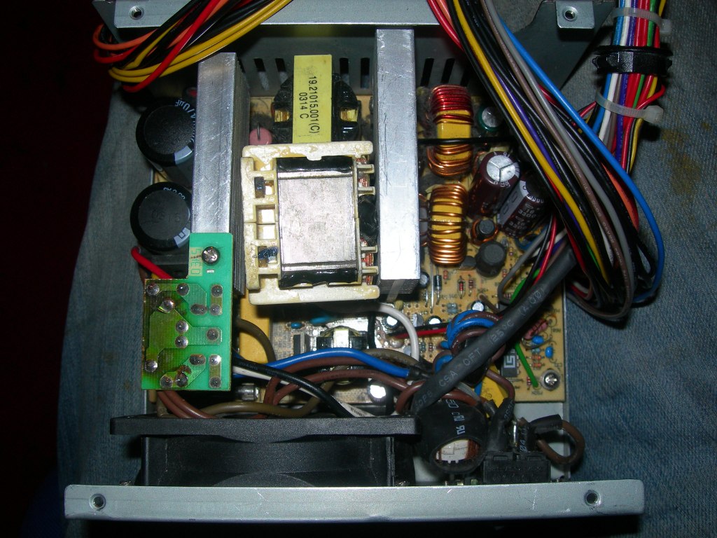

    Found this PSU in the junk pile.
    Plugged it in, 5VSB measured ~1.8V and rails were dead when the paper clip power on was used. Checked with scope - nice 50kHz ripple from 1V to 4V on 5VSB.
    Pulled the case open and unsurprisingly found a three bulged Teapos. One on 5VSB and two on the 3.3V.

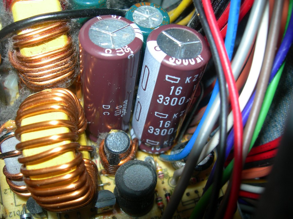

    Checked the 5VSB cap (470u 16V) for ESR - about 3 ohms. Replaced that (Panasonic FC - 680u 16V), as well as some other caps. The output LC cap for 5VSB measured >20 ohms & leaky, so replaced that with a Rubycon ZLH 1000u 16V. (Originally a pathetic 100u.) Checked power for PWM controller - 100u 35V, replaced with Chemicon KMG 100u 50V. (Checked this cap later on ESR meter - measured 0.5 ohms, probably out of spec.) Checked the 3.3V caps (2200u 6.3V) - both had ESR about 5 ohms(!) Replaced them with Chemicon KZE 3300u 16V.

    All these caps I had lying around as spares left over from TV repairs. PSU now works 5.2Vstby, but still main rails don't fire up.

    It's actually got a decent passive PFC choke, a proper EMI filter (two coils, 3 X caps and some Y caps) and a real bridge rectifier. 470u 200V primaries, better that most but still a bit lackluster (should really be 680u+.) I think it's a 250W model.

    The PSU looks alright, but I do see a lot of discolouration on the PPFC PCB.
    I'm not exatly sure what's going on with the main rails though.

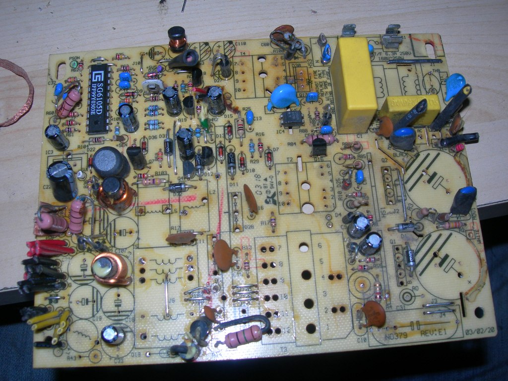

      Okay, I think I found the problem. One of the output diodes is shorted (0.009V both ways.) This probably makes it uneconomical to repair for myself when there are 10 more where this one came from. Still, parts will not go to waste including the transformer, EMI filter and remaining good diodes, and I'll salvage my caps.

        Everything useful or big stripped...
        Wick works wonders here.

          Wow! Look at the discolouration near the 5vsb transformer.

            Yeah, I'm guessing it failed because someone was trying to charge their phone off the USB or something like that in standby.
