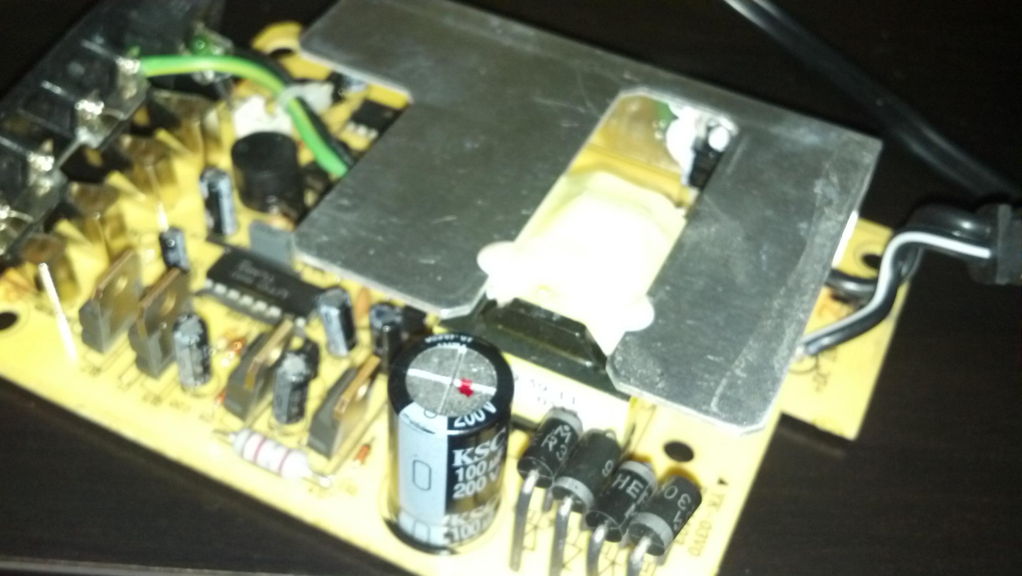

Newbie. Capacitor in an inverter?
  • gcretro
    • Mar 2012
    • 5
    I have a car inverter, 200W. Brand is some power line. Last time I plugged it in, something inside it "popped" with a beeep and slight foul smell.
    So I opened it and found a capacitor bulging almost burst. It's 3300UF 16V 105 deg C. [Black in color and says E&K vent. I wanted to attempt swamping this to see if that was the issue.
    Any idea where I could buy such a cap? And what brand should I buy? In ebay I found many brands Tecpo, Panasonic, Sanyo.
    [Some are not black in color if that matters]
    Any directions?
    Thx

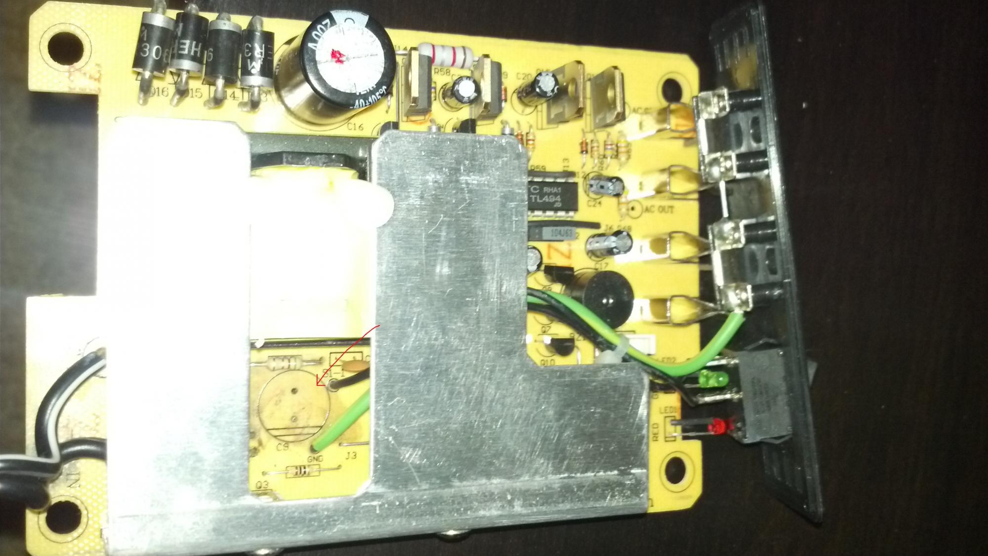

          Re: Newbie. Capacitor in an inverter?
          Attached are 2 Pics. Red arrow shows the busted cap I removed. I misplaced the busted cap. But it was 3300UF, 16v 105C, E&K brand.
          So what brand should I buy? I found the digi-key search overwhelming for a newbie. Anything up to 6 to 8 bucks is ok.
          Thx again
            To me personally, everything looks good in the pictures, nothing obviously bad there.
                        Originally posted by dmill89
                        I can't find any data sheets on EK capacitors
                        Where is this bulging capacitor? The photos don't show a bulging capacitor nor a capacitor marked "E&K"
                        All I see is one marked "KSC" which I'm thinking might be from here? : http://www.king-sun.com
                          He has removed it - there is a thin red arrow in the first picture pointing to where I presume it was.
                            Ahh right you are. The arrow is very thin, and it's easy to miss a hole when you're not looking for one!
