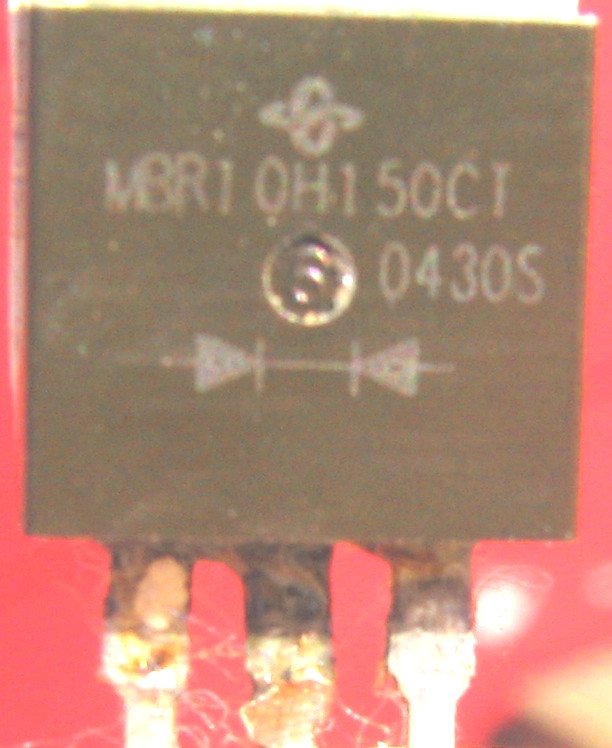

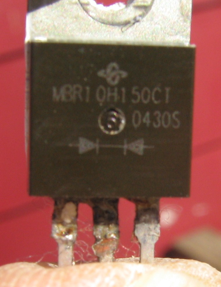

    Need help finding replacement part. Have searched online thru google,Mouser, & Diti-key but had no luck matching part. Can someone help with replacement?
    Part may read: MBRI CHI 50CT 0430S. From a power supply board board for a LCD display. Getting hard to read this small print.
    Thanks for any help.

    could it be one of these? http://search.digikey.com/scripts/Dk...ords=mbr10h150

      Thanks for quick response. That may be a good replacement. Part number a little diff. but may be an updated part.
      Looked again, not in stock at Diti-key,bummer.

        Maybe this 1 will work? MBR20H150CT

          Who says they are not in stock? If you just click on the link it says they have 9960ish in stock? You could give them a call and ask if it is a replacement
          I will attach the data sheet - the E3 suffix for consumer grade, it says- not sure about the other numbers

            Looks like you're right about quantity in stock. Guess I got web twisted some at website. Thanks
