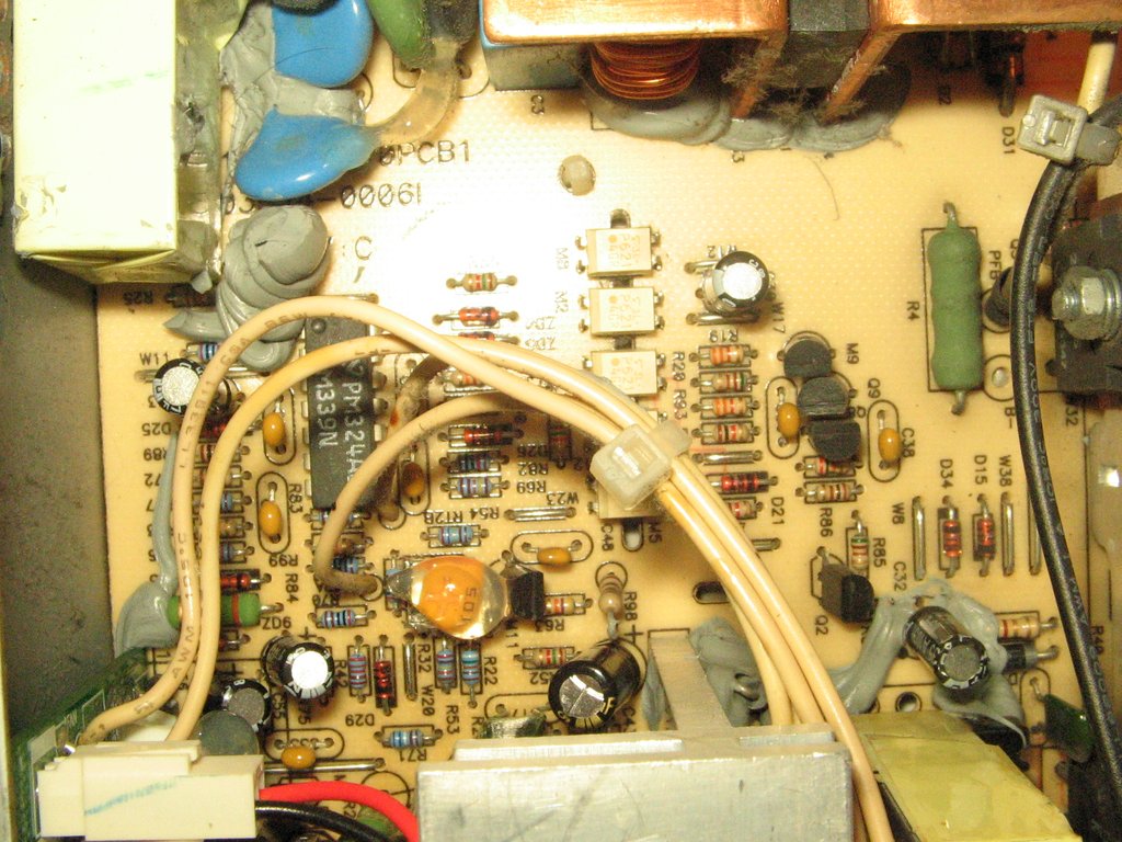

    Got around to pulling the PSU from my old MDD G4 Mac
    It's an AcBel API1PC36 Rev. B which is nice because it doesn't have the CapXon HP problem (or the heatsink in the way, luckily!)
    It seems mine has gone similarly down the same path as the one severach posted about here: https://www.badcaps.net/forum/showthread.php?t=13985
    That is, that C60 is bulged but nothing else (yet). And the Mac still starts most of the time. Not sure if the brands\values match his Rev. A model but I guess we will find out.
    In any case, looking in that and other threads, it seems that the smaller capacitors might give issues too, so I'm thinking it sounds a good idea to just replace most everything, including them?
    Also, what about the ones on the little daughter-boards?

                    Started on the removal today, removed all the big capacitors and tested them so far.
                    All had low ESR except the bulged C60.
                    The brands lineup is a bit different to the Rev A. version in the other thread.
                    Code:
                    C8 = 	47uF	25V LTEC 	TK SERIES 	4101D			1.00 ESR
                    C7 = 	220uF	35V LTEC 	LZG SERIES 	3O01D			0.08 ESR
                    C10 =	2200uF	16V TEAPO	SC SERIES 	12/03 A3		0.02 ESR
                    C13 =	2700uF	6.3V RUBYCON	YXG SERIES 	S0326 			0.02 ESR
                    C16 =	2200uF	6.3V TEAPO	SC SERIES 	10/03 A3		0.02 ESR
                    C29 =	2200uF	6.3V TEAPO	SC SERIES 	10/03 A3 (RED MARK)	0.02 ESR
                    C21 =	3300uF	10V TEAPO	SC SERIES 	10/03 A3		0.01 ESR
                    C60 =	1000uF	10V TEAPO	SC SERIES 	12/03 A3		2.70 ESR
                    C59 =	1000uF	10V RUBYCON	YXG SERIES 	T0341			0.04 ESR
                    C35 =	470uF	35V UCC 	KY SERIES 	3(7) NC			0.03 ESR
                    C41 =	680uF	35V LTEC	LZG SERIES	3D03D			0.04 ESR
                    C43 =	100uF	25V TEAPO	SEK SERIES	12/03 A3		0.51 ESR
                    I'm guessing the Rubycons and the UCC should be good to keep.
                    Teapo is probably useless but what about the Ltec?
                    Haven't looked at the smaller capacitors yet but after taking another look at severach's post I notice he did do some replacements on the daughterboards so perhaps it would be a good idea in fact to do that too?
                    Also, the smaller ones seem to be mostly Ltec TK. There are no ESR values in the datasheet. I assume I can use any General Purpose series from a decent brand?
                    -David VanHorn

                              In my AcBel the primaries are a trio of Rubycon AXW.
                              Pulled the rest of the capacitors this afternoon.
                              The following list is a continuation of the first, the capacitors on the main board:
                              Code:
                              C57 = 	4.7uf	50V LTEC	TK SERIES 3D01D			2.10 ESR
                              C56 = 	0.47uf	50V LTEC	TK SERIES 3D01D			7.00 ESR
                              C55 = 	0.47uf	50V LTEC	TK SERIES 3D01D			8.10 ESR
                              C53 = 	4.7uf	50V LTEC	TK SERIES 3D01D			2.10 ESR
                              C30 = 	0.47uf	50V LTEC	TK SERIES 3D01D			6.90 ESR
                              C32 = 	47uF	25V LTEC 	TK SERIES 4101D 	 	1.60 ESR
                              C45 = 	10uF	50V TEAPO 	SEK SERIES A3 12/03		3.20 ESR
                              Next list is capacitors from the daughterboards:
                              Code:
                              [B]PCB4 (FAN CONTROLLER?)[/B]
                              C403 = 	10uf	50v LTEC	TK SERIES 3D15D			1.90 ESR
                              C407 = 	10uf	50v LTEC	TK SERIES 3N15D			1.20 ESR
                              C402 = 0.47uf	50v LTEC	TK SERIES 3915D			6.40 ESR
                              C416 =	470uf	16v TEAPO	SC SERIES 11/03 A3		0.04 ESR
                              C405 = 	10uf	50v LTEC	TK SERIES 3D15D  		2.20 ESR
                              C401 =	47uf	50v LTEC	TK SERIES 3D15D			1.10 ESR
                              [B]PCB2 (PWM CONTROLLER?)[/B]
                              C20 = 	3.3uF 	50V UCC? ?? SERIES	15.0 ESR
                              Not sure of the brand of capacitor C20 on PCB2. Logo looks similar to UCC but doesn't appear to have the points on the top, bottom and top corners. There is no apparent series name marked.
                              I'll post a photo if anyone wants one (or might post one anyway!)
                              Now for the fun task of finding replacements... looks like Farnell will be cheaper, but I'll probably have to wait until I get some other stuff lined up to fill the order to the free shipping value.
                              -David VanHorn

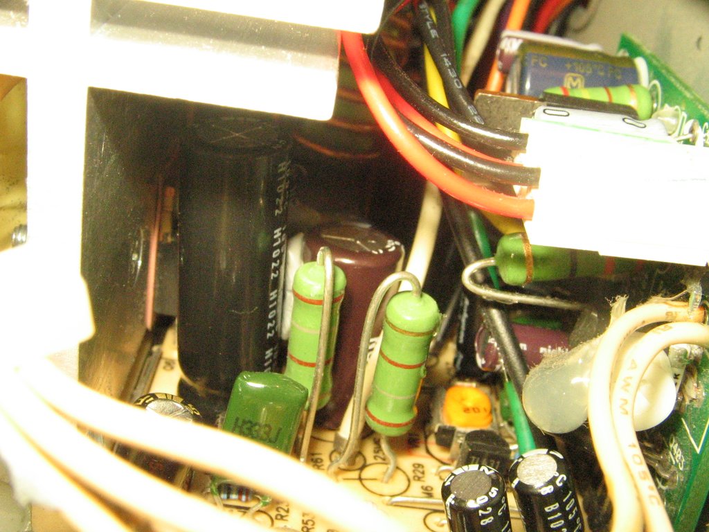

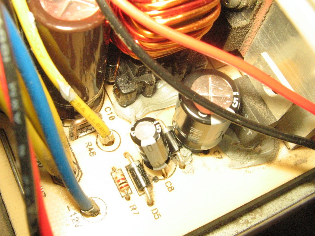

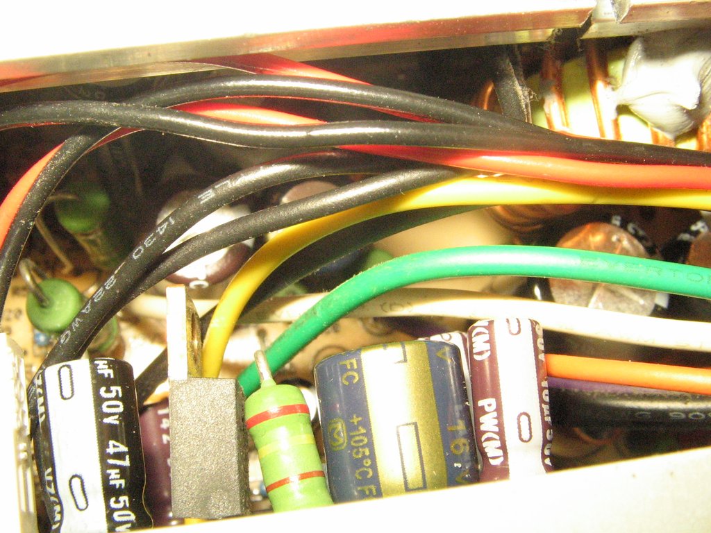

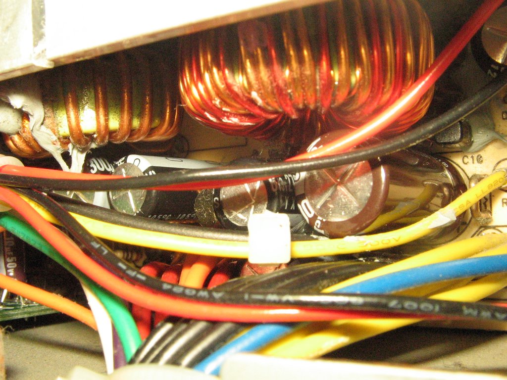

                                    Re: Apple MDD G4 PSU (AcBel API1PC36) - Recap question
                                    Did the replacement a couple of days ago. All seems good now - haven't had boot failure with a blank screen and roaring fan since.
                                    Some photos attached
                                    Will try to get around to listing what I used for replacements if anyone wants to know... (Mostly Nichicon, and a couple Rubycon and Panasonic) Used what I had left over from other things and then ordered what I didn't have. Left the good brand capacitors in.
                                    -David VanHorn
