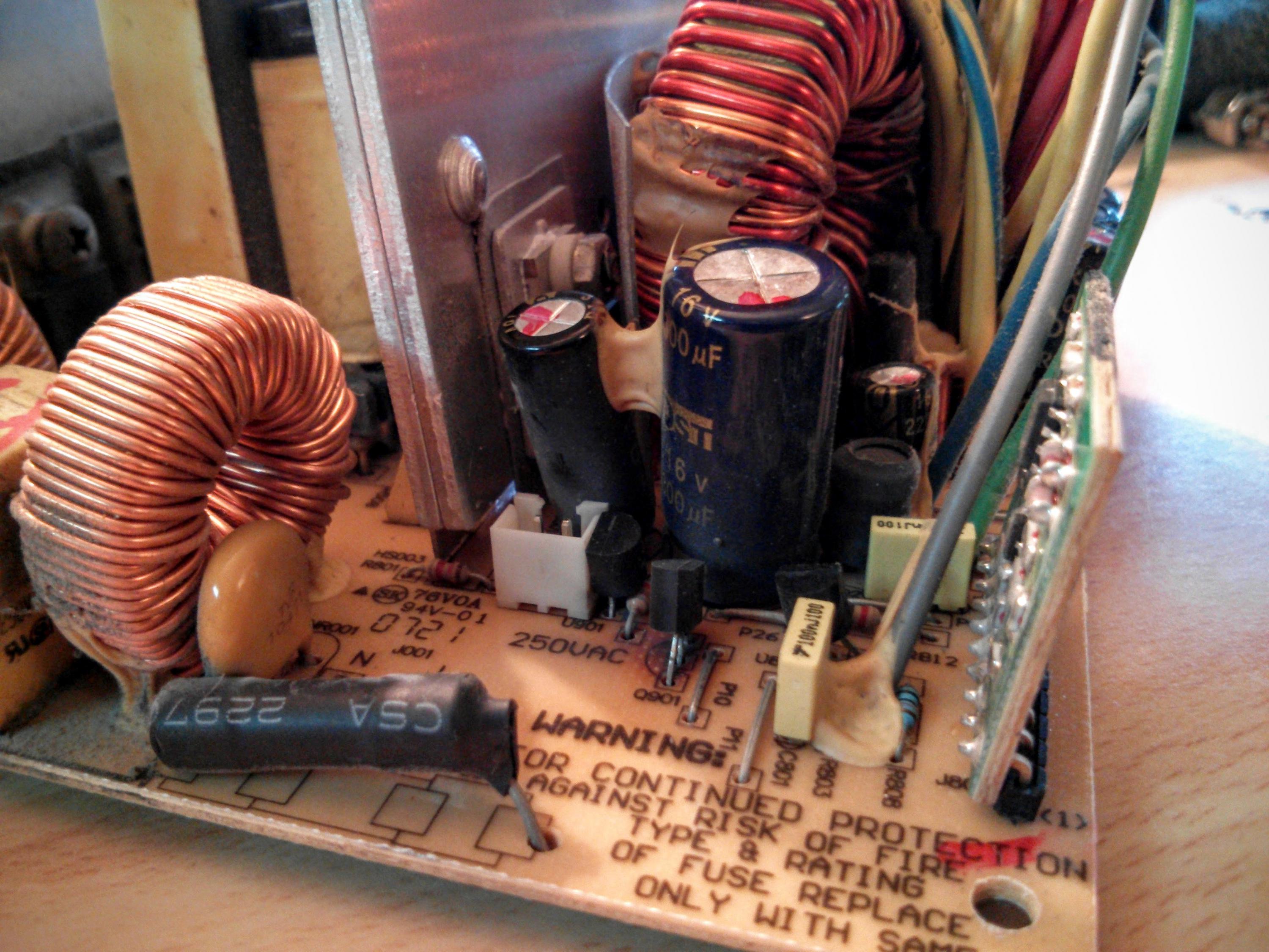

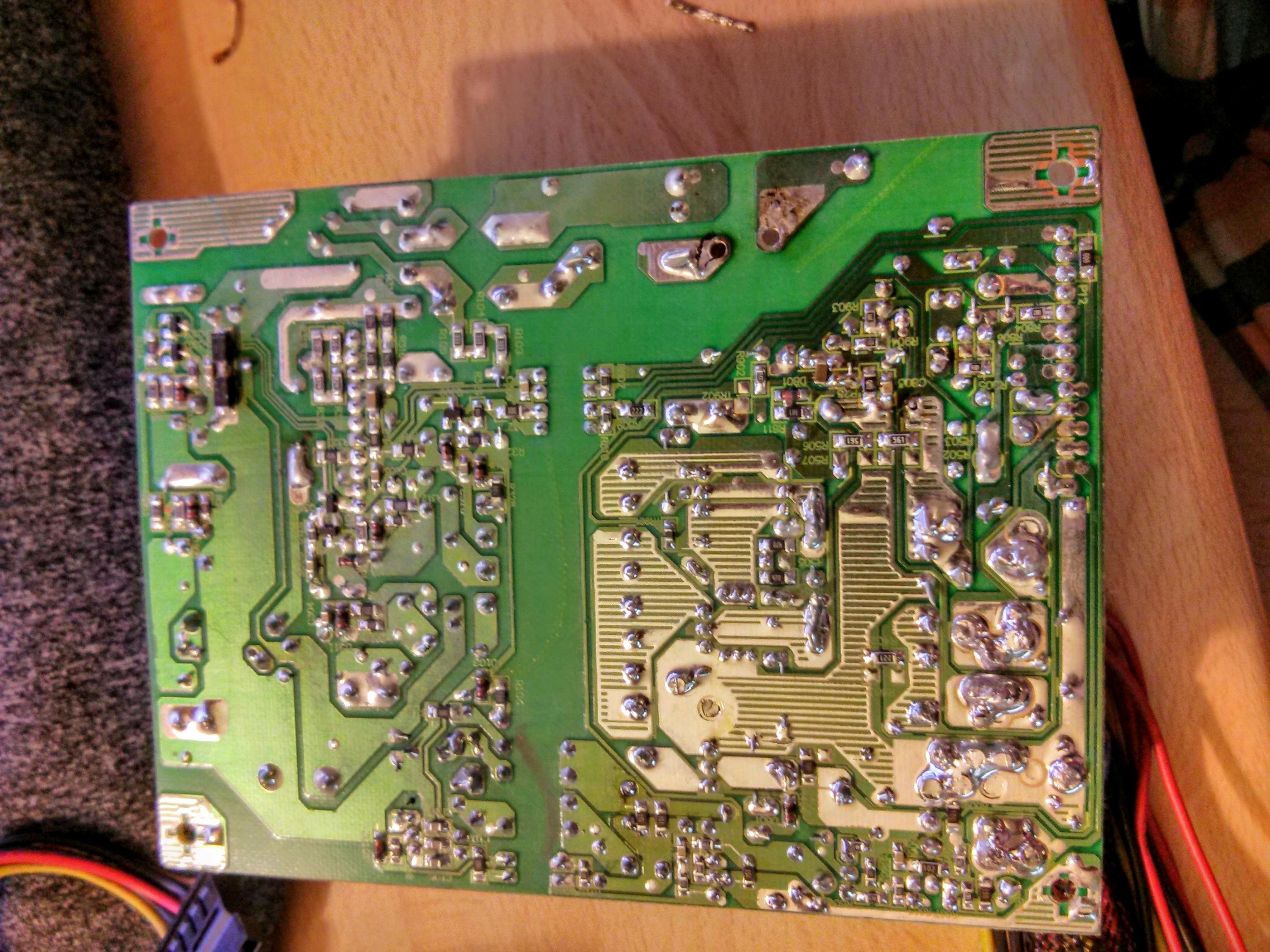

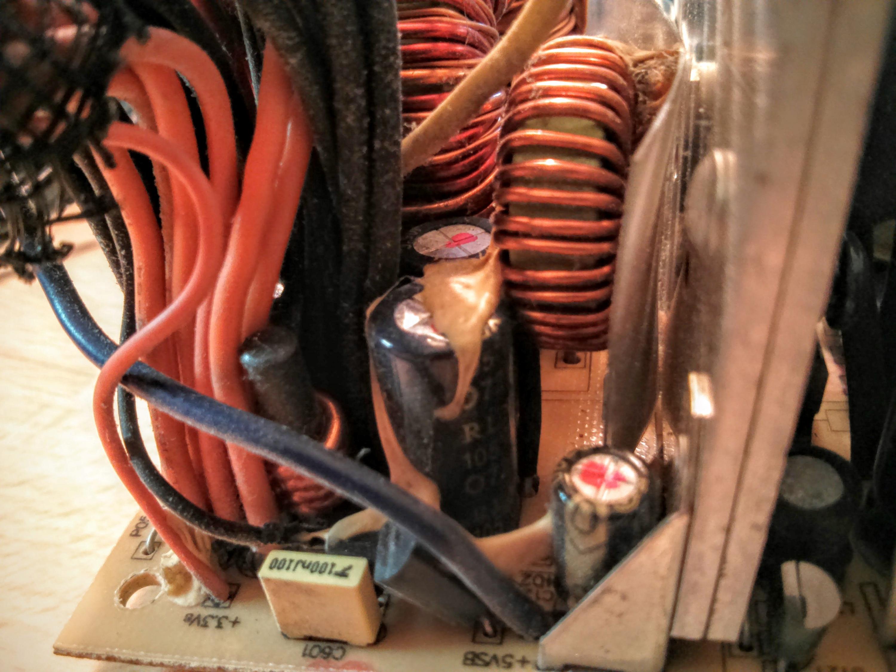

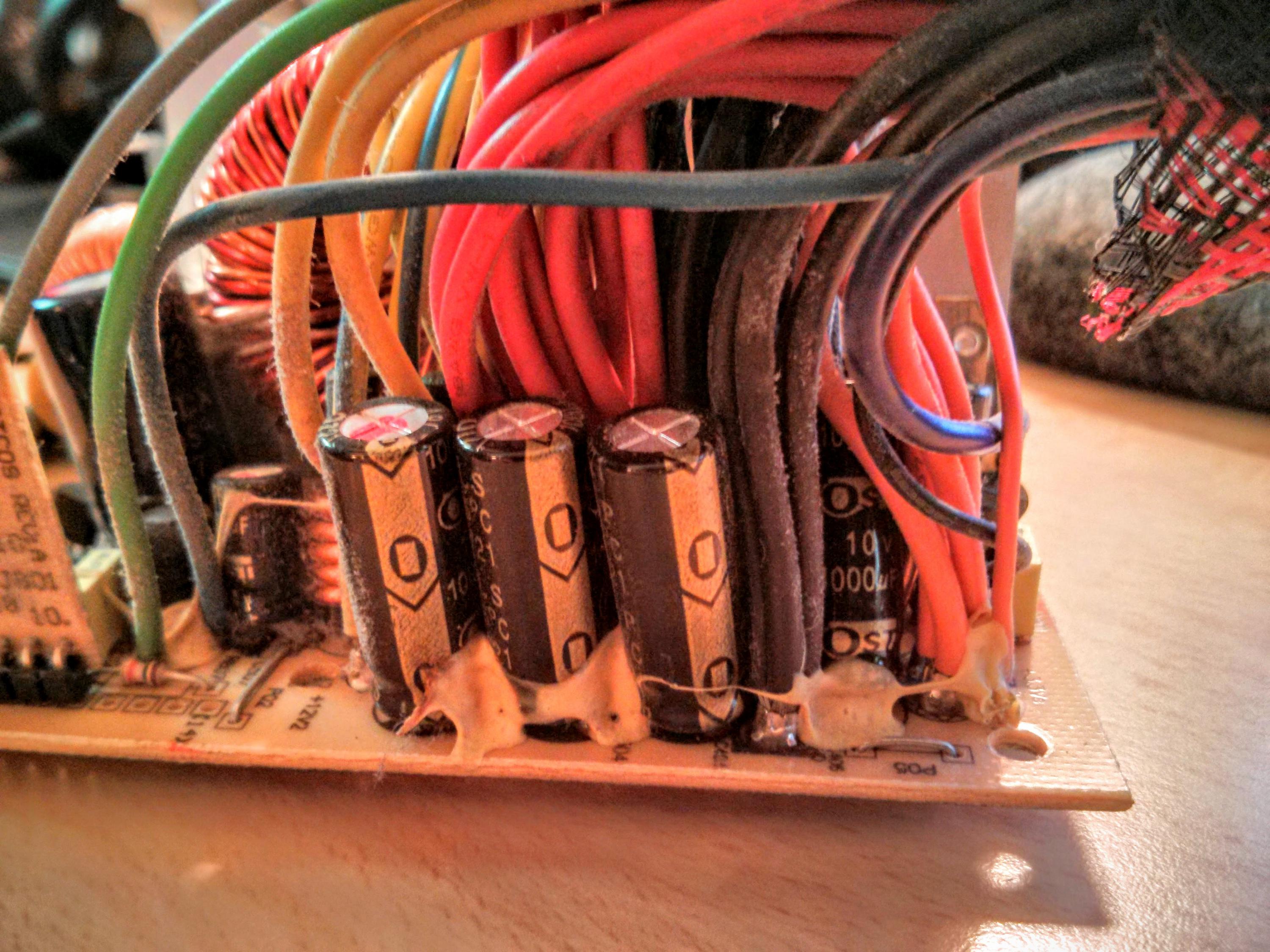

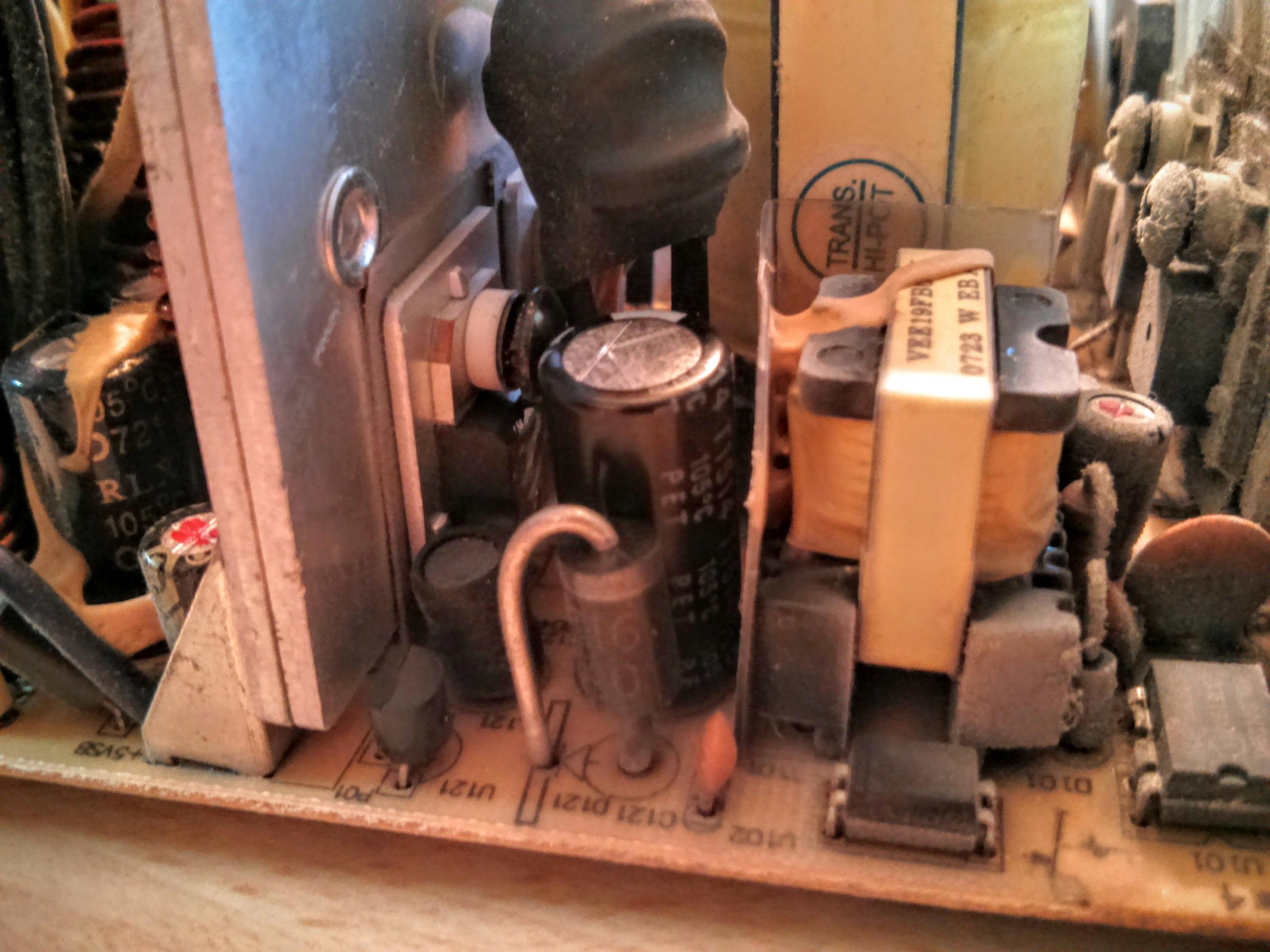

          In the middle of re-capping an Antec Earthwatts 430 now, so I thought I'd share some pics of the innards in case it would help anyone else. I've only replaced 1 OST 3300uF 10V so far, ran out of solder wick. Replaced it with a Rubycon. Have 8 more caps to do, I think.
          Recapped a nearly identical Antec Earthwatts 330 a few days ago for my wifes PC. Running fine. Also did an Antec True330, haven't put it in a PC yet, but with a load all the voltages seem to check out ok.
