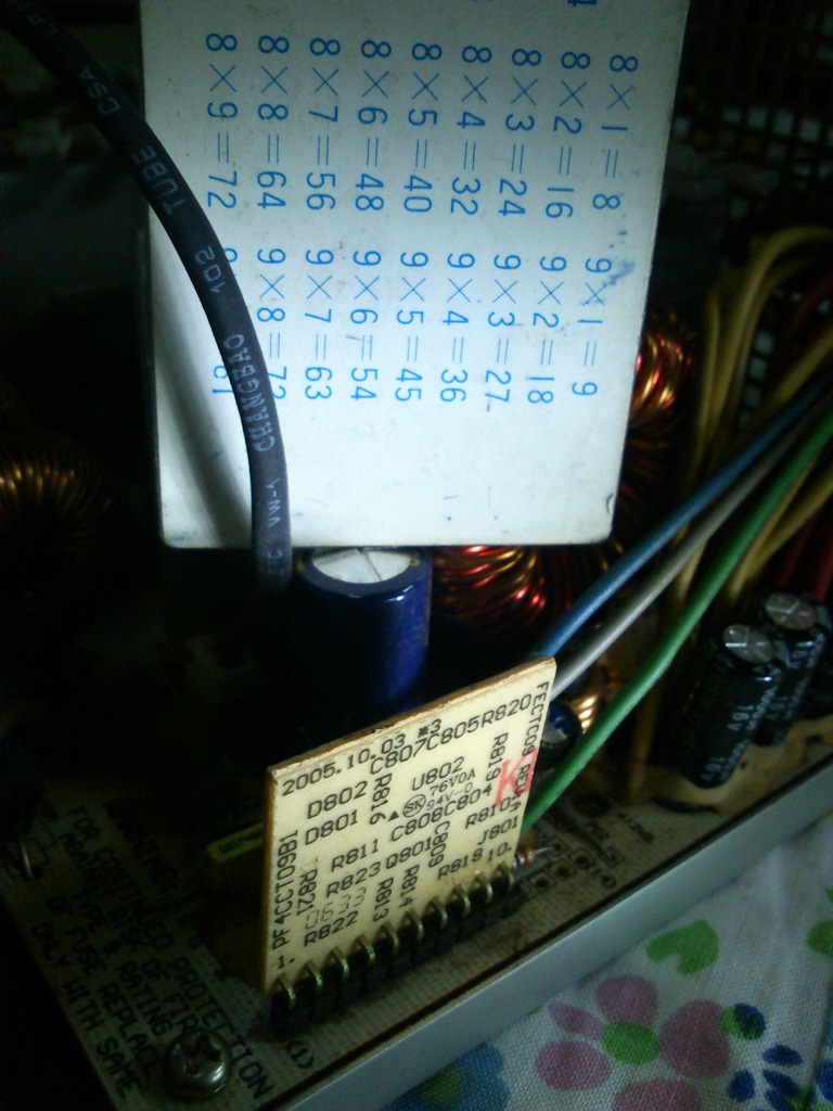

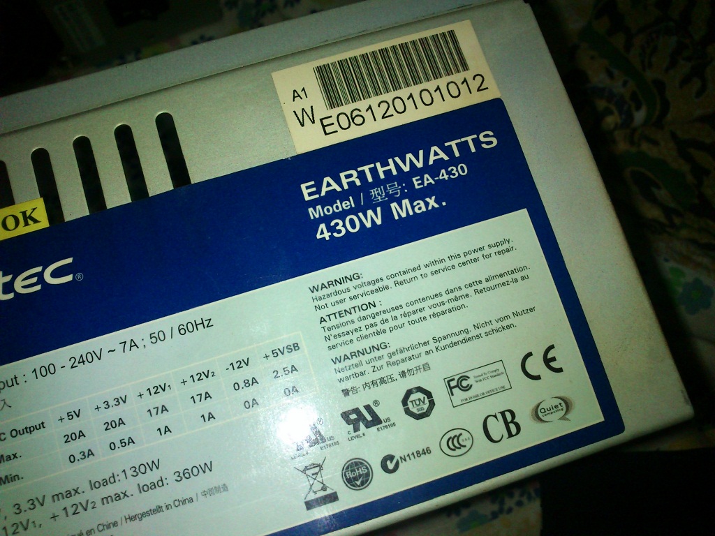

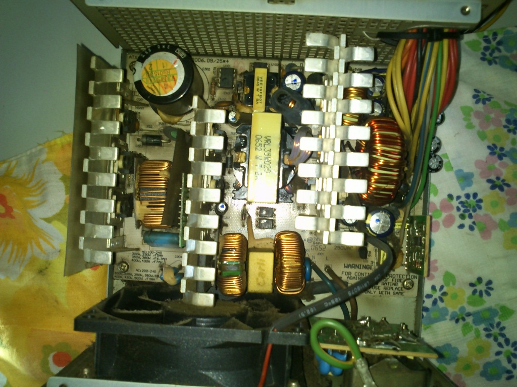

    Antec Earthwatts EA430 with fathead RLX
    Recently I sold off my 45w Athlon X2 processor and Abit motherboard. Wanted to reuse the Antec Seasonic-made Earthwatts for a new Intel i7 setup.
    SilentPCReview and Antec Earthwatts 430
    Since the warranty for the Earthwatts has apparently expired (purchased April 07), I decided to open up the PSU and check for bad caps. Lo and behold, a bulging RLX staring at me.
    The previous Abit motherboard which had 100% Rubycons showed no similar signs upon a visual inspection. All the caps looked good. Amazed that the setup even managed to last nearly 5 years.
    Did I also mention that the Earthwatts, like the Gen 1 CWT-made Truepowers had messy entangled cables coming out of the PSU?

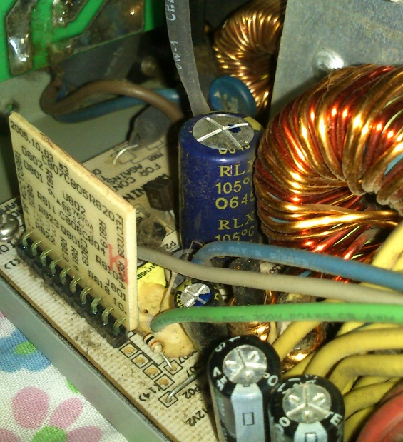

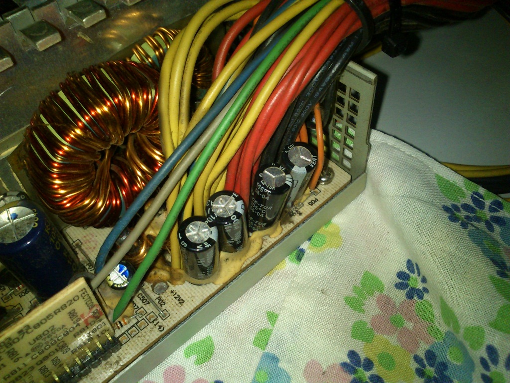

    Re: Antec Earthwatts EA430 with fathead RLX
    More pictures for your amusement. Fuhyyuu Antec.
      Looks like the -5VSB cap. I would do a total re-cap of this PSU. Looks like a mix of those PCE-TUR caps with OST and some Teapo.
        thanks for the suggestion. I don't have the skills to do a re-cap. Besides, the messy wires are pissing me off. Makes cable management a pain.
        Thankfully, no components fried by the Earthwhats.
            I'll second that. On these units it looks like Seasonic reached into the Cap grab bag on the early ones, I've seen low ESR and GP caps of various brands in the same position on different examples of the same model PSU. You could probably get away with good GP caps such as Nichicon PW, Rubycon PX or entry level low ESR such as UCC KY (I'd probably stick to at least entry level low ESR for all the larger >1500uf caps). That being said the later examples of these Seasonic Built Earthwatts I've seen had all low ESR OSTs, some motherboard grade. These later models seem to hold up better, so it might be better to use something like UCC KZE, Panasonic FM, Nichicon HM, Rubycon ZLH, etc. Also the Seasonic branded version of this platform also has all Low-ESR caps so it looks like this PSU was designed to use low ESR but GP caps were substituted in many of the early Earthwatts for cost reasons.
                            PX are GP caps.
                            PW are not GP, they are entry level low ESR and exact equivalents to Panny FC for all sizes they both have.
                            KY are a step above what I'd call entry level and exact equivalents to Nichicon HE for all sizes they both have.
                            KZE, ZL, WX, HD are all equivalents and a couple notches above KY.
                                To be specific about the rig this EA430 was running, it never saw anything more than an AMD Athlon X2 2.5GHz (45w energy-efficient) and an AMD 4670 graphics card (<75w, no PCIE power connector). I even ensured that the PSU was not competing for airflow with the CPU fan using some ducting.
                                This Earthwhat dud is using a straight-thru cooling system and a 80mm fan. Some of the higher powered Earthwatts use a right-angled airflow system and 120mm fan IIRC. Not sure about the newer EA-xxxD Deltas.
