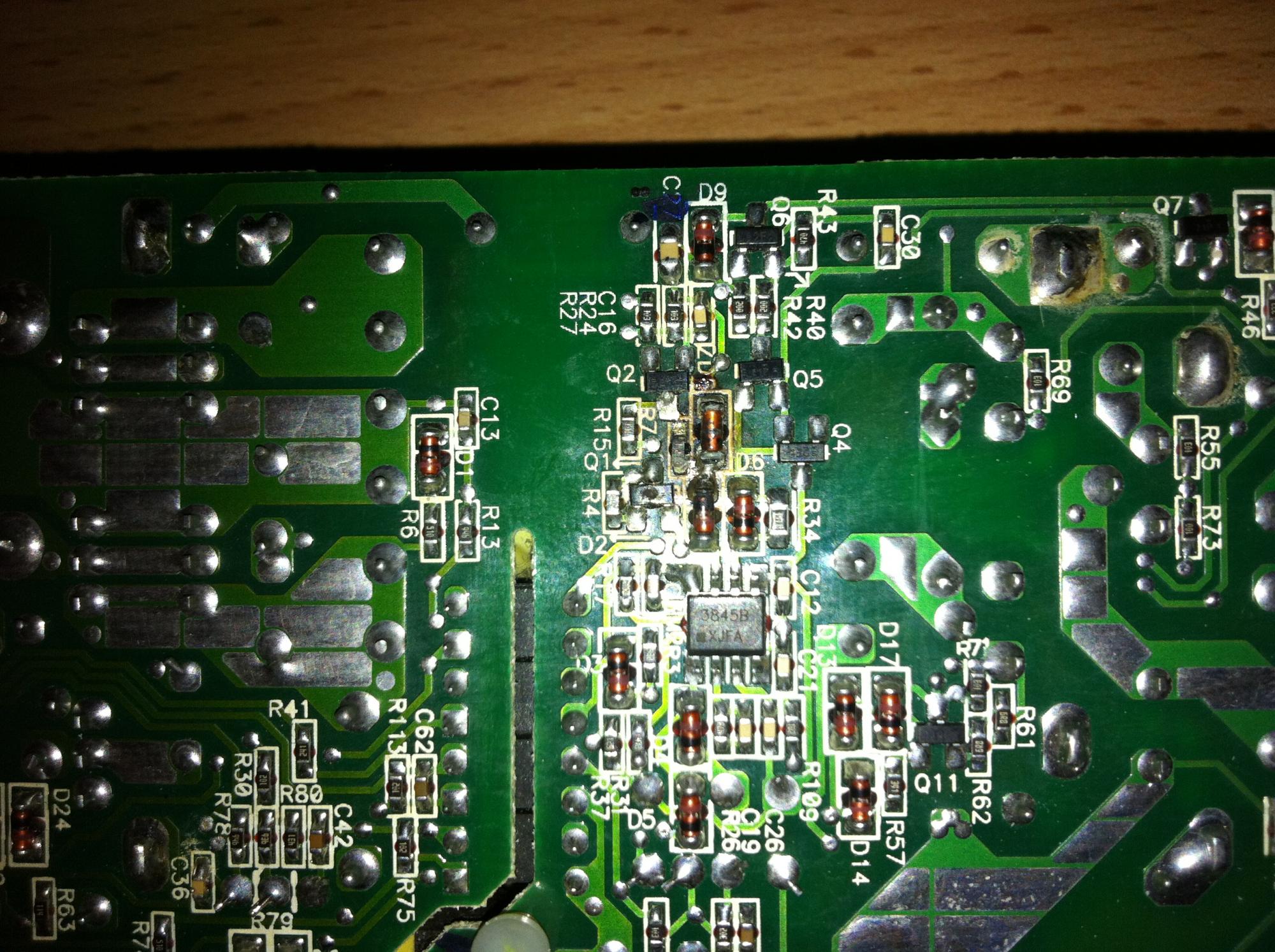

    I have a iMac g5 psu to repair. I have changed caps but I noticed that Q1 has a hole in it and ZD6, D2 and R7, all have heat damage and I would like to change them.
    Does anyone know what value they are?
    The psu board is marked AP14PC47
    If anyone can help that would be great.

    With Q1 destruction, damage to the 3845B & 4863B is also likely. Check 2 - 10Ω resistors nearby for damage (pock marks).

          " With Q1 destruction, damage to the 3845B & 4863B is also likely. Check 2 - 10Ω resistors nearby for damage (pock marks)"
          I have checked 2 resistors r24 & r27 are the the right ones. They look fine.
          3845B & 4863B visually look ok should I change them as well or not.

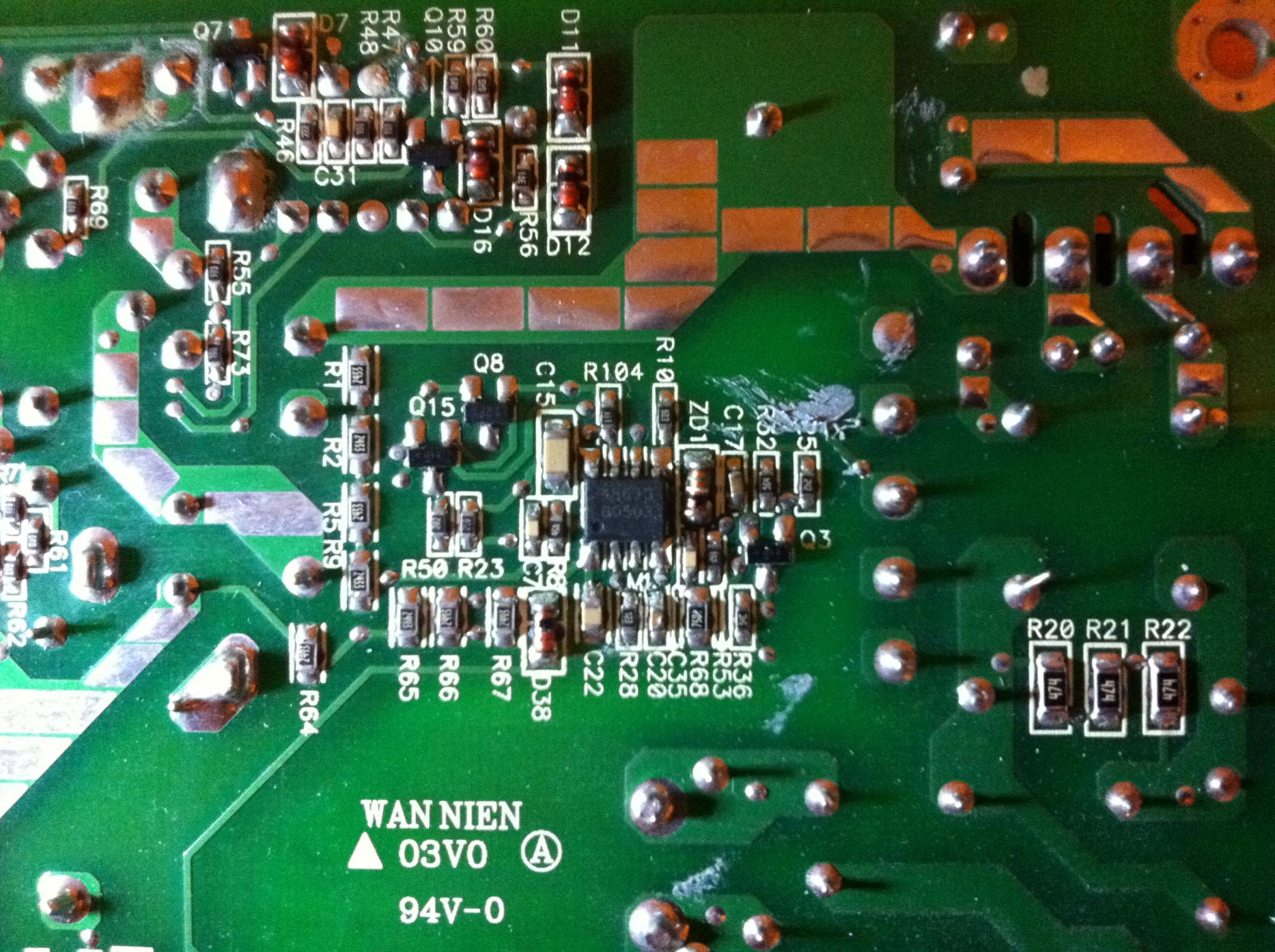

            I wasn't specific enough. A photo of the 4863G chip area please (lower right). The 2 resistors should be to the left of that chip and marked 100 = 10Ω. VERY tiny resistors. I have them as R23 & R116. Measure them.

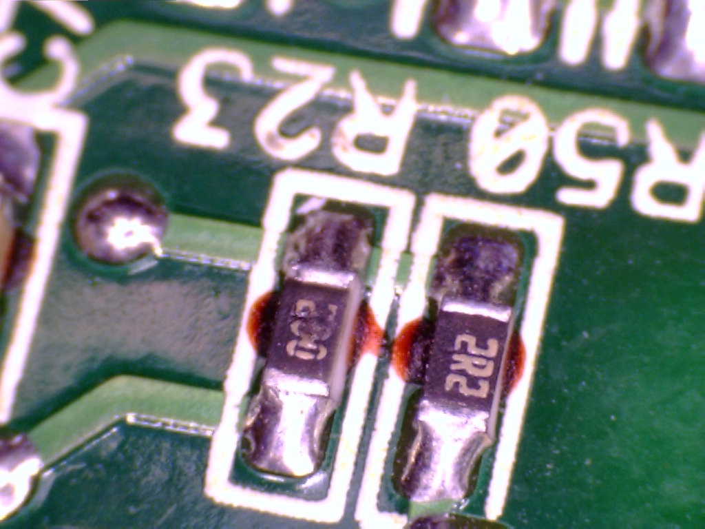

              Here is the photo of r23 and the one next to it r23 looks shot.
              What should I order to fix board?
              Is it possible to repair or not. I have looked at the cost of parts so far and they are only a few pence will i find a lot need replaceing.
              Carl

                Shot's too close. I need to see the larger area and the chip nearby please.

                  Re: iMac G5 PPC Power Supply
                  • Toasty
                    • Jul 2007
                    • 4171
                    Thanks for the photo! This is a -bit- different, but essentially the same as the 4PC46.
                    The -46 uses 2 - 10Ω in series, whereas this one uses 1 - 20Ω.
                    If that is blown (obvious), then -most likely- the 4863G is done also.
                    Let me backtrack and explain a bit here. The ZD6 zener "clamps" the output (emitter) from Q1 at ~16.7vdc. Since Q1 cratered, it passed B+ (25v or more) on its collector to the emitter, then on to the rest of the the circuit and ZD6 cooked. The 3845B PWM chip can handle up to 30 volts (internal 34v zener), but the 4863G is -max- rated at 22 volts, nominal of 20 volts (internal 20v zener).
                    All of this comes about from a bad filter cap (C37 - 100uF/50v) on the hot side supply circuit that is powered from the TOP244Y.
                    This is the reason I insist on changing the small caps in these power supplies. I see so many from other techs (or who claim to be) with this cap not replaced. If it fails, B+ can rise to 40v or better. Next time the switch is thrown, Q1 is sitting there with B+ of 40v and gives the circuit a helluva shot. ZD6 clamps it and Q1 blows (I've seen them vaporized ), passing all that voltage into the 3845B which survives sometimes, but the 4863G torches the resistor and usually not in time to save it.
                    I would start with Q1 and R23 and make sure those 4 small caps in the Hot side are replaced. A resistance check on the input to the 4863G -may- uncover whether or not it's shorted. No guarantees. Before you power it, make sure that B+ on Q1's collector is right around 24v, no more.
                    Or, go on eBay and buy a nice Delta unit, recap it and be happy.

                          Do you have a bench power supply with variable voltage & current limiting? Might be able to test the 4863 before you pull it. At least put an ohmmeter meter across Vcc to Ground to see if it's shorted - Pins 8 to 6 both ways with the meter. Perhaps you got lucky and the resistor and internal Zener saved the chip.
