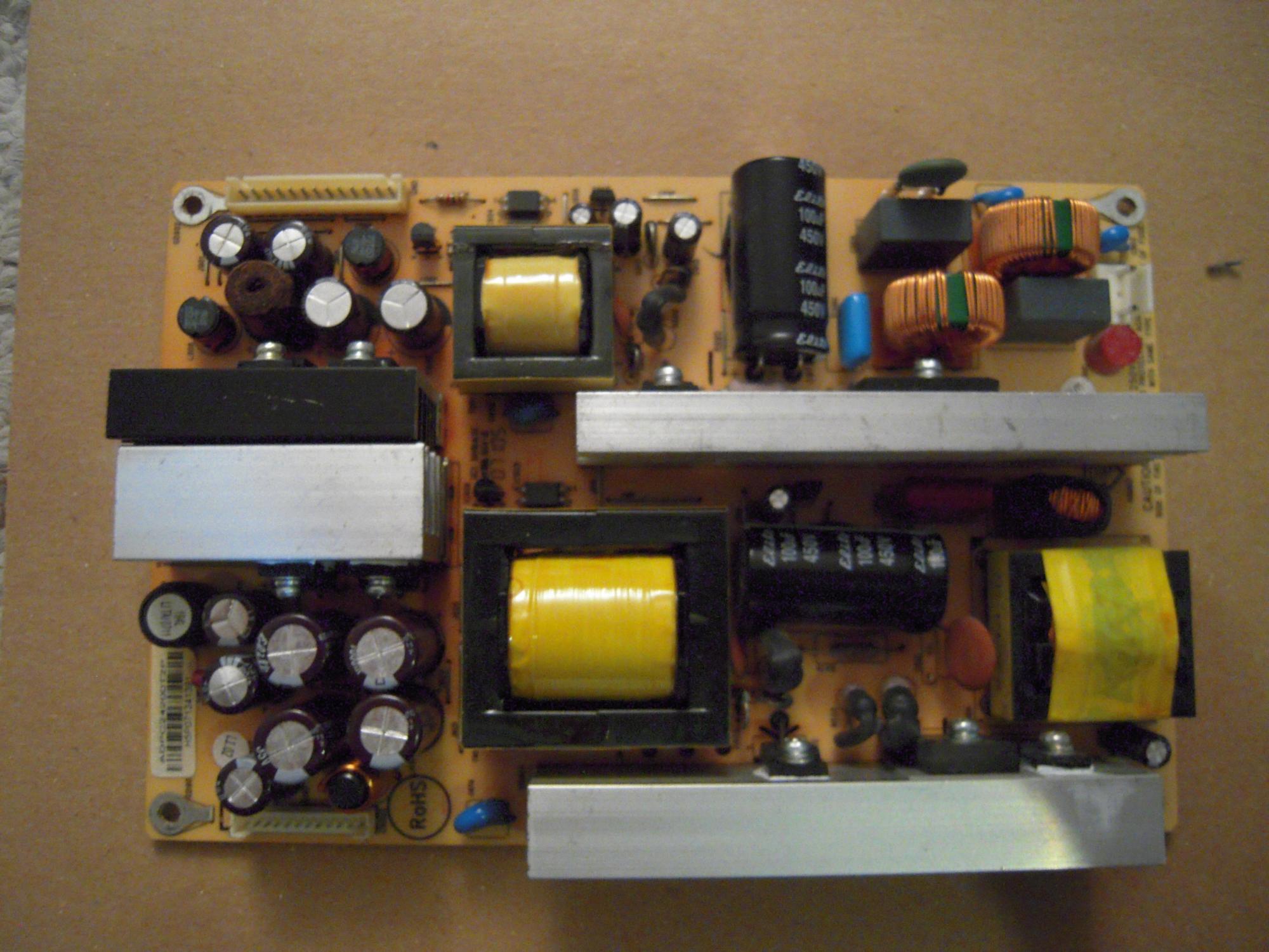

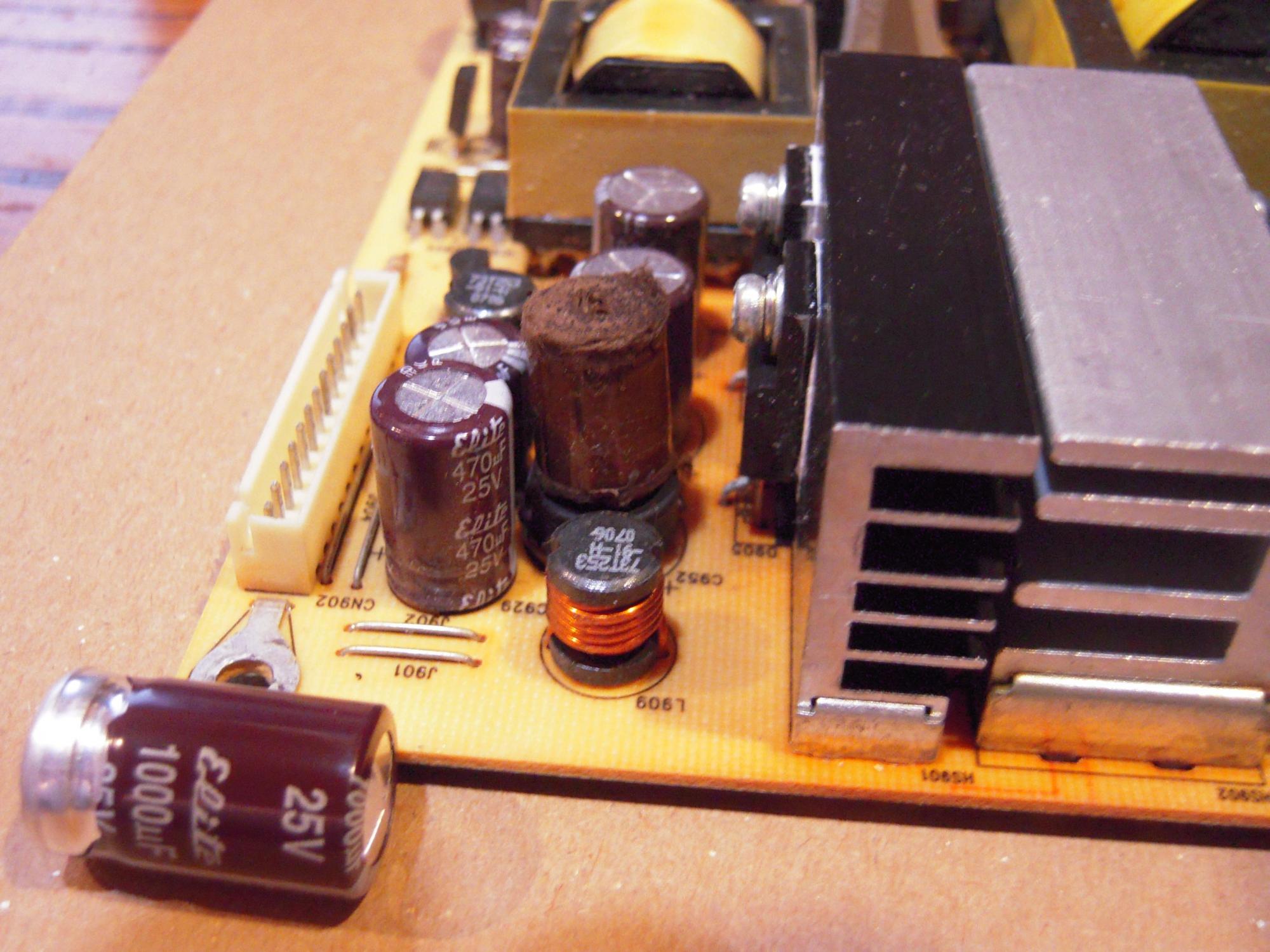

    Hello folks, I am new to this site, so give me a heading correction if I am straying off course for this forum.

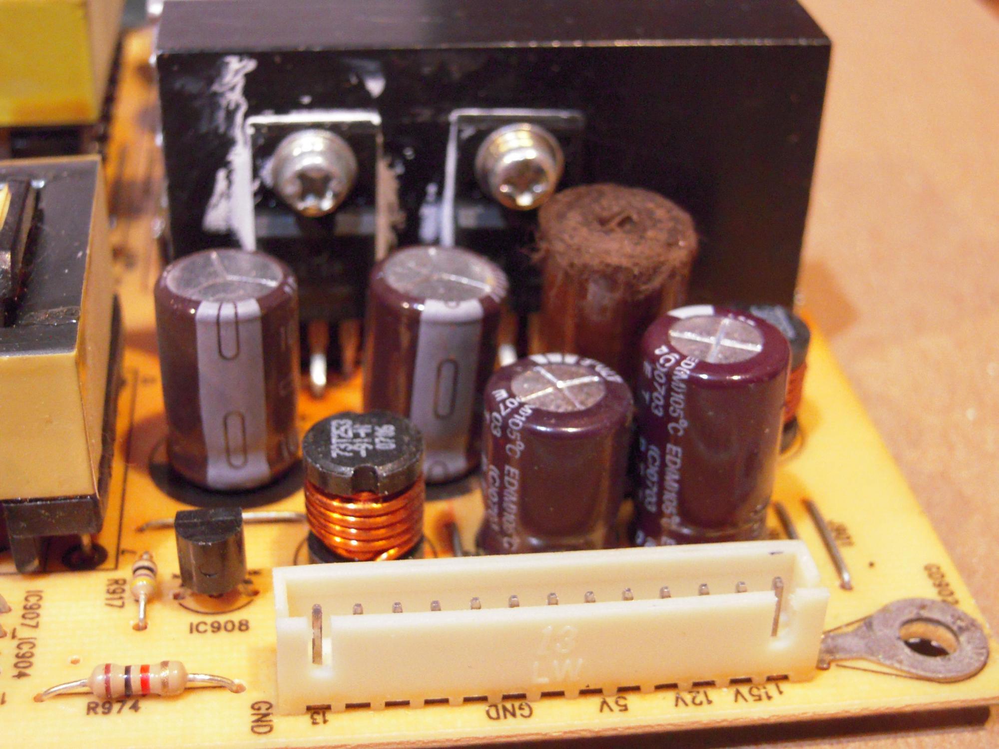

    I have an RCA L32WD22 LCD TV that went dark the other day. No response to button pushes, just a continuously blinking yellow LED. On dis-assembly, I found a 1000uf 25v radial cap (elite brand) that popped open (case separated from bottom and pushed upward). Power supply where bad caps are located is part number 715T2463 that looks like is used in a number of LCD TV brands.

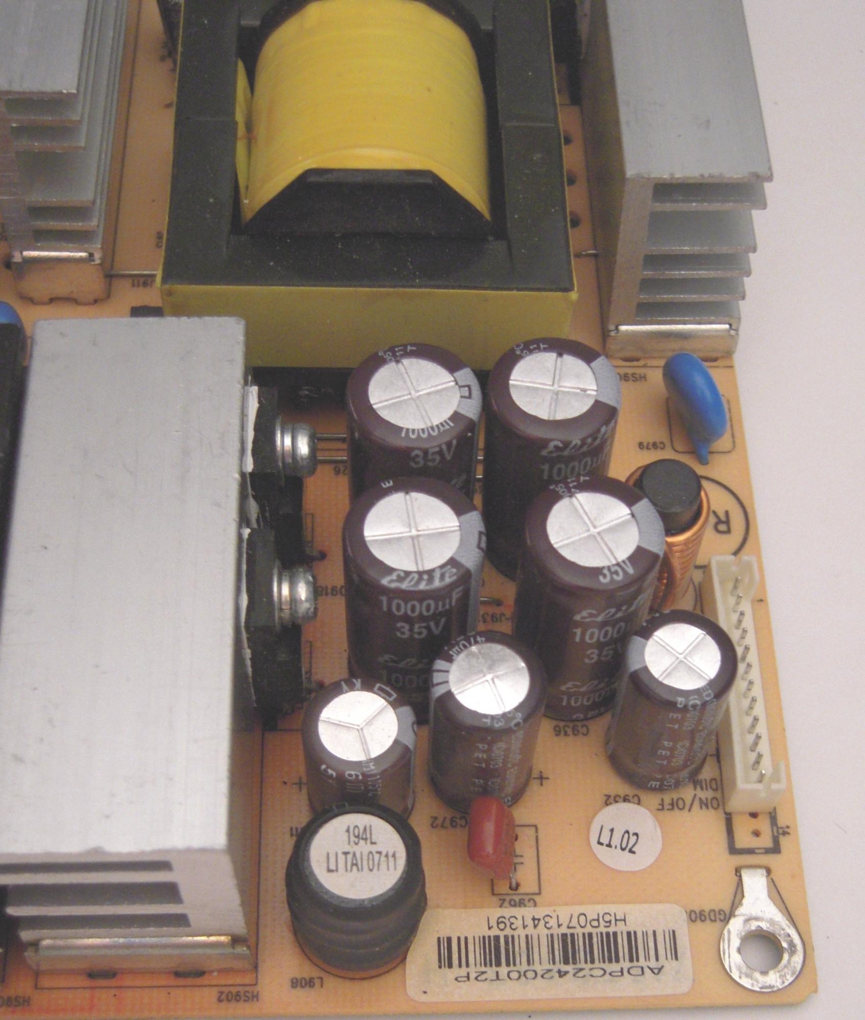

    I have schematics and board layout, the bad cap is is from the 12v supply section. One cap each in the 5 & 24v sections have some bulging also. All caps are Elite brand, 105 degC rated. The bulged cap in the 24v section is the smallest of a bank of 6 caps and forms the input to the 15v section. I haven't removed any caps yet to look at underside, but while I am in there will probably replace all.

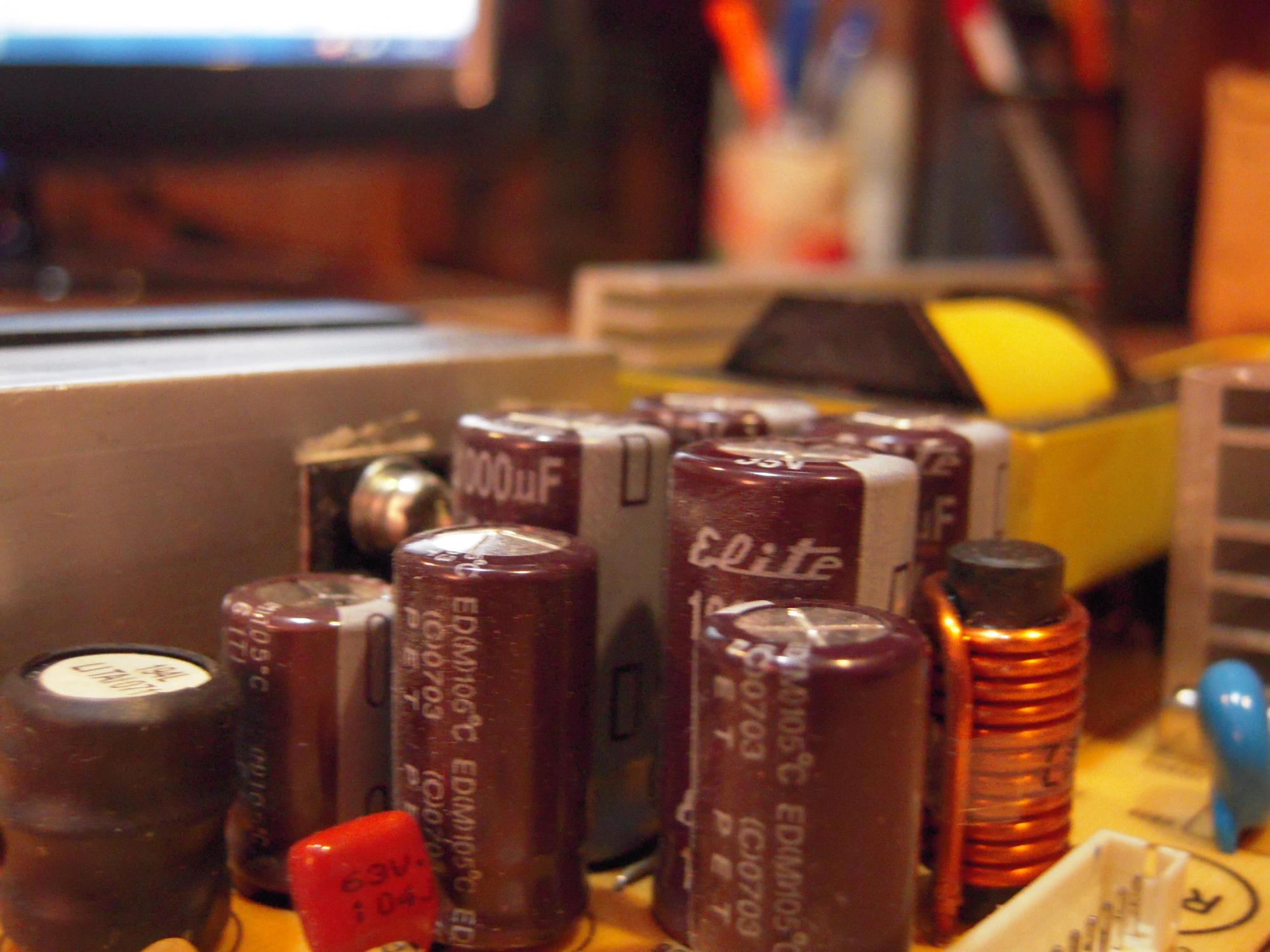

          On closer inspection, a few of the caps on this board were Nippon Chemi-Con (NCC) and not Chinsan (Elite). The NCC caps on this board can be picked-out by the three perforations in the top safety vent, the Elite caps have four (i.e. an X or cross).

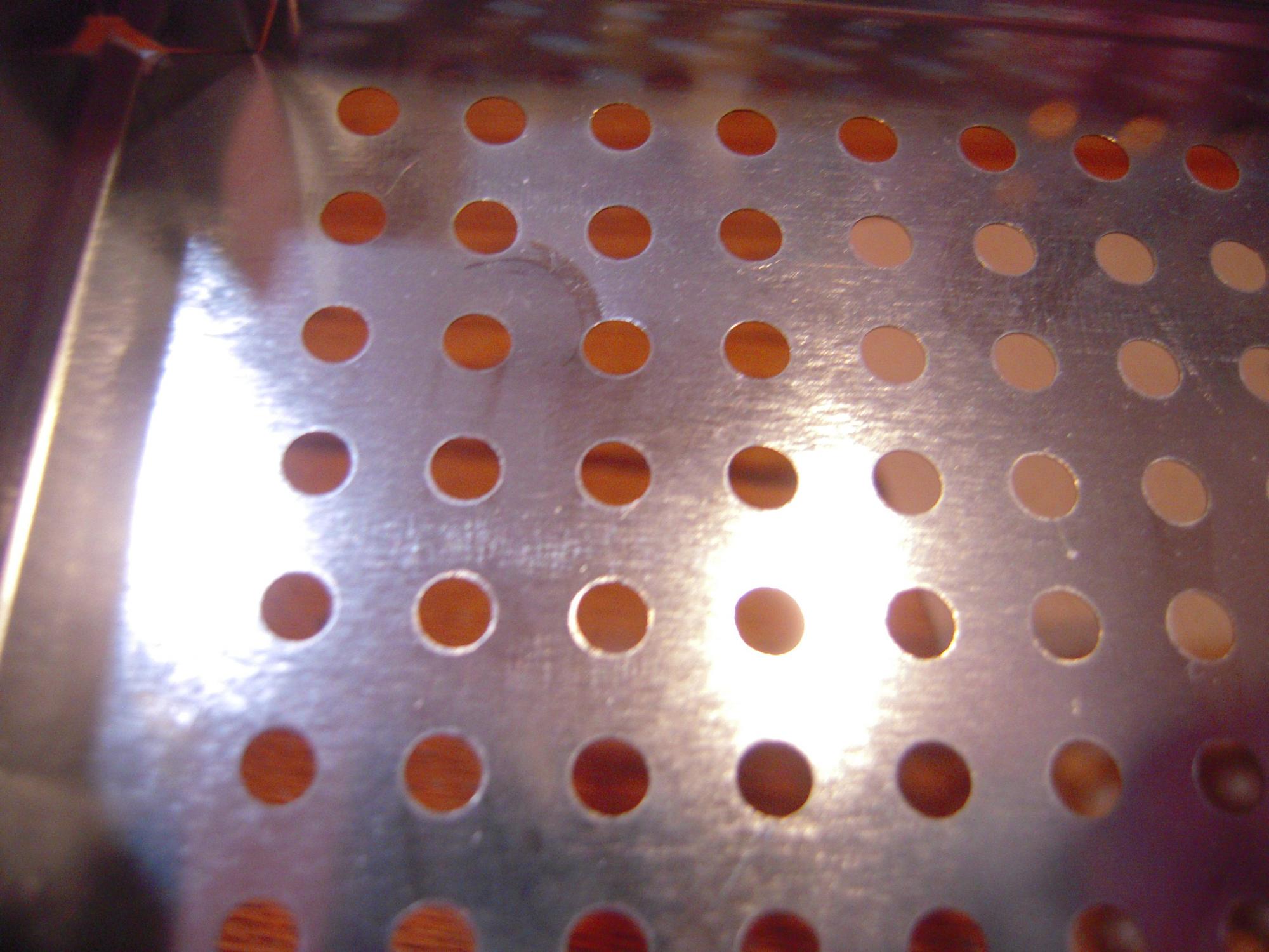

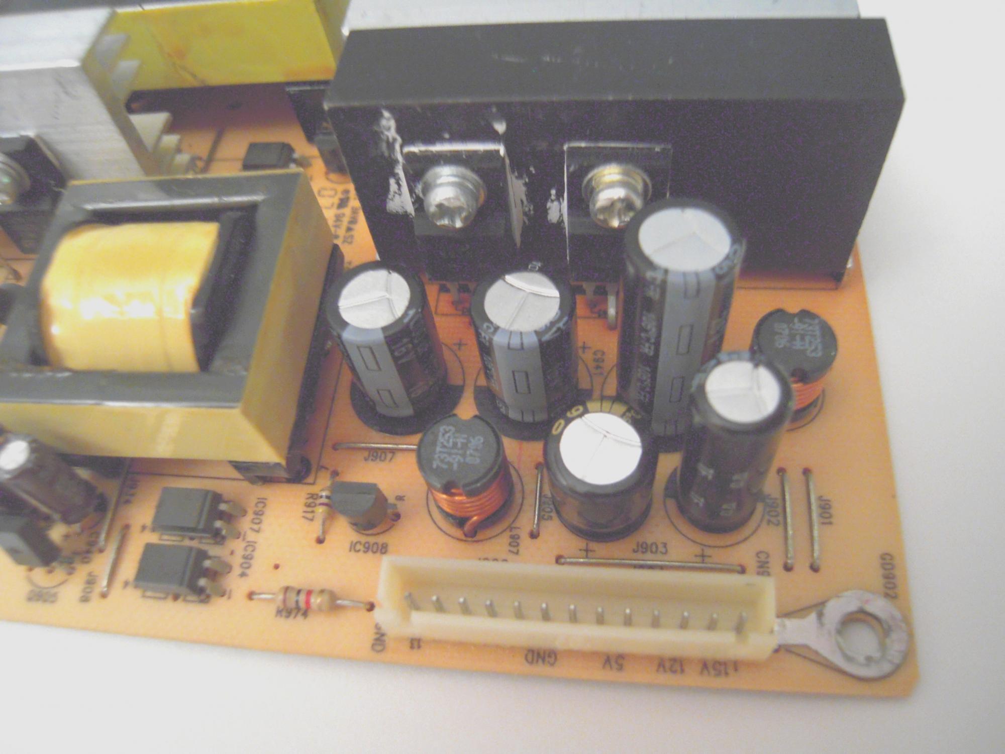

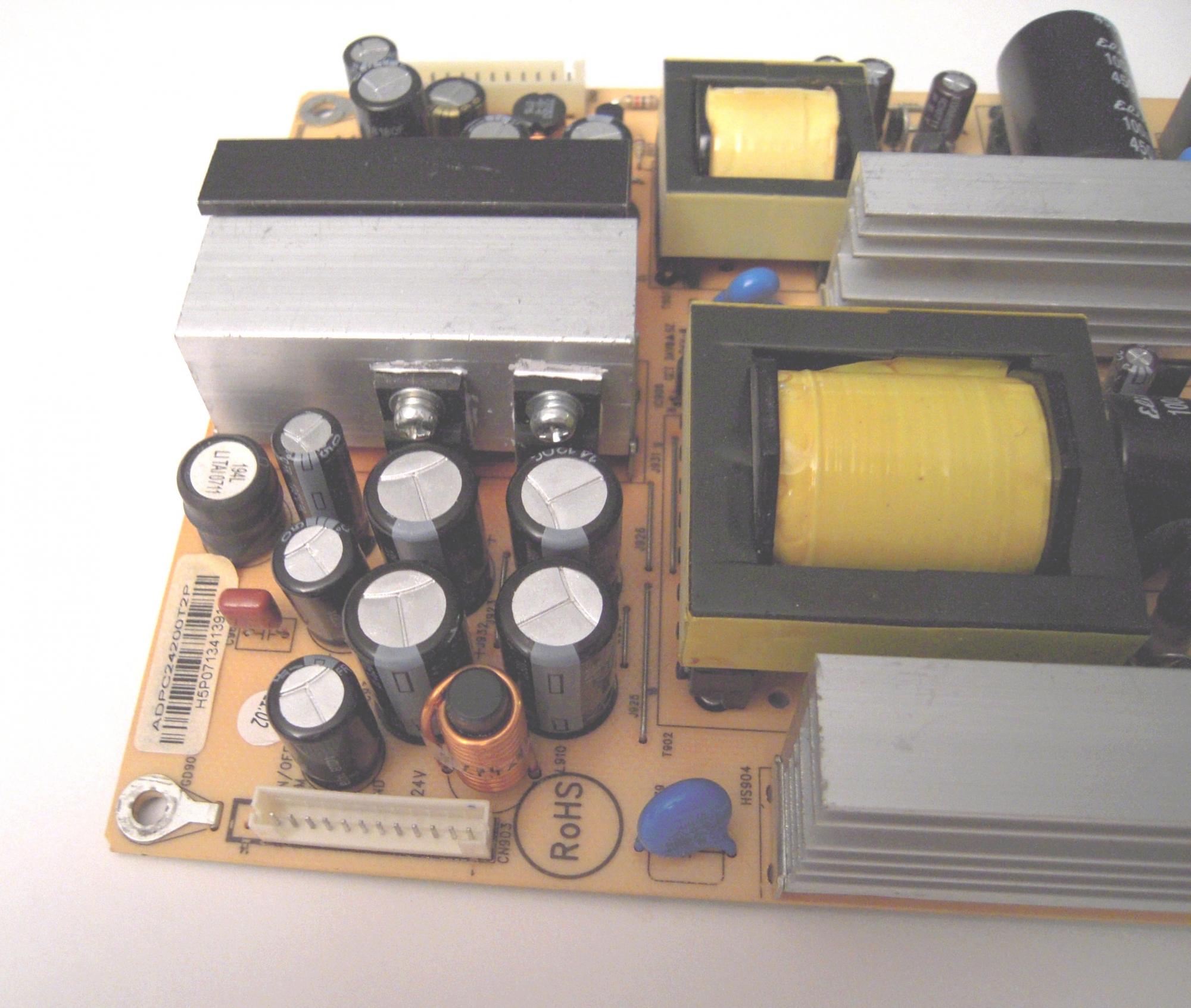

              Yes, I plan to replace them all. Images attached. It looks like there is plenty of room for taller caps, heat sink is a little over an inch, cover clearance is about 1.5 inches. 5v & 12v section is where popped cap is shown; 24v section is on other side of heat sink. Mild discoloration near heat sink on 5v side suggests that is running hot. Thinking of going with FM for C929; taller FR fits, but FM has better specs except durability (and would fit hole spacing better). Threw in picture of dented cover where C952 popped for fun

                Thought I'd post some pics of successful re-cap for this project. Better before, and a couple after pics. Went with Panasonic FR series in all but one spot where I used FM, and did replace all. Part numbers and specs for selections are attached as pdf file. Thanks for pointing me in right direction.
