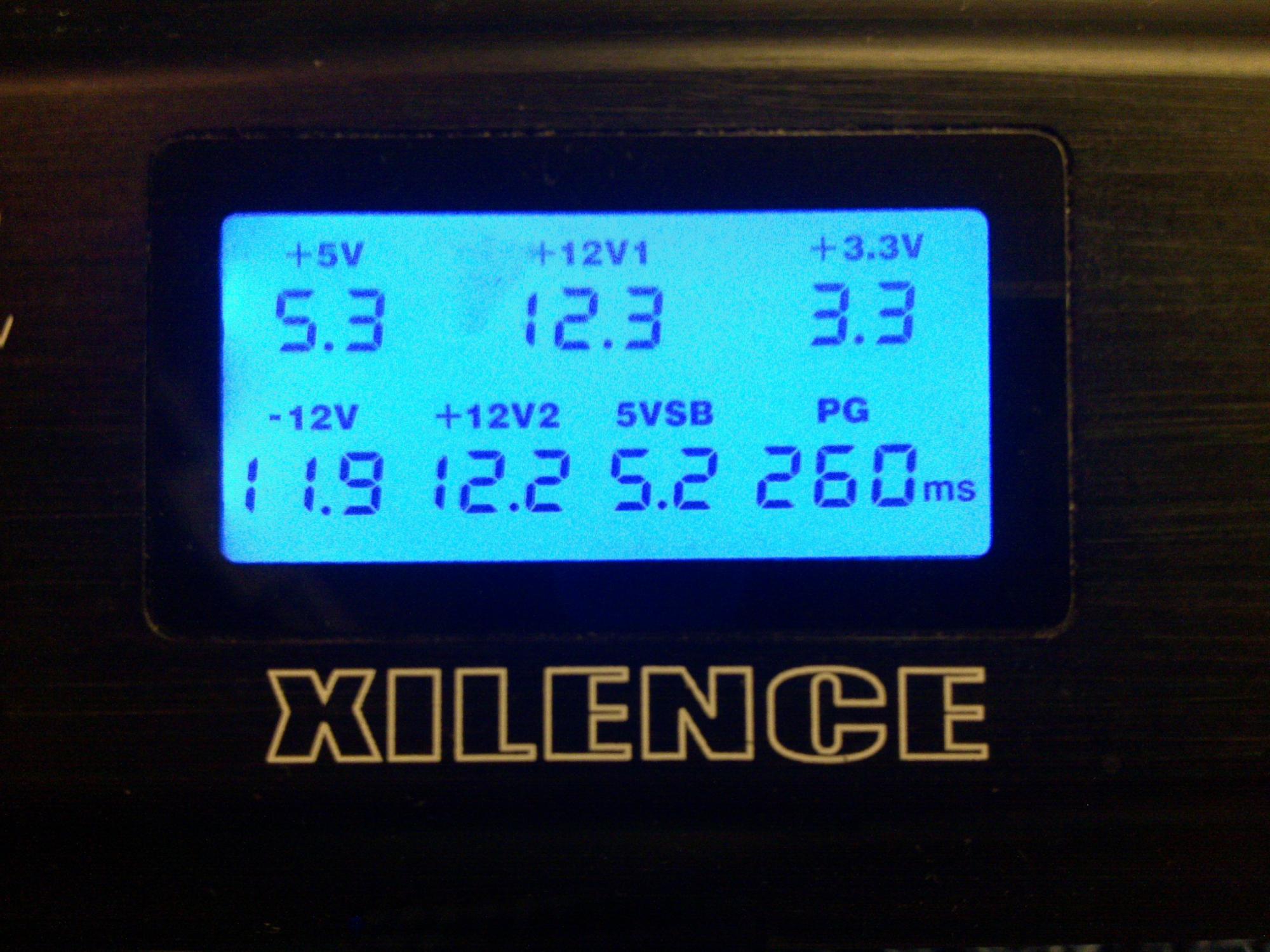

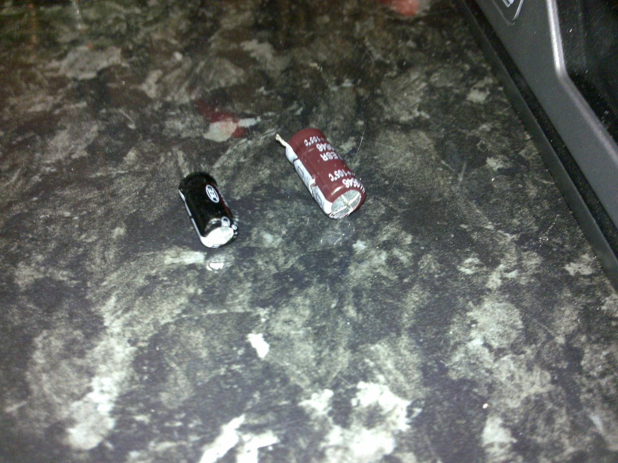

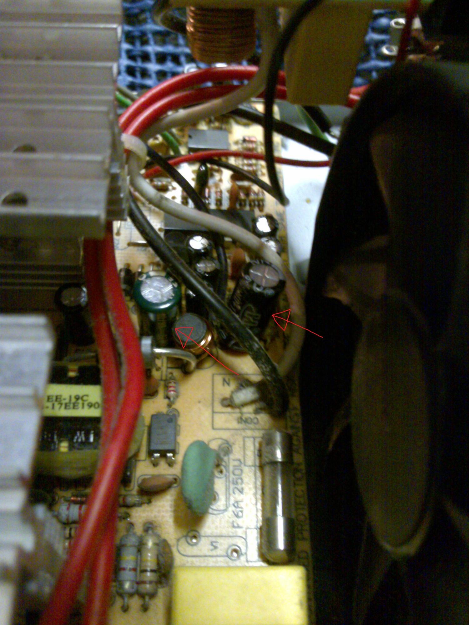

    So tonight I tackled a Casecom 350w as my test subject, this had two bulging caps, both JEE. The replacement caps were a Teapo and a H cap. The "H" brand cap was 25v so it had to be squeezed in a bit. I didn't care too much about the make as I wanted it to work first and not waste money on good caps.
    The 5VSB was waivering between 5.1 and 5.4v according to my Xilence PSU tester.
    Main caps are 820uf 200v CS. Other caps are a mix of JEE and JP or something like that.
    This isn't going to be used in an actual computer, it's future purpose will be for testing ideas I may have. With the caps I put in, definitely NOT in MY computer!

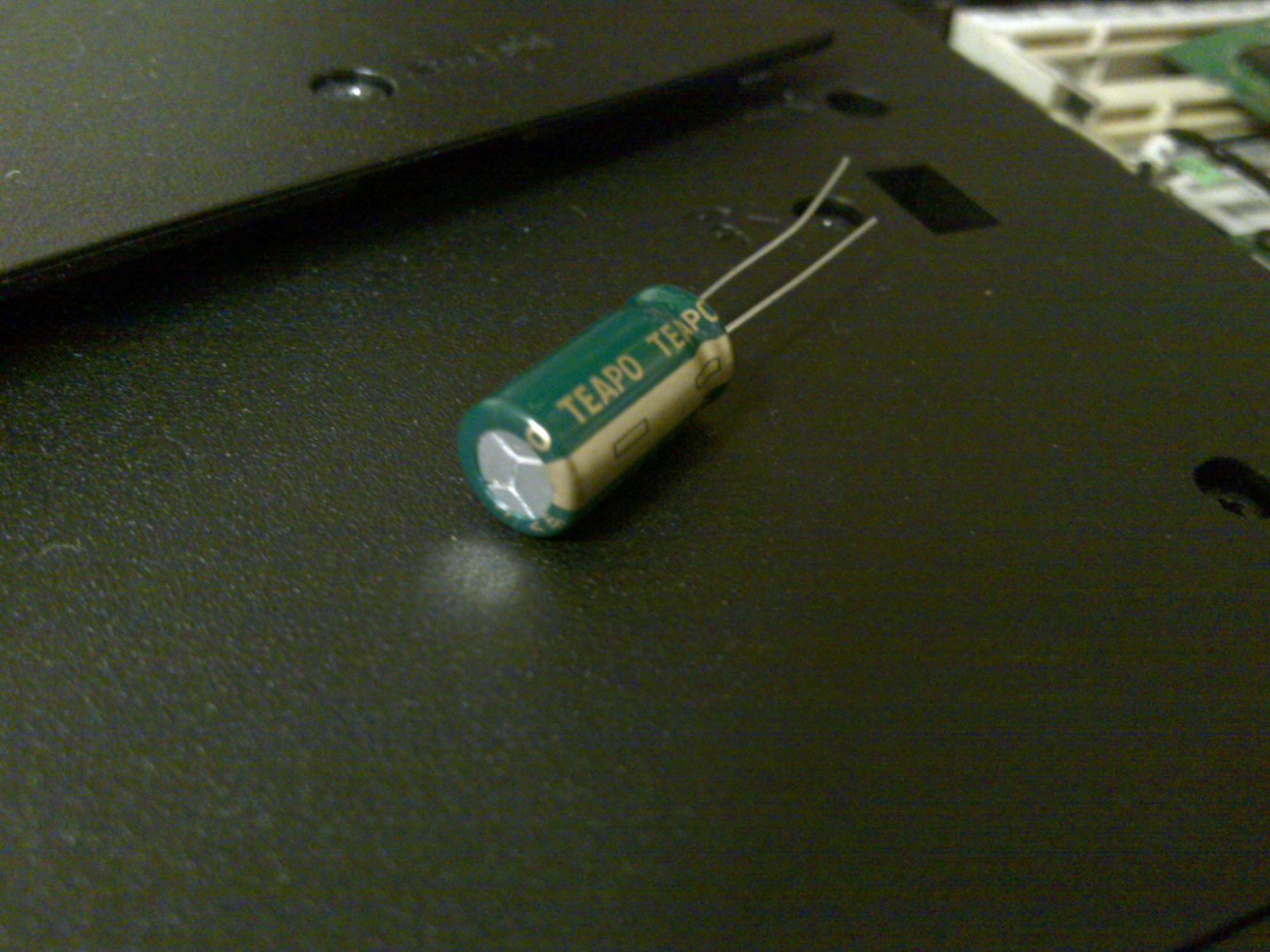

    I think it's a powmax but not sure. Also, look at the Teapo, it looks rather odd, looks like some sort of resleeved Jamicon or does Teapo also use this vent? These were my dad's grab bag of caps he got from eBay and like I say it worked afterwards and I don't intent to use it seriously. But it DOES power up my test PC and 5VSB now is settled on 5.2v.

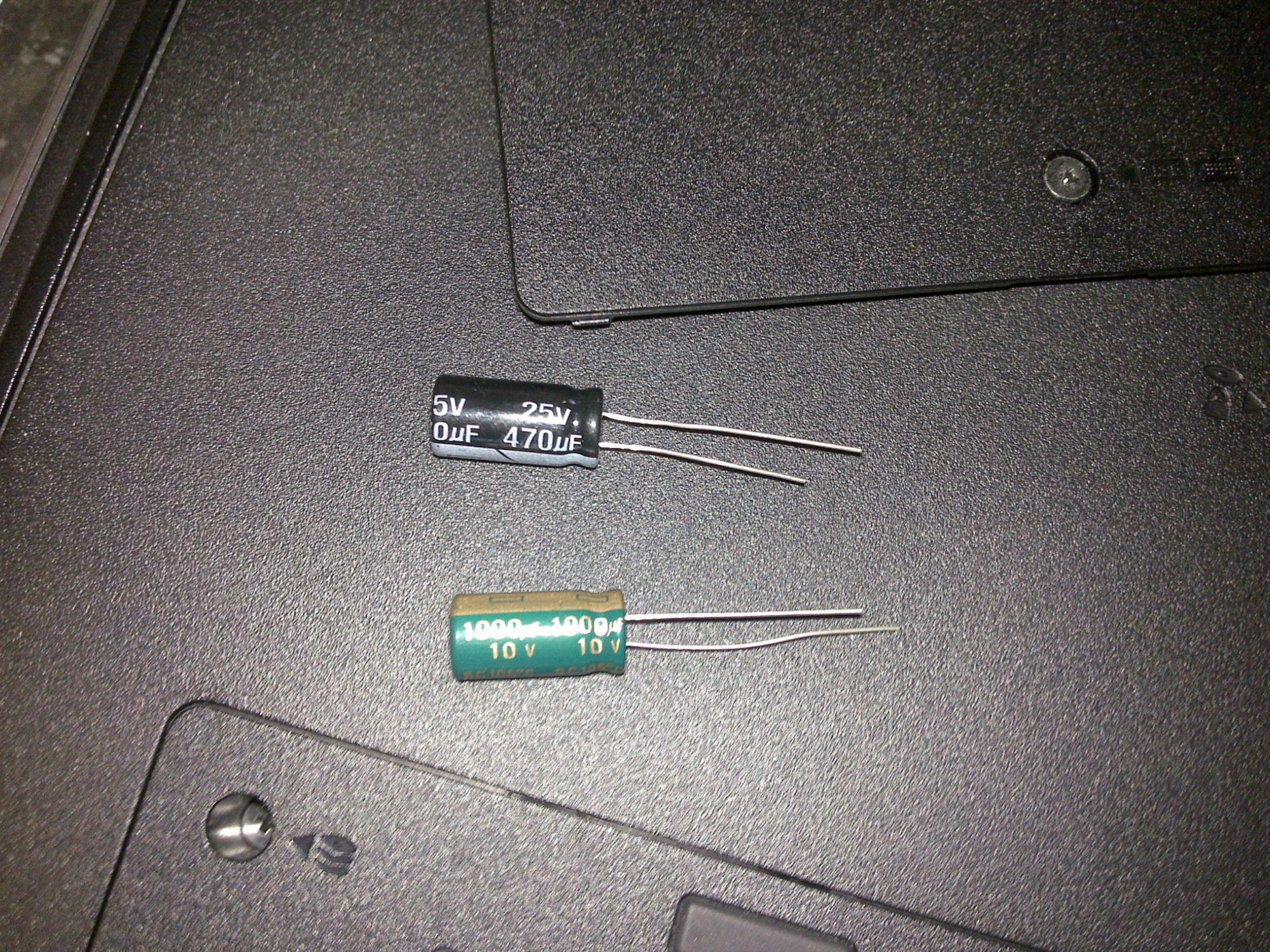

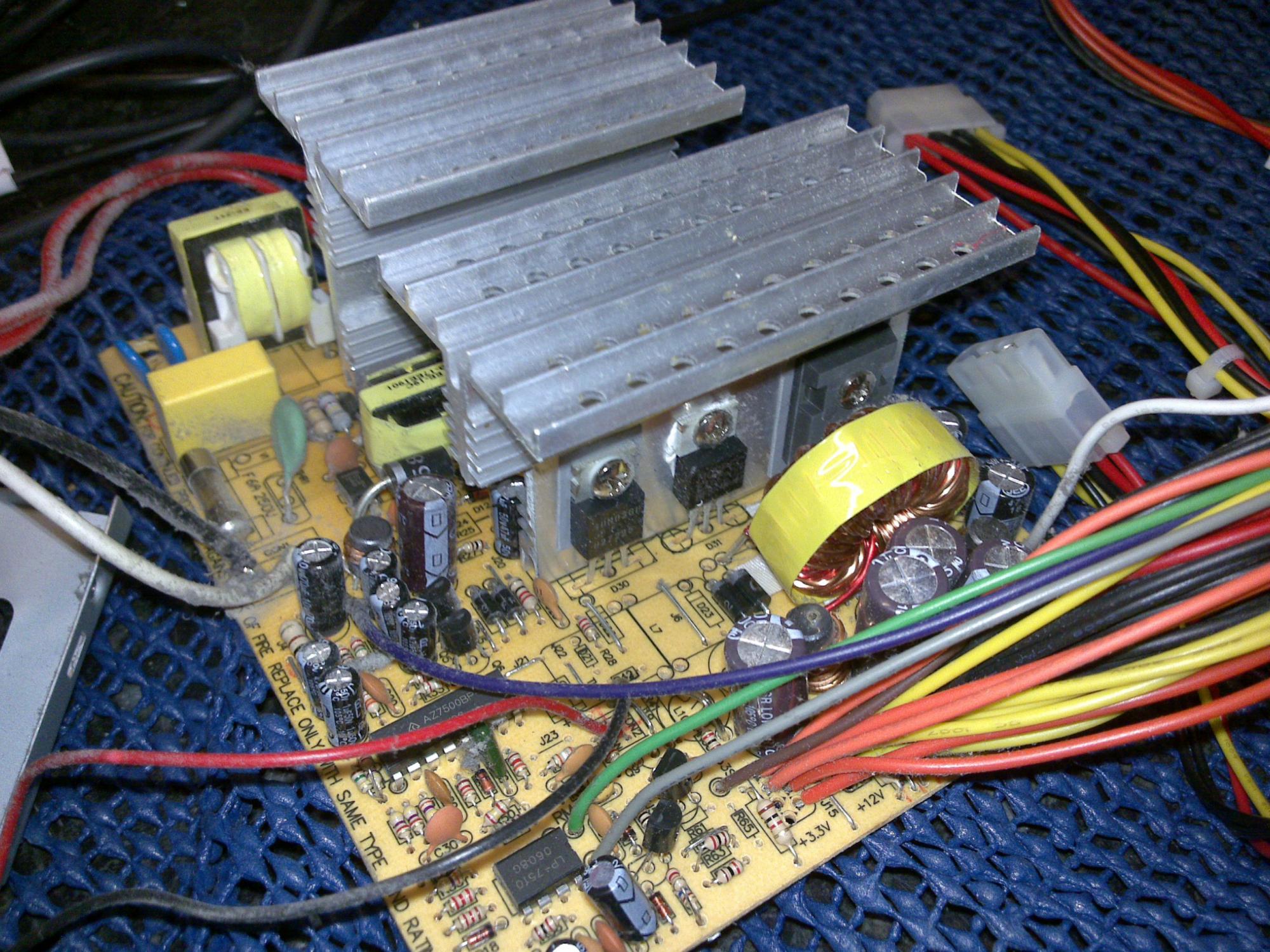

    Arrows are pointing to the new caps in pic 5.

      What's your thoughts on that Teapo? The vent doesn't look very Teapo-like?

        Actually I think these new caps were GP, I didn't check the series.

                    Anyone have opinions on my suspicious teapo?
                        Fake. Any Teapo you see in a power supply made in the last 10-15 years will have the three lines with three dots between them vent stamp. Hermei uses that vent stamp, but so does countless other yet-to-be-discovered small chinese electronic component companies willing to put a fake sleeve on their product. Large(r) OEM's (like sunpro in this case) like to use the small companies as suppliers as they are cheap and they wind up being their largest customer and can therefore control the company and their product.
                        • c_hegge
                          • Sep 2009
                          • 5219
                          Re: My first ever PSU repair
                          Who cares? they're bad either way. that said, though, teapo do sometimes have that vent
                                I agree with 370forlife - the Teapo your dad got from eBay are fake. Doesn't really make any sense why anyone fake an unreliable cap, but I guess that's just cheap Chinese companies.
                                Hermei also uses the Panasonic "T" vent.
                                  I forgot about that. Come to think of or I haven't seen a hermei use that stamp in a while. They might be NOS hermei caps that have been resleeved or some backwards Chinese oem.

                                    About the Teapo...
                                    SC105C (series and temp)
                                    A8 (??)
                                    02/99 <- hmmm, an old batch?

                                      I have some from a old hipro with 98 datecodes (that are still good btw,) and they do not use that vent stamp. The even older teapos use a light blue sleeve and they even use the three line three dot vent.

                                        Well that's very, very odd. Why someone would fake a teapo I do not understand. Maybe they will be useful in extremely light load applications like clocks.
