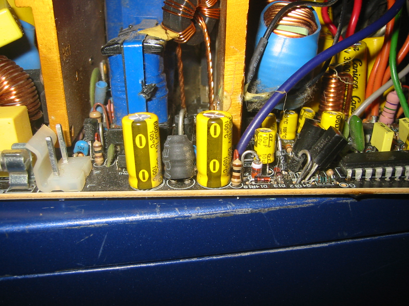

    and the 5vsb cap in question is likely the 50v 10uf one?

        Re: Ultra Xfinity 600w 5vsb mod
        it is... it is also near the 5vsb lead. also nearby are two 680uf 16V caps and a coil between them... dang I wish I was better at psu modding...
          Could we have a picture of the PCB from the back?
          • ratdude747
            Black Sheep
            • Nov 2008
            • 17136
            sure.
            the components I spoke of are all in the foreground.

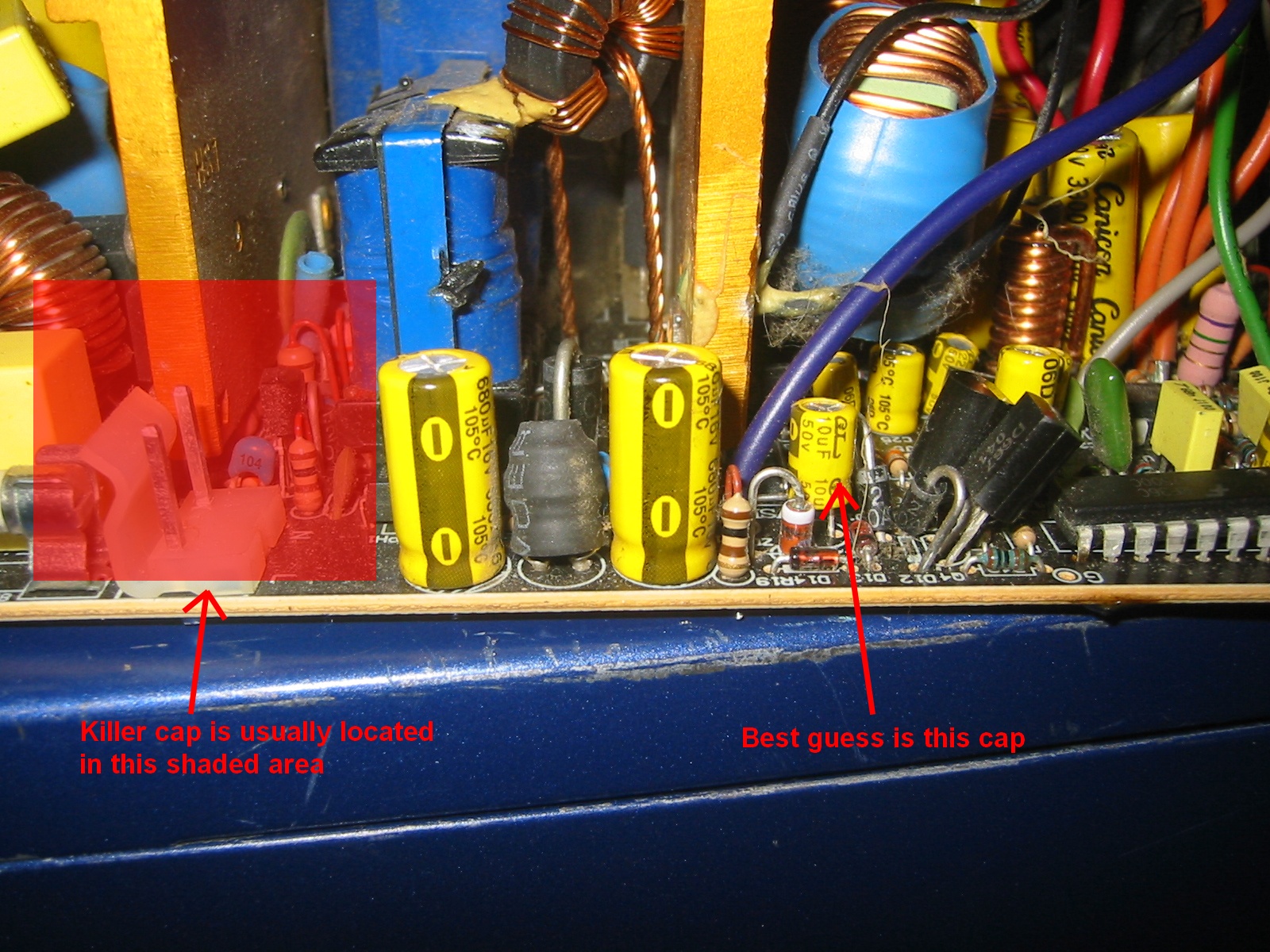

              That's an interesting design. the killer cap is usually located somewhere in the red shaded area of the attached picture, but if there are no small caps there, my best guess would be the 10uf 50v in front of the two bigger ones (the one I think you've been referring to)
                master hoarder
                • May 2008
                • 12164
                • Bulgaria
                That's the secondary side, not the primary.
                Killer cap is usually on the primary side, by the primary heatsink and 5vsb MOSFET as c_hegge mentioned. Not all 2-transistor 5vsb circuits have the killer cap, though. My Macron MPT-301 is an example of that.
                Flip the PSU board and see where the traces for that 50v, 10uF cap are going to. If you see them going to the opto-coupler by the 5vsb transformer, then replace it. And if you don't, replace it anyways - Canicons aren't that great.
                The two 16v, 680uF caps should also be replaced. 6.3v/10v @ 1000uF is usually more appropriate for that.
                I'm also guessing R19 (100 Ohms, right by one of the 16v, 680uF caps) is the minimum load resistor for the 5vsb. If it's connected between 5vsb and ground, then that's what it is indeed. 100 Ohms is a good value, but if you have a 1W resistor or higher of that same value, then replace that as well. I believe the one in the current spot for R19 is 1/2 watt - probably gets pretty hot. Not good for the 16v 680uF 5vsb filtering cap near it. 1W should run a bit cooler.
                  well jeez, replacing all the little caps in this beast would take forever... it is full of tiny caps.
                  i thought he said secondary, my bad there.
                  noting on the primary side, connected to pin 1 of the optocoupler is the positive lead of the righthand 680uf 16v cap and the coil. on the other side of the coil is the positive lead of the other 680uf 16v cap. the negative leads of both caps are grounded.
                  the negative lead of the 10v 10uf cap is connected to the coil ^ via a diode.
                  the 100 ohm resistor in question is between the coil and ground, looks to be the loading resistor.
                  also worth noting is that pin 1 of the optocoupler is also connected to a bigass diode, which is connected to the 5vsb transformer.
                  it looks like I found the wrong cap... suggestions?
                  edit- the other side of the coil is also the 5vsb. that resistor is in fact the load resistor, and the 10uf 50v cap is likely out of circuit.
                    ok, i think i more or less have the circuit figured out:
                    • the transofromer goes to the large diode, which acts as a 1/4 bridge, creatign pused DC power
                    • from there, it goes to pin 1 of the optocoupler, the input of the coil, and the positive lead of the capacitor 1 (680uf 16v)
                    • the other side of the coil is connected to a load resitor (100 ohm), the positive lead of capacitor 2 (680uf 16v), and the 5vsb output
                    • the two capacitors and the load resistor connect to ground
                    from what i see, the two 680uf caps are the killer caps, especially capacitor 2. they also suppress ripple, depulsing the dc power coming from the diode and transformer.
                    therefore, the only idea i can think of is to change the load resistor (more watts at the least) and to find some high temp 'lytics' for the two capacitors. Right now I have my list set to nichicon HE, since other circuits use that value; however, I may look for soemhtign more temp resistant.
                    my analaysis correct?
                              No, those are the 5vsb filter caps.
                              Looks like your PSU just doesn't have one, just like my Macron.
                              The 50v, 10uF may be for the VCC rail of the PWM controller.
                              Any good quality low ESR Japanese cap should be fine there. Panasonic FC and FM, Nichicon PM, PW, and HE, and Chemicon KY and KZE are what I've used in the past for small caps like that. I've also used them for the outputs too.
                              what I had always read is that if it is under 470uf, unless in certain cases, don't mess with it.
                              This doesn't apply for PSUs, though. It's better to evaluate each PSU individually.
                              there are 4 i cannot get specs on w/o desoldering them, 2 of which are buired between the primary heatsink and the driver transformer.
                              If this is a half-bridge PSU, then those 2 caps between the primary heatsink and the driver transformer should also be changed. These caps drive the switching transistors on the primary and they can diminish the PSU efficiency if they begin to develop high-ESR.
                              Those and the critical "killer" 5vsb cap are the only "small" caps I usually change when recapping a PSU. Occasionally, I also change the cap on the VCC rail of the PWM/supervisory IC if it's a really crappy brand (and by really crappy, I mean Rulycon and the like).
                              You don't need to change anything below 1uF either.
                              Replace the 2x 16v 680uF caps with 2x 6.3v 1000uF or 10v 1000uF caps. Should give a bit better filtering on the 5vsb circuit. Don't want to skimp on the 5vsb filtering caps, otherwise be prepared to have S3/Standby issues with your PC.
