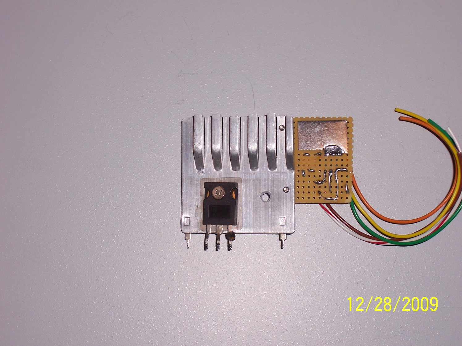

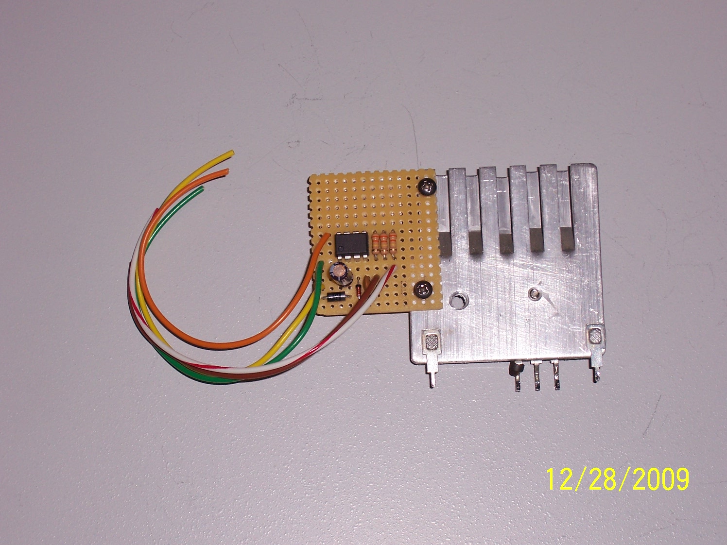

    The first step is to build the add on pwm board. There are several good chips out there to use and experiment with. Most of my experience is with the DM311, so that is the one I will show you. For attachments, here is the schematic of the DM311 add on circuit. Then two photos showing each side of the add on pc board, including a heat sink made from the tin lid of a peanut can. There are five wires coming out from this board, and I have colour coded them as shown in the schematic.
    If you decide to make a heat sink as shown in the picture, make sure the tin can material will take solder. Some tin cans have special things added to the metal and they simply will not take solder. The right material to use will take solder very quickly, and it will become obvious what is acceptable and what is not.
    The small board is cut from a larger piece of "perfboard" readily available from Radio Shack.
    These are the drawing and pictures I made when modifying a Bestec, and the add on board is shown mounted to the main switching transistor heat sink. I have seen this same circuit in Fortron power supplies.

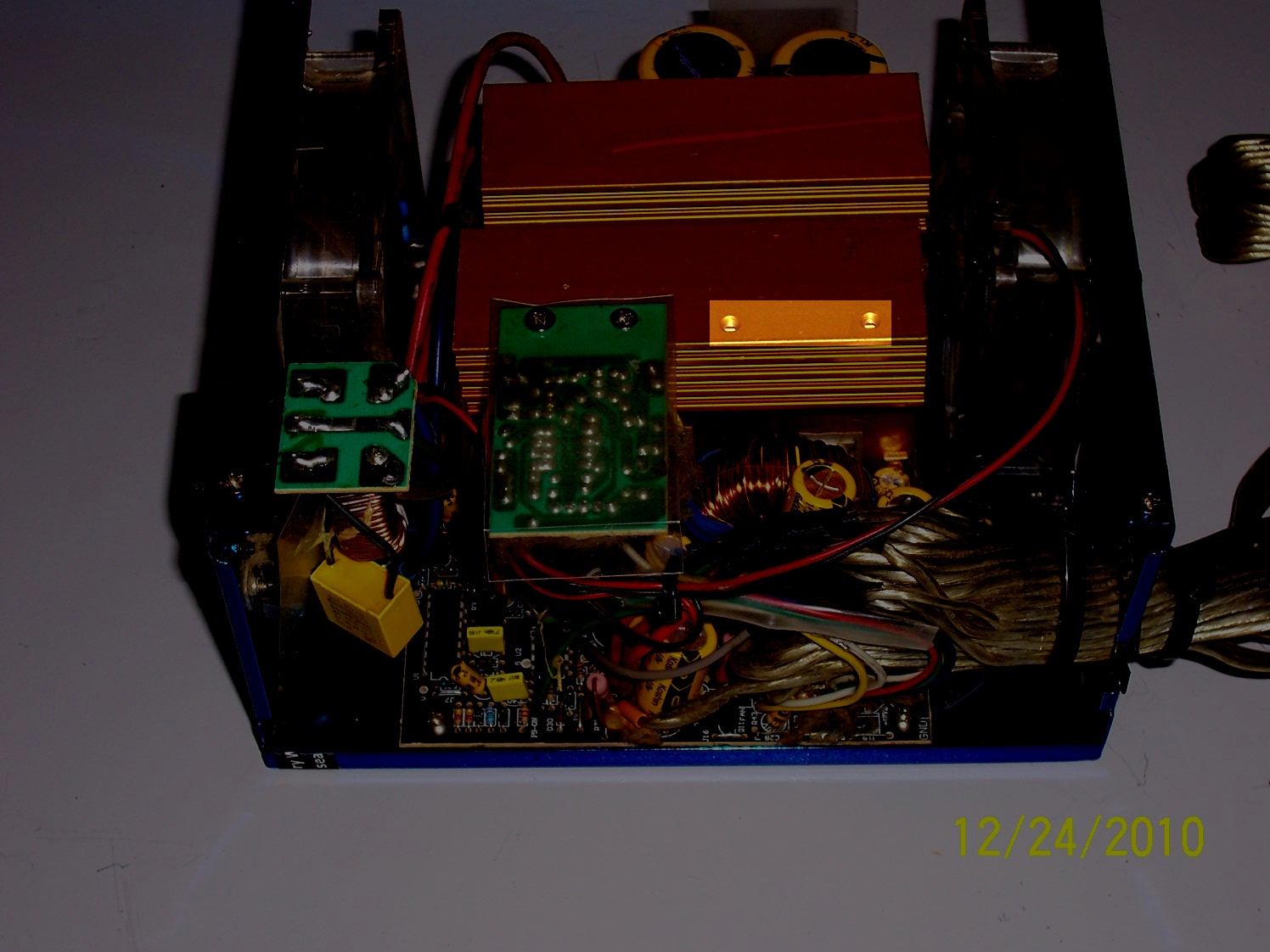

      I will probably bolt my board to the secondary heatsink, which already has tapped holes for use:
      I have yet to buy and order parts, once I have them I will begin.

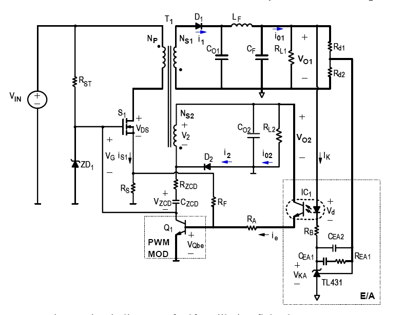

            Here are a couple of diagrams of the two transistor 5vsb circuit. Look it over and get familiar with it.....see how many of the components you can identify in your 5vsb.

              One of the first components you need to identify in the 5vsb circuit is the 5vsb transformer. On the half bridge power supplies, the largest transformer is the main switching transformer. The middle transformer is the driver transformer for the main switching transistors. The remaining transformer is the 5vsb transformer.
              The 5vsb transformer has three windings:
              the switching coil driven by a transistor (or FET)
              the feedback coil
              the 5vsb coil
              The attached drawing shows two basic types of 5vsb transformer used in the half bridge power supply. The switching coil and the feedback coil are the same, but the 5vsb winding is sometimes a tapped coil which drives 5vsb and other circuits.
