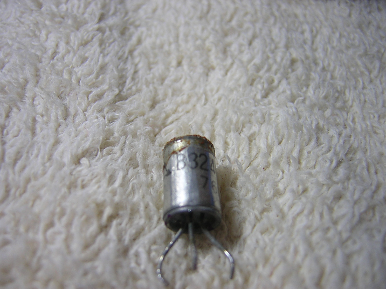

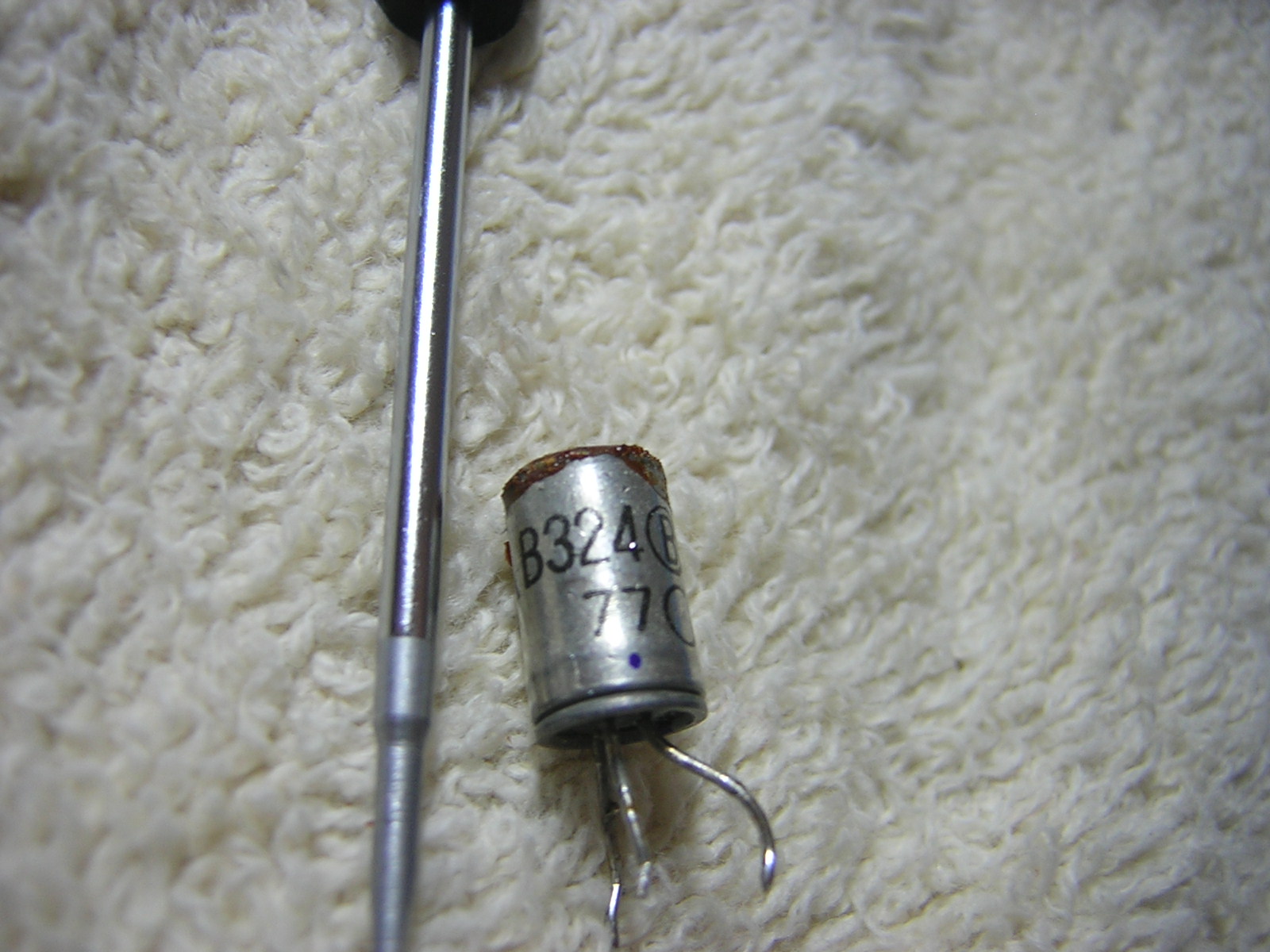

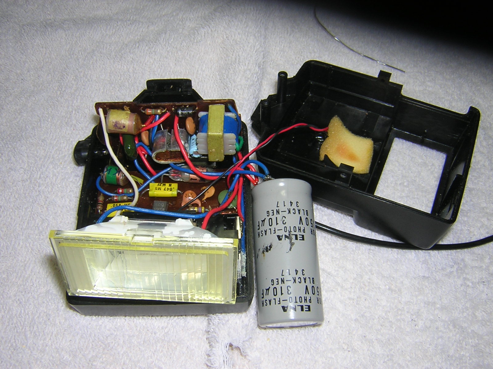

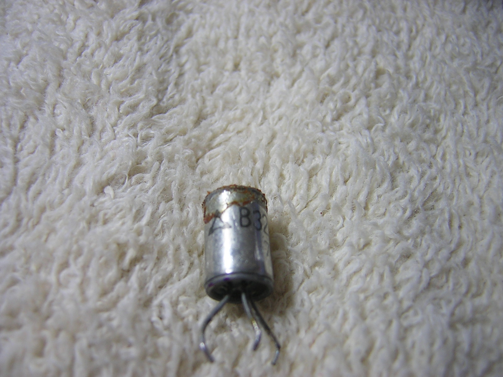

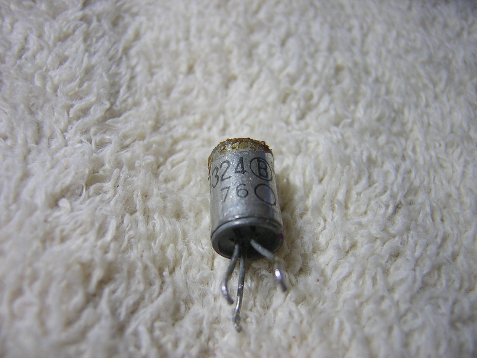

    hi,
    My dads flash for his camer quit working. I opened it up and found what looks to be either a bjt or mosfet in a radial can with some "junk" on the top of it. So i am guessing this is the problem part.
    Problem is i need to find this part on-line and i am having troouble doing so. Can anyone identify this part for me?
    see enclosed pics

      Re: Flash for camera quit working.
      that's a 2SB324 Germanium transistor ( PNP, 32V, 1A, 0,22W).
      they're not produced anymore and the proposed replacements are neither, but there are a few (NOS) on eBay for a few bucks.
            W101
            That is a golden oldie. About 30 years minimum?
            Something to try.
            When electronics get that old, oxygen takes it's toll.
            Dump the caps. Those things can hold 300 volts at a good amount of current.
            Measure the resistors and see if they are still in 'spec'. Bet a number of them have drifted.
            Also clean the heck out of the circuit boards. Use a good grade of Isopropyl Alcohol. You want them clean enough that there is zero visible contamination on the board. I use a cut down paint brush and old paper towels to soak up the gunk that comes off the boards. You will be amazed how much stuff comes off the boards.
            What happens is that old flux tends to get conductive over the years changing the constants of the circuit.
            Clean the board and measure the resistors again.
            Remove and replace any that are no longer in spec.
            Old resistors react with oxygen and drift in value.
            Please do what Krankshaft said.
            Check the transistors.
            Since they are old tech Germanium, if memory is any good, they will read different than silicon transistors. But exhibit the same 'diode' type junctions. Expect leakage to be higher as well.

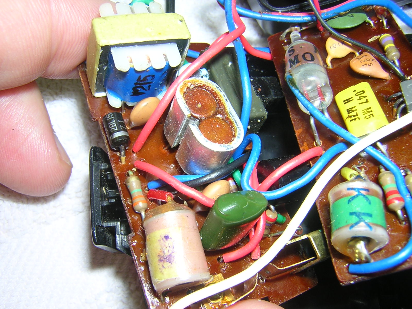

            As for the 'brown gunk' on the two switching transistors.
            In the day these things were made, using glue was the easy way to mount parts. In the photo you sent, glue was used to make sure the heat sink was going to stay put on the two transistors.
            That brown gunk / glue gets conductive as well.
            It also chews up copper.
            Might pay to remove the glue and inspect what is under it.
            Products like this and consumer goods were not built for the ages. Five or seven years was service life, then it was time to 'get a new one'.
            So when it was made, all this stuff was normal and nobody had problems with it. Now it's old and the parts are suffering.
            Much luck.
