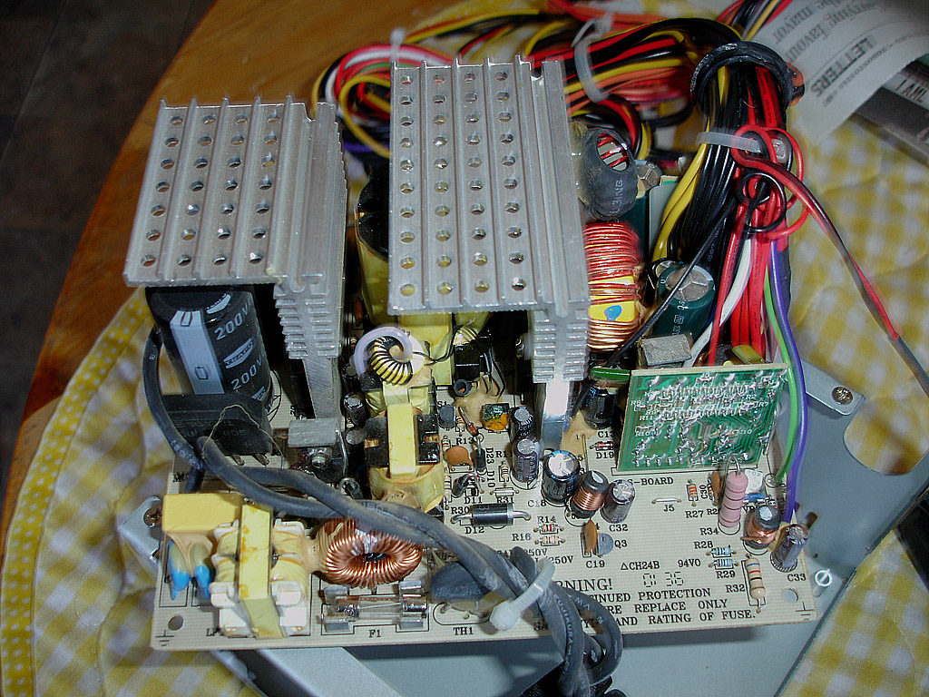

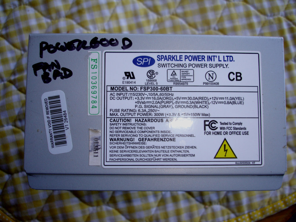

    I was using this on a P3C-D board, I put the box away for a while, got it out yesterday and no response when I attempted to power on.
    I substituted another PSU and the machine booted up, so this PSU has a problem,
    I tested continuity in the plug, OK. Measured ESR of all caps, OK.
    Measured ESR of the "yellow suitcase" which I believe is the X caps = 13.54.
    The blue tantalums do not read at all on my ESR METER.
    Nothing appears burnt or bulged.
    I wrote the note re the Fan. It was pretty anemic, but I verified and it is not shorted. I tried the PSU in and out of the case.
    Any ideas? I like the fact that this PSU has the extra P4 connector.

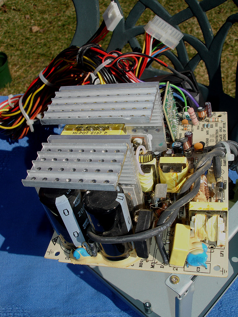

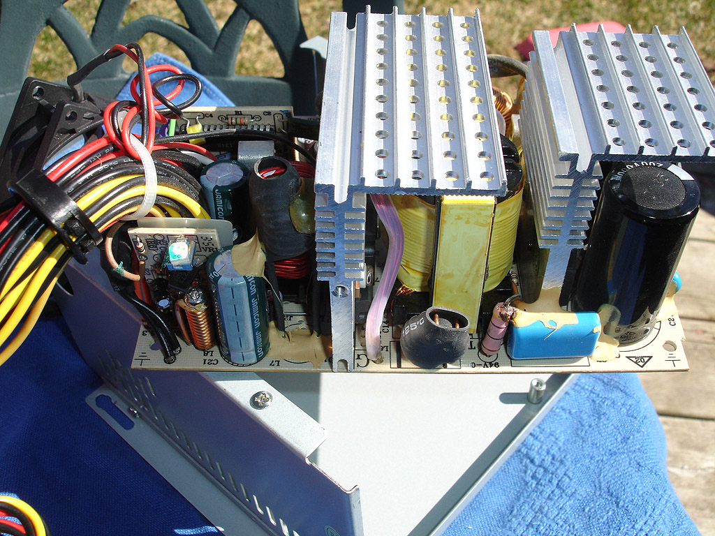

          The standby supply in this unit leaves something to be desired. Back in '05, I found some high-res images of this supply and the 'ATX-350-60PN.'
          Compared to the 350, this one has:
          Transistor for standby power on a tiny little bracket instead of main switcher heatsink
          Components cramped around bracket and resulting hotspot
          Board discoloration around bracket in units that have been in service for a year or so
          GLUE!
          Go directly to the standby transistor. There will be a resistor from the emitter or source to the negative side of one of the big caps. If that transistor shorts from improper bias resulting from the 'critical cap' getting high ESR, that resistor will open.
          Regardless of what you find, please save yourself the trouble and aggravation and remove that glue! It's all over the DC link cap in that one pic, covering the top of the primary snubber resistor. See how it burns and gets crispy? It also gets conductive! Don't be afraid to remove all the components for the standby supply to clean them, as well as the board.

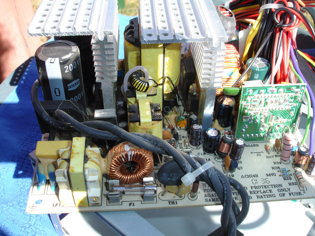

              I've removed plenty of components and cleaned them and the board underneath of that useless glue. More supplies use it than don't.
              If I go to the trouble of recapping, that junk goes. It's a guaranteed problem- not if, but when. Between primary and secondary isolation barriers and across MOSFET gate and drain leads are the real 'hotspots.'
              Is your 350-60PN missing any PI-inductors? I just love how all the caps are on top of each other, with load resistors jammed in there... Remove them. Then just use an old HDD to test the unit out of the 'puter. Or a bunch of 12V bulbs, or a headlight. Those old ignition coil ballast resistors are great for loading 3.3 & 5.

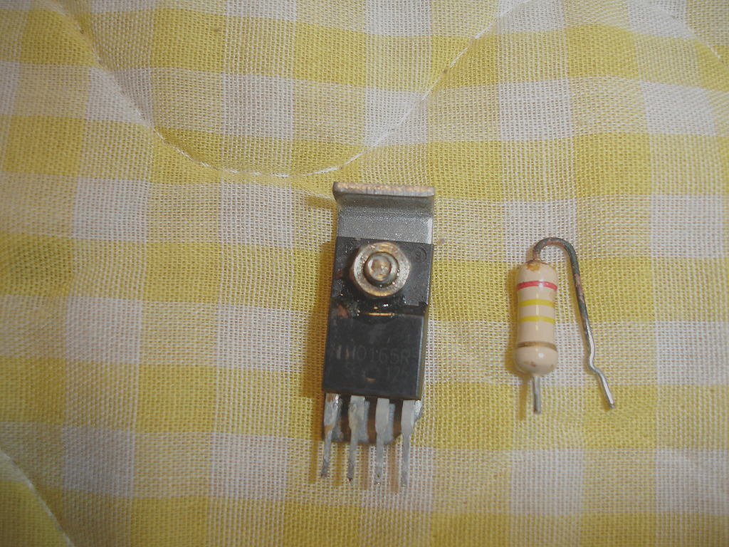

                I have finally gotten around to removing the standby components as per attached pic.
                Many thanks to Everell and Kaboom for your suggestions.
                Both the original and the replacement part number are obsolete at mouser, but there are Ebay Hong Kong listings for both parts.
                My problem is the resistor. As you can see the wire has gotten really hot.
                Can someone identify this resistor for me so I can find it on mouser?
                I am assuming both parts are burned out. I will be replacing all the caps on the PCB.Thanks again.
