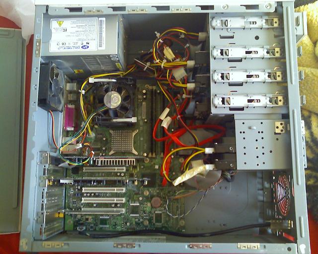

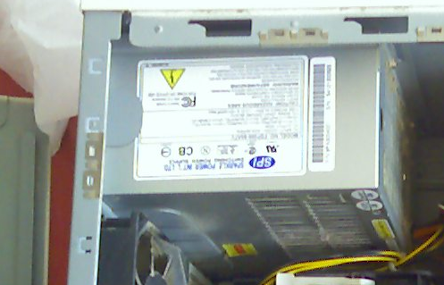

                    If you still wanted to know what one of my old PSUs was i found some pictures.
                    and i think this would be the first one its still got the origninal price tag on it.

                      SPI's are FSP.

                          It's a company. They also go by the names of Forton Source, Sparkle, SPI, and FSP. Their power supplies are generally very good.

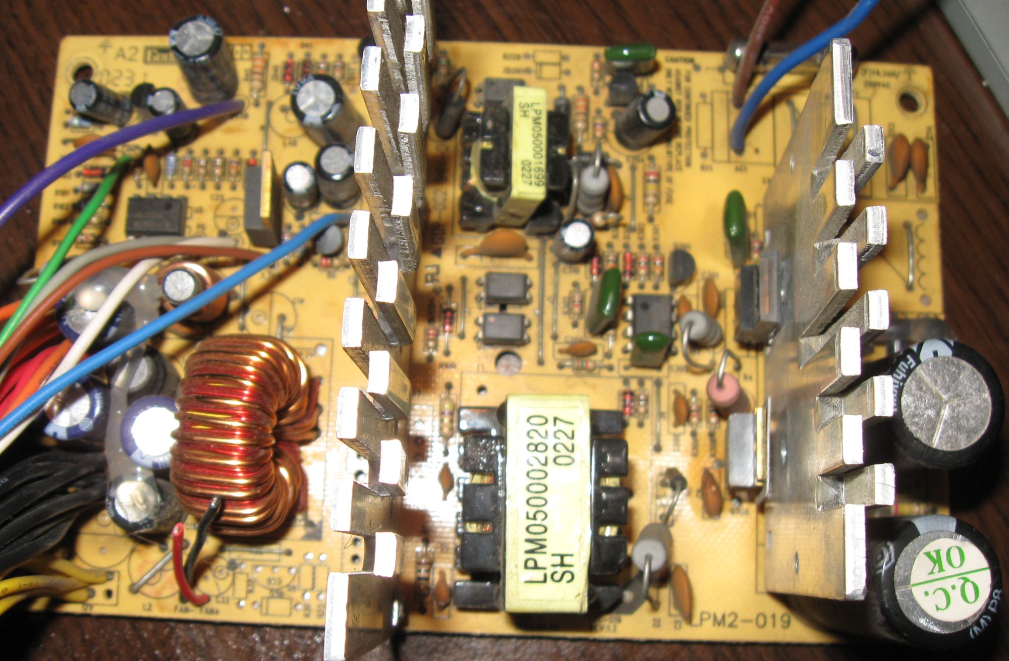

                                          Here, people don't throw much stuff away and usually when they do it's straight to the general garbage bin near their apartments so I don't lots of places to grab electronics from.
                                          One place I do have luck from time to time is the mall about 2 miles away from me - there's a store there that has a transparent plastic bin where people can usually throw broken electronics and two other bins for batteries and light bulbs.
                                          So I was a bit lucky when I found a crappy power supply that used to be sold around these parts about 4-5 years ago with cheap cases and two laptop chargers.
                                          So I opened the PSU but the person that had it before me already went through it - for some reason he/she pulled out the secondary diodes and the fan... But whatever, here's the pictures:

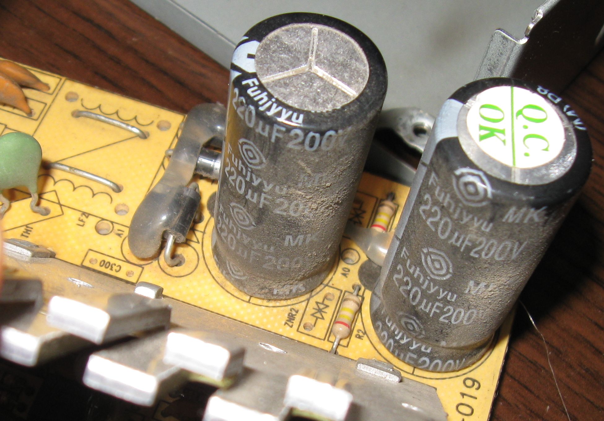

                                          Yeah... 350 watts my ass... notice it says LPM2-20 on the label but the PCB below says LPM2-019
                                          No input filtering (or some, if you qualify the parts there as filtering), no bridge rectifier (not even bothering to check the A rating on the diodes), ... the primary transistors C5353 something and 07N70CP / 224091 ... secondary diodes missing.
                                          Main transformer appears to be size 28, not even 33.
                                          2 x 220uF 200v Fuhjyyu MK (85c rated)
                                          No inductor on 12v ... I think a 470uF 16v on 12v, 1000uF 10v on 3.3v and 5v
                                          Playing with the esr meter, the 200v caps measured 190/0.19 and 196/0.15 ohm
                                          The 1000uF 10v measured 1237/0.06, 1100/0.05, 135/3 (swollen)
                                          Three random 470/16 i pulled including the one that was on 12v measured all ok, 475 uf or so, 0.08/0.08/0.2 ... so probably that one on 12v was a bit weaker
                                          Gonna test these two another day... might even work, who knows. Reluctant to try them without some fuse/short protection
