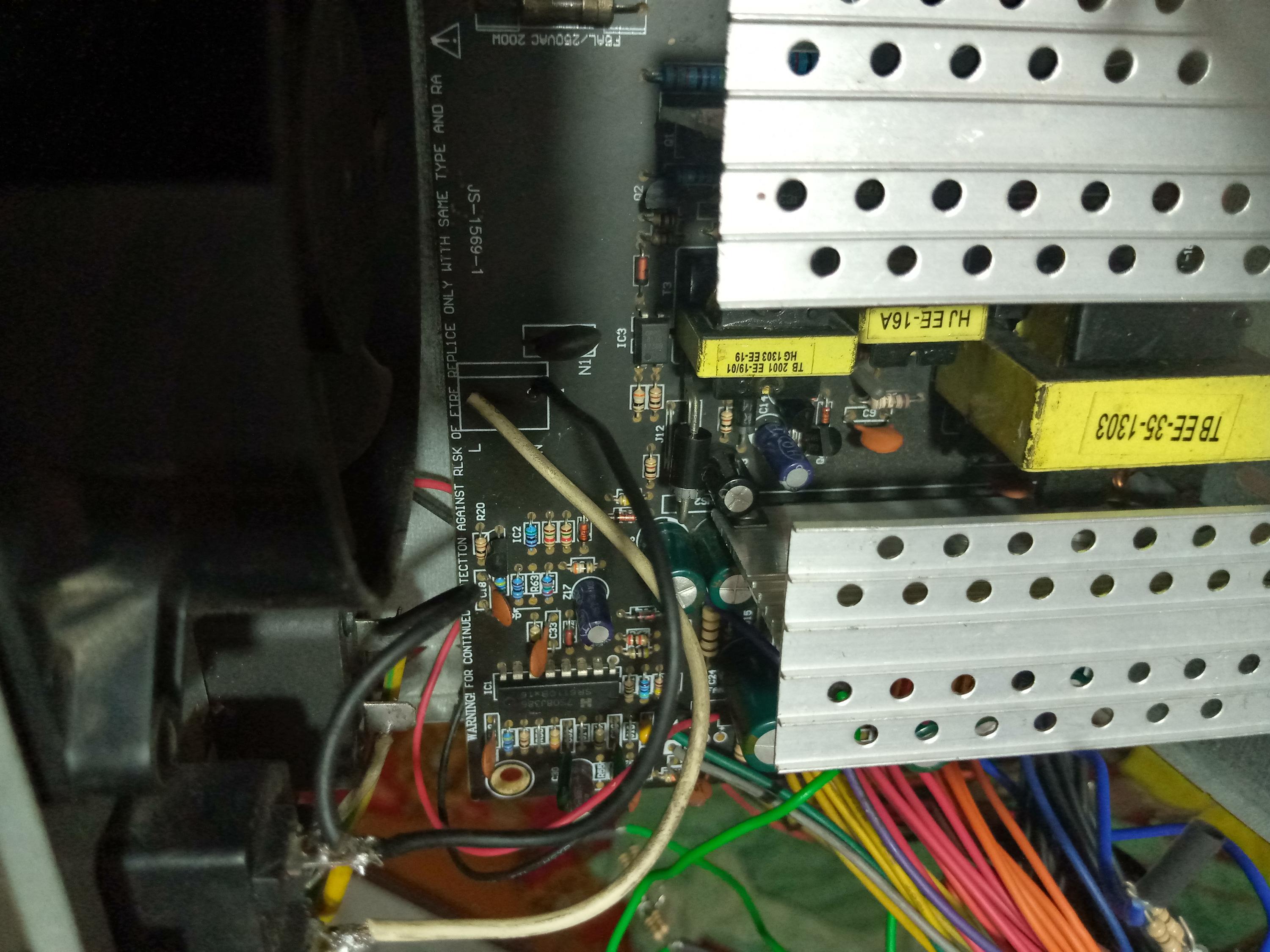

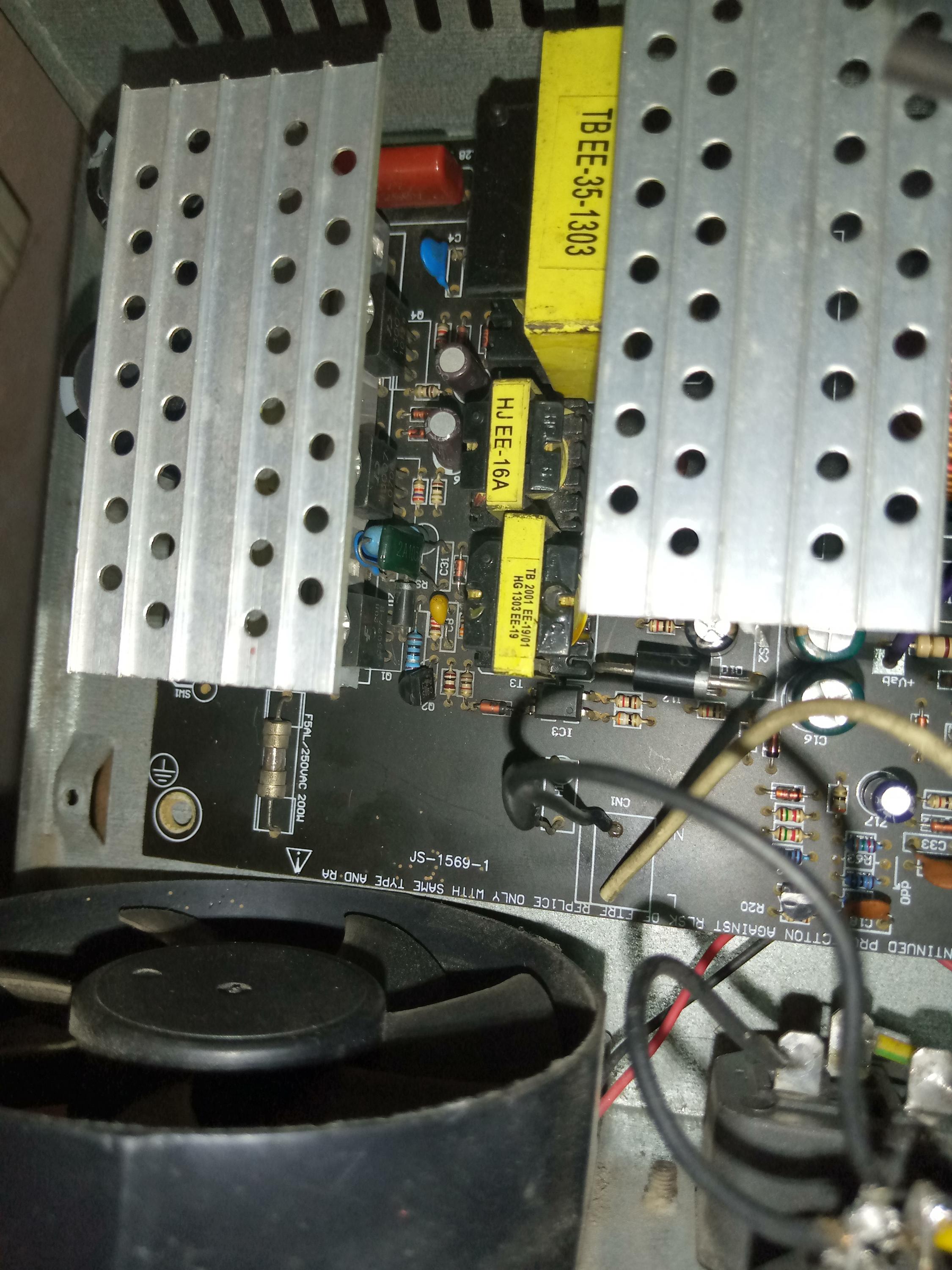

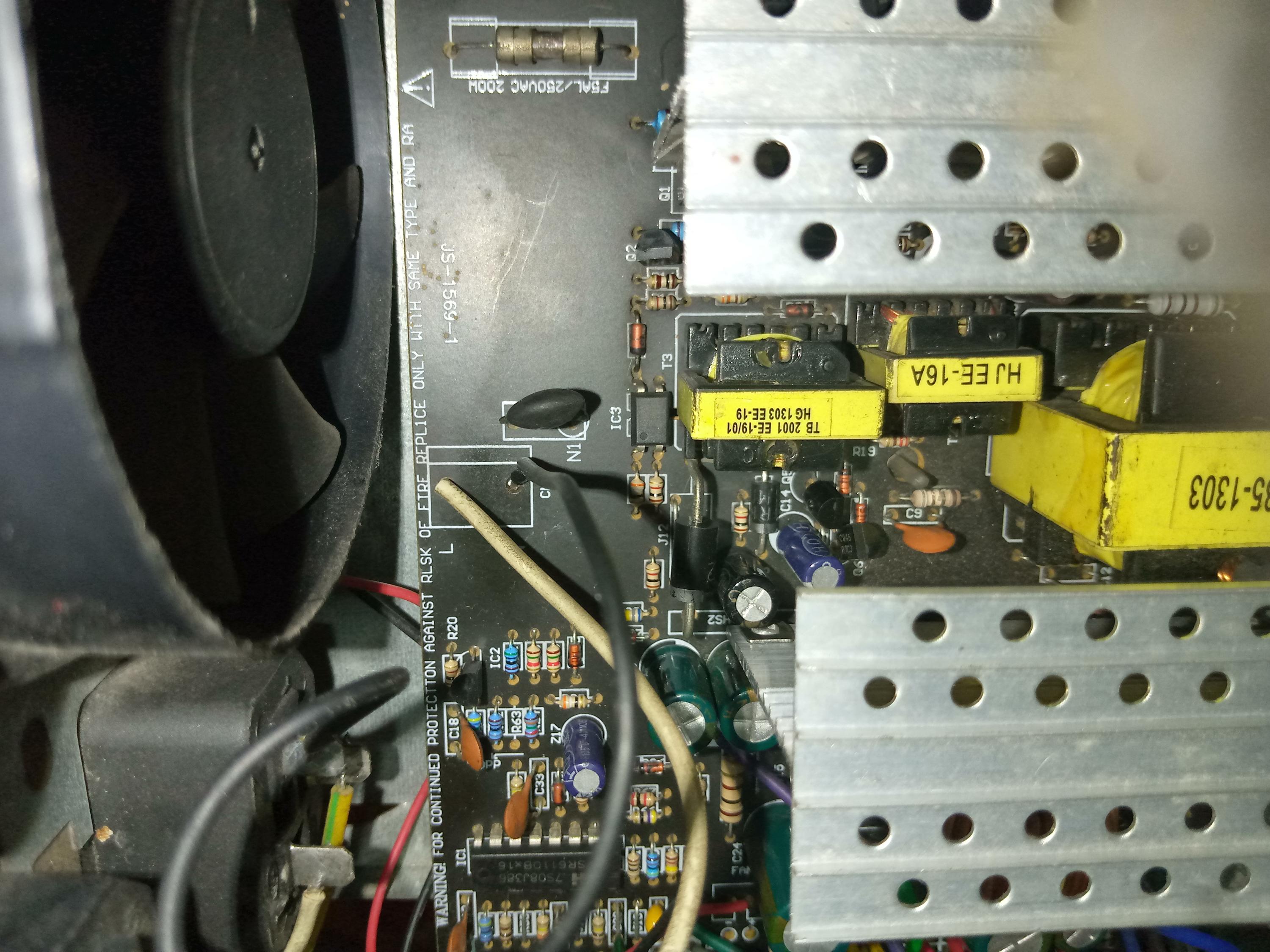

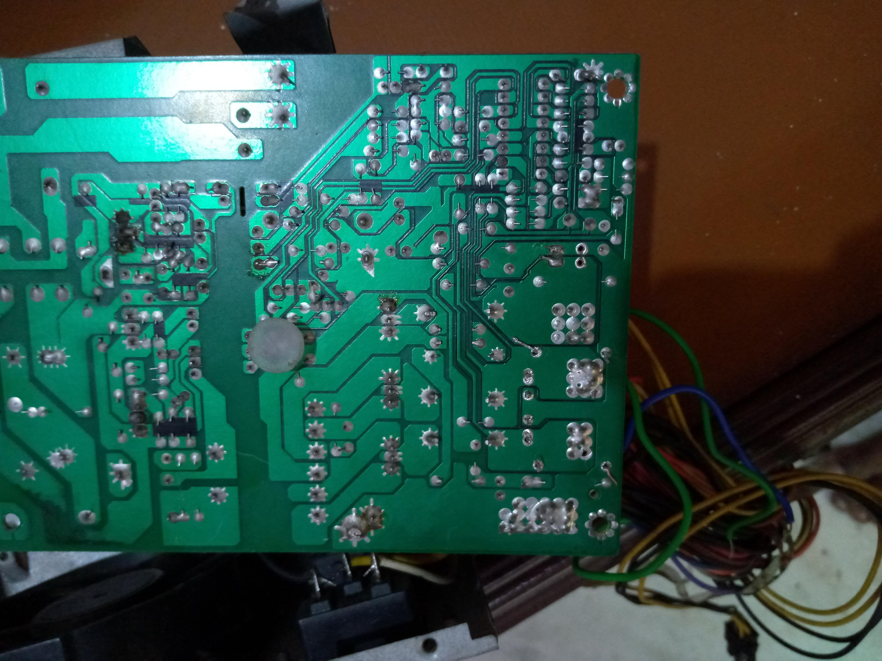

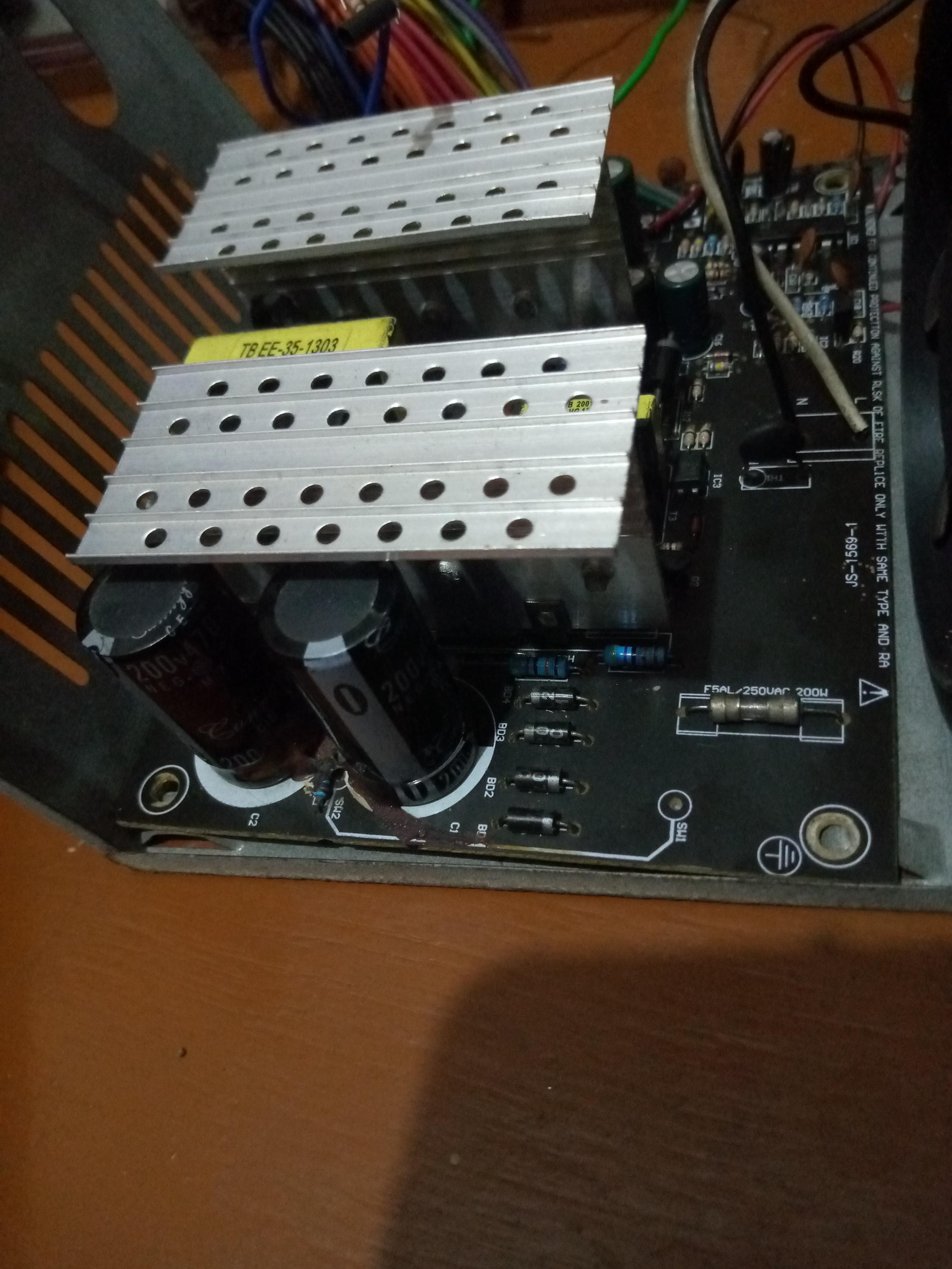

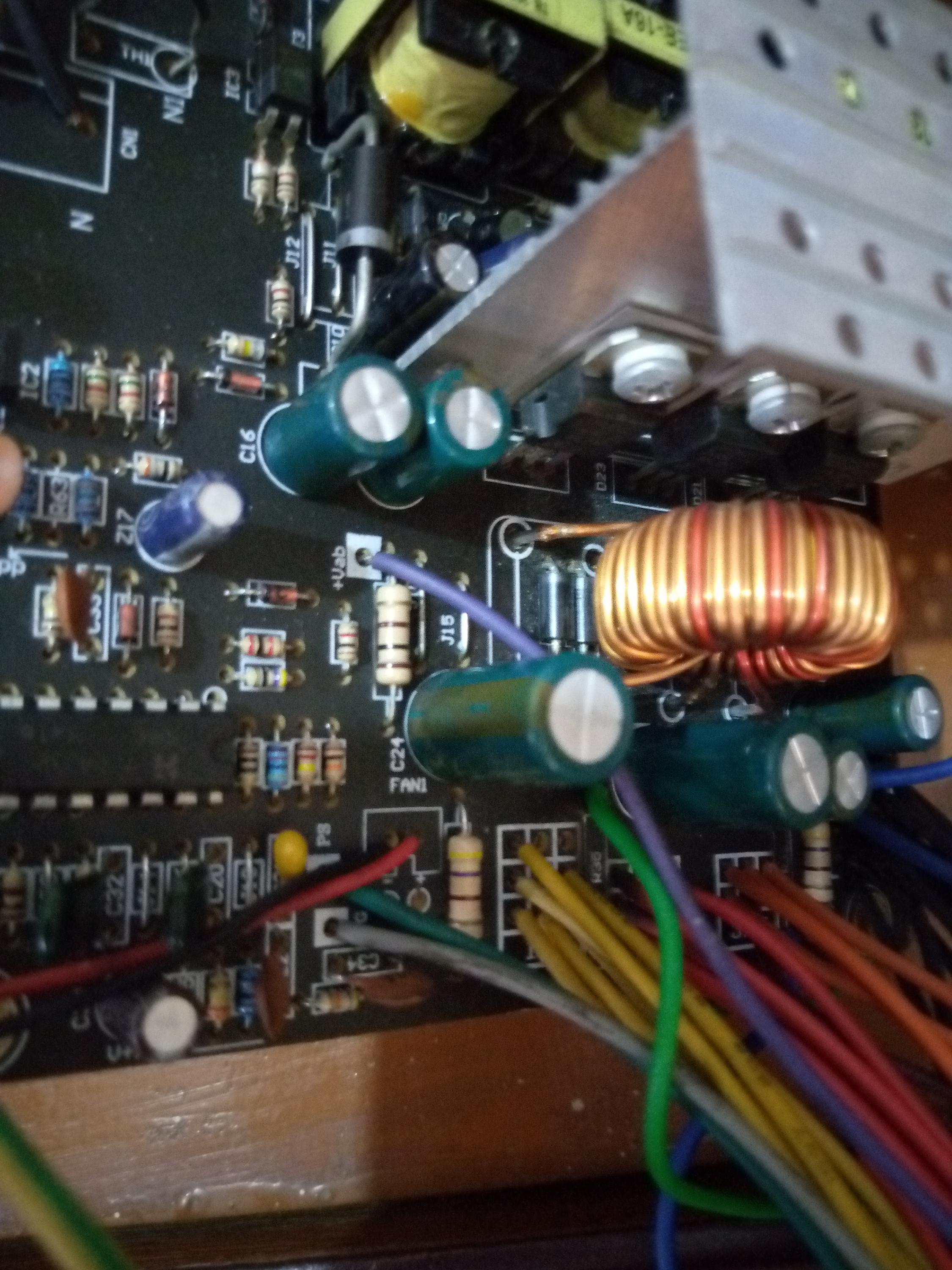

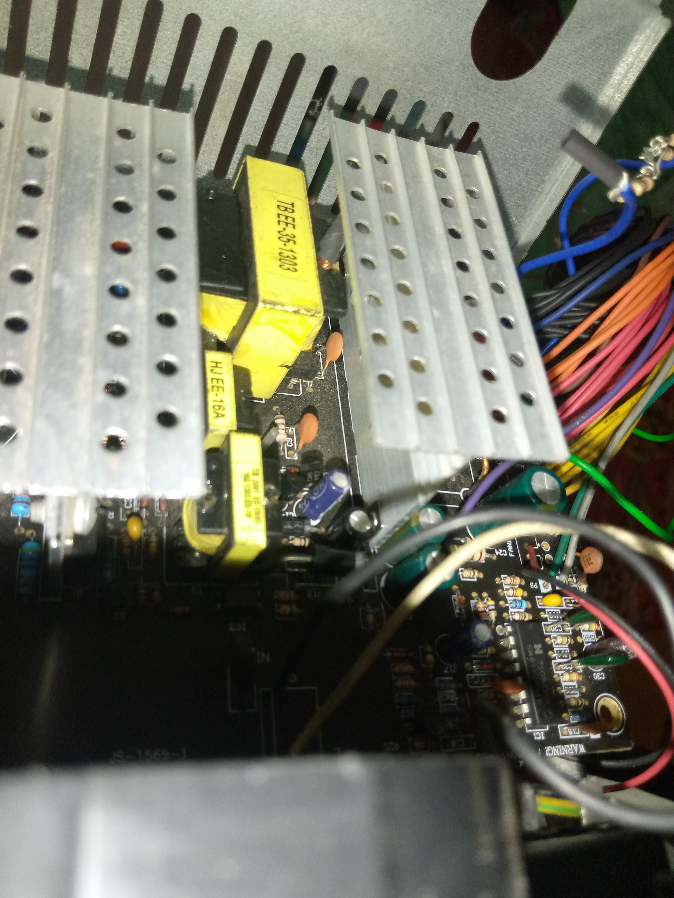

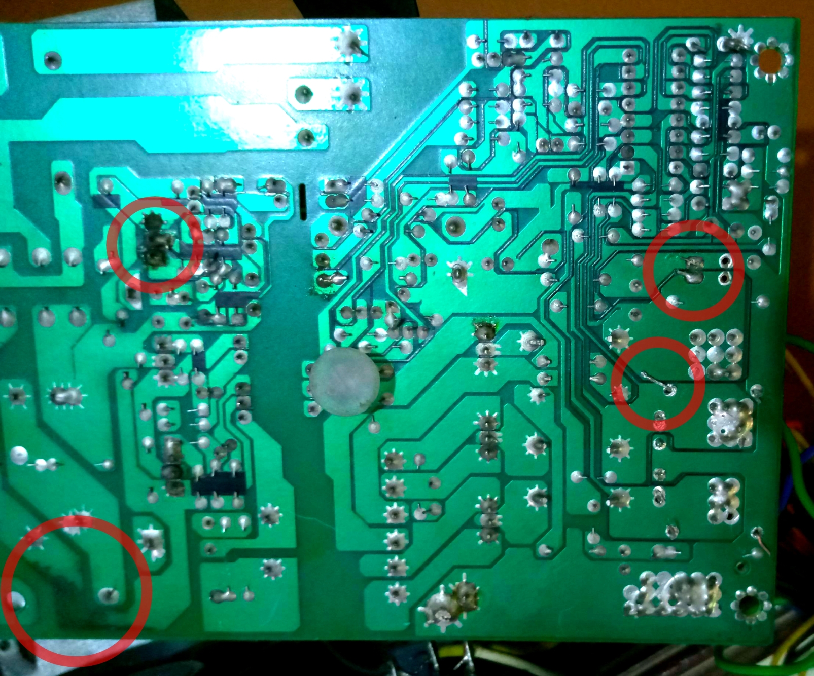

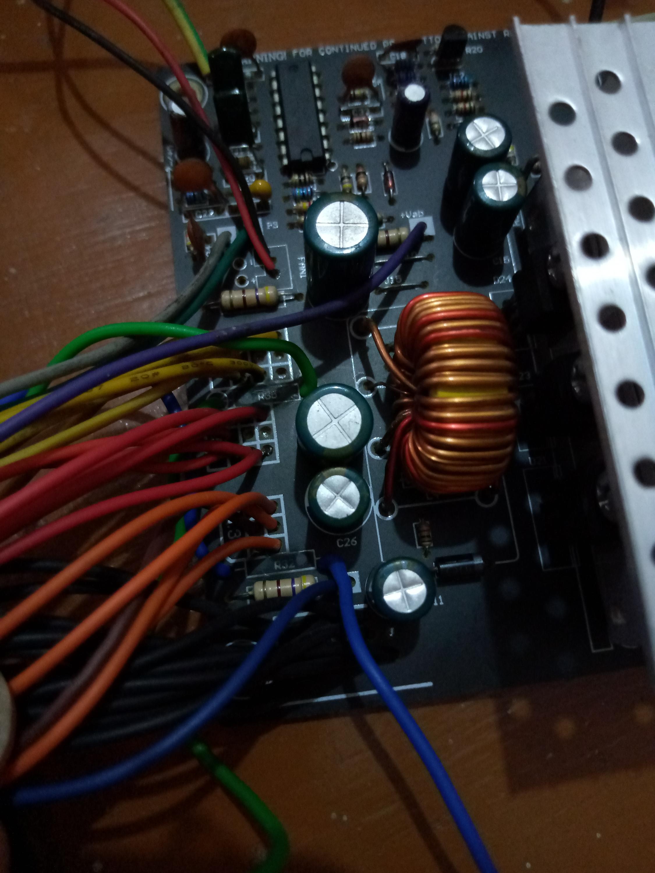

    hello everyone , working zebronics power suply 450 watts , 5v ,3.3v givin short to ground black wire, also in circuit at output, resistor was charred but shows right values , after removing resistors 39ohms, 51 ohms, there was no short , no continuity beeps with ground , but after replacing new resistors (now i am not switching it on) ,again short still exists . when i put bigger ohm resistor like 100k ohm , no short beeping sound comes , lower ohm resistor gives continuity beeps ,other big ones donest , as its a working psu , i am confused what to remove now or how to go further now .
    how this happend - i was putting a bad sata cable extension which blew the 12v/5v diode(not sure) in hdd pcb ( repaired it -working now) and made this short in psu , how to remove the short , thank you .
  • playit
    • Feb 2020
    • 182
    • india

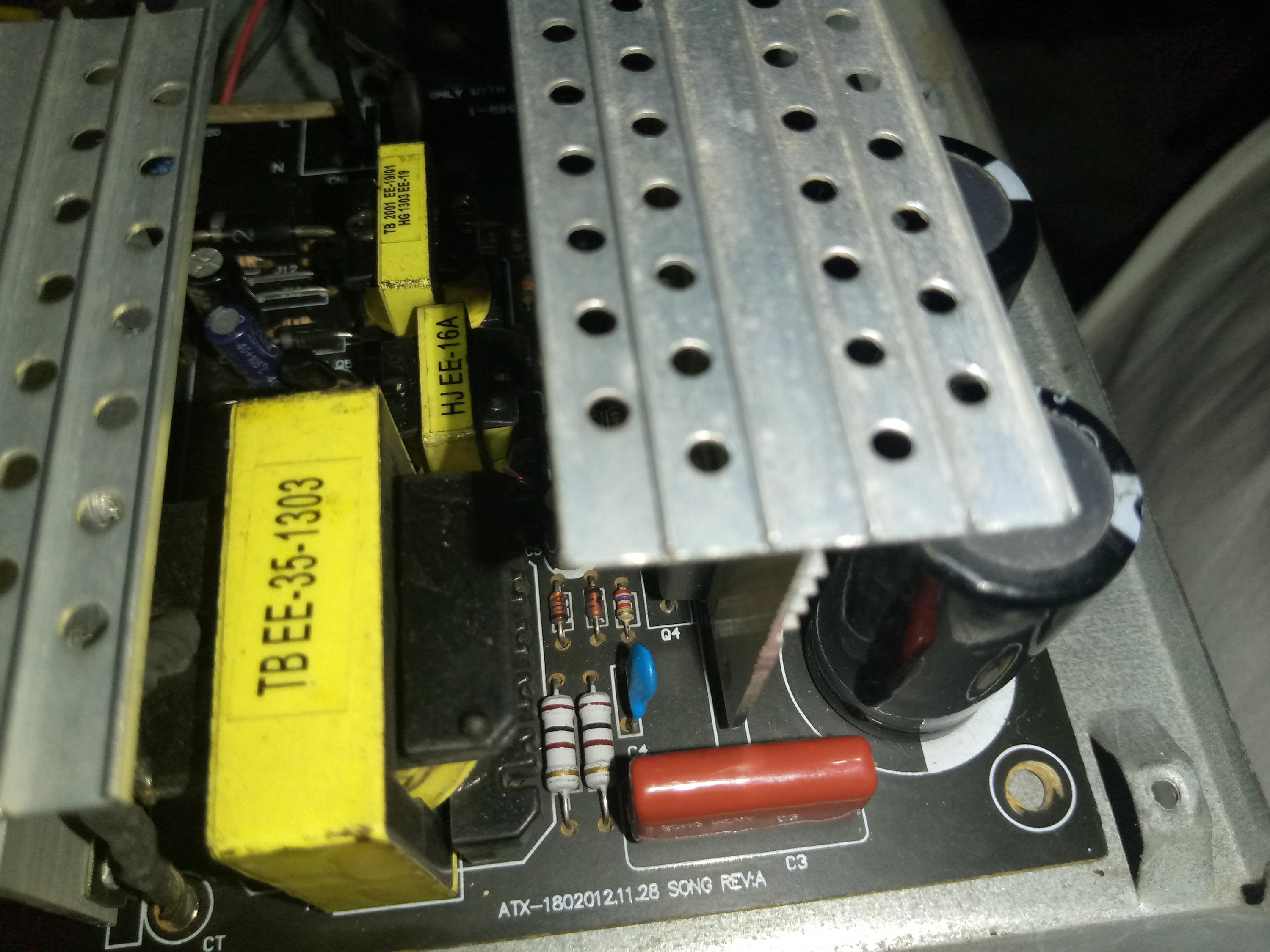

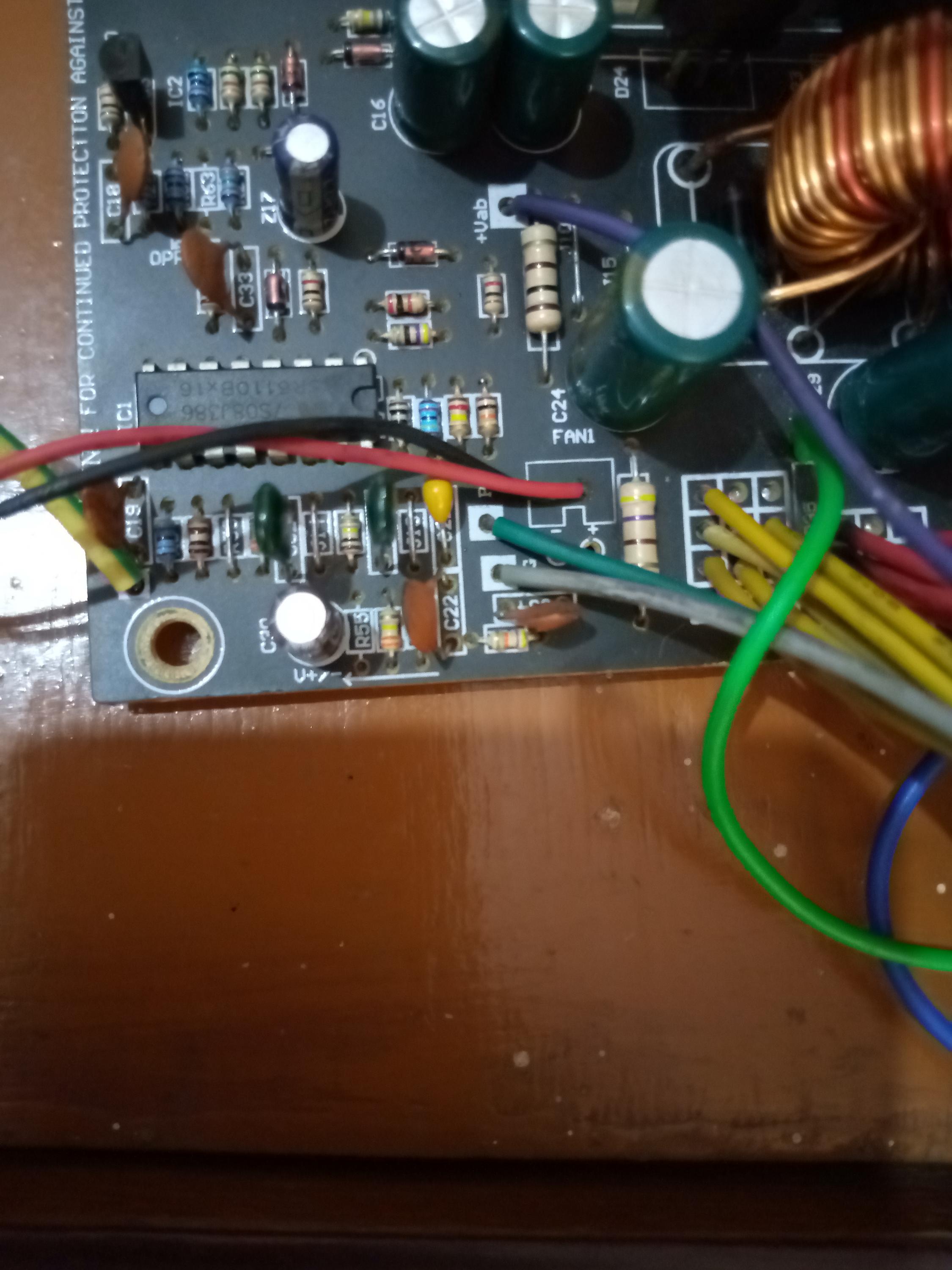

    Re: 450watt power supply 5v, 3.3v short to ground wire,in output rail ,connectors
    uploaded the pics , please ask for clear shot of any area if unclear, thank you.
        I believe you are misinterpreting your multimeter's continuity (beep) function.
        Beeping does NOT mean short-circuit. Most multimeters will beep to show "continuity" when the resistance is relatively low. This can be anywhere from 20 to 100 Ohms, and varies between different model multimeters.
        So you are getting beeping because those 39 and 51-Ohm resistors fall within the "Good continuity" range of your multimeter. But in reality, that' NOT a short-circuit... or good continuity for that matter.
        Instead, measure the resistance of the 3.3V and 5V rails with respect to ground using your multimeter's resistance test function (200 Ohms scale if using a manual multimeter), so you can verify yourself about what I stated above. You should see around 39 Ohms on the 3.3V rail and 51-Ohms for the 5V rail. These are the minimum load resistors on these rails to keep the PSU regulation in spec at very low or no-load condition.
        All of that aside, I actually DO NOT recommend you fix this PSU for computer use. It looks like every other cheap garbage PSU that's been showcased on the website here. 450 Watts? - NO WAY! You'd be lucky if this thing even provides 100 Watts of power with the ripple in spec. It has too few and too tiny electrolytic caps on the output. And that's not all that's wrong with it. Output toroid is too small, the heatsinks are very thin, and by the looks of the lead spacing distance on the underside, the primary caps are probably 2x 330 uF... or 470 uF units at best. Being such a cheap PSU, though, there is also a high likelyhood that they have fake ratings and are probably 220 uF each or lower. I have a few cheap PSUs like that, and their primary caps are not even reading 220 uF. Very low quality stuff.
          Whats is going on with green wire, ps-on... is solder ok, and cut the tail.
          First of all, have you fuses ok, AC on board present, bridge ok, high dc ok... standby voltages 5vsb steady... I do not understand in which way you tested psu to come on conclusion not working? What reading you get?
          On pcb, it is some dark area in primary side, check this also.

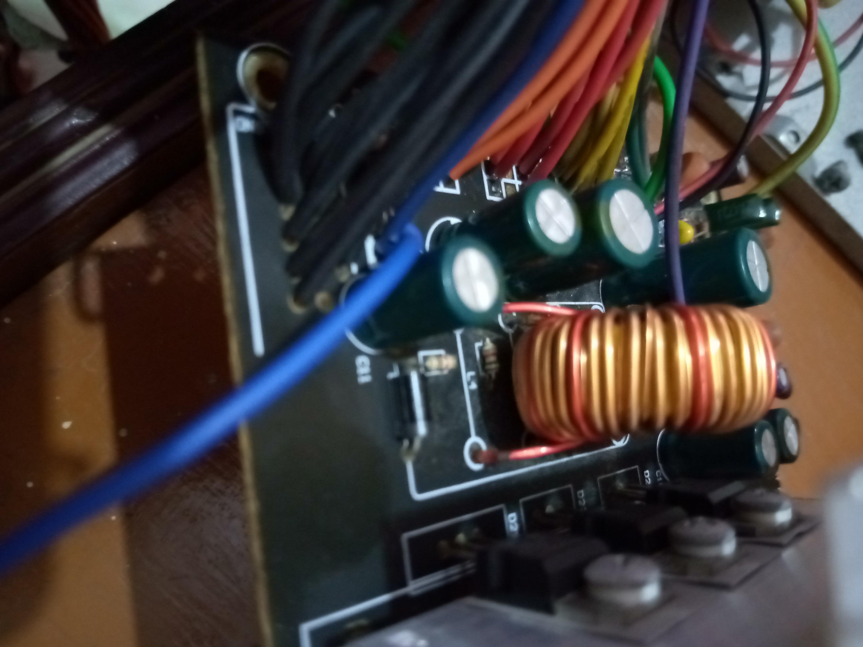

                by the way as its so subpar in its design , any way to keep a protection circuit or modify to some extent by changing some parts ? i know i lack too much of knowledge , but just curious to learn more if anything can be done at all .
                The protection circuits are usually OK even on very cheap PSUs like this - at least the basic ones, like short-circuit protection and under-voltage protection.
                What you can improve on is the output filtering. Notice there is only 1 electrolytic cap per output rail. Most PSUs with this old half-bridge design and relatively low switching frequency typically have more and bigger caps on the output. The most common / standard arrangement back in the day of these designs was 2x 2200 uF for the 3.3V rail, 2x 2200 uF caps for the 5V rail, and either 2x 1000 uF or 1x 2200 uF for the 12V rail. Also "PI" coils (inductors with a ferrite rod core) between the caps. This greatly reduces R+N on the output, and also makes the output voltage more stable.
                Other improvements you can make: add common-mode choke inductor on the put side, X2 and Y2 -class caps, and increase the capacity of the two 200V caps (470 uF minimum would be nice.) If you know of an e-scrap place near you... well probably best to look for a scrap ATX PSU from a Dell, HP, or other similar brand. Again, these would be better PSUs than what you have. But if not, look for old TV boards from the 90's and early 2000's, especially anything from Sony. These will usually have all of the parts to add to the input filtering.

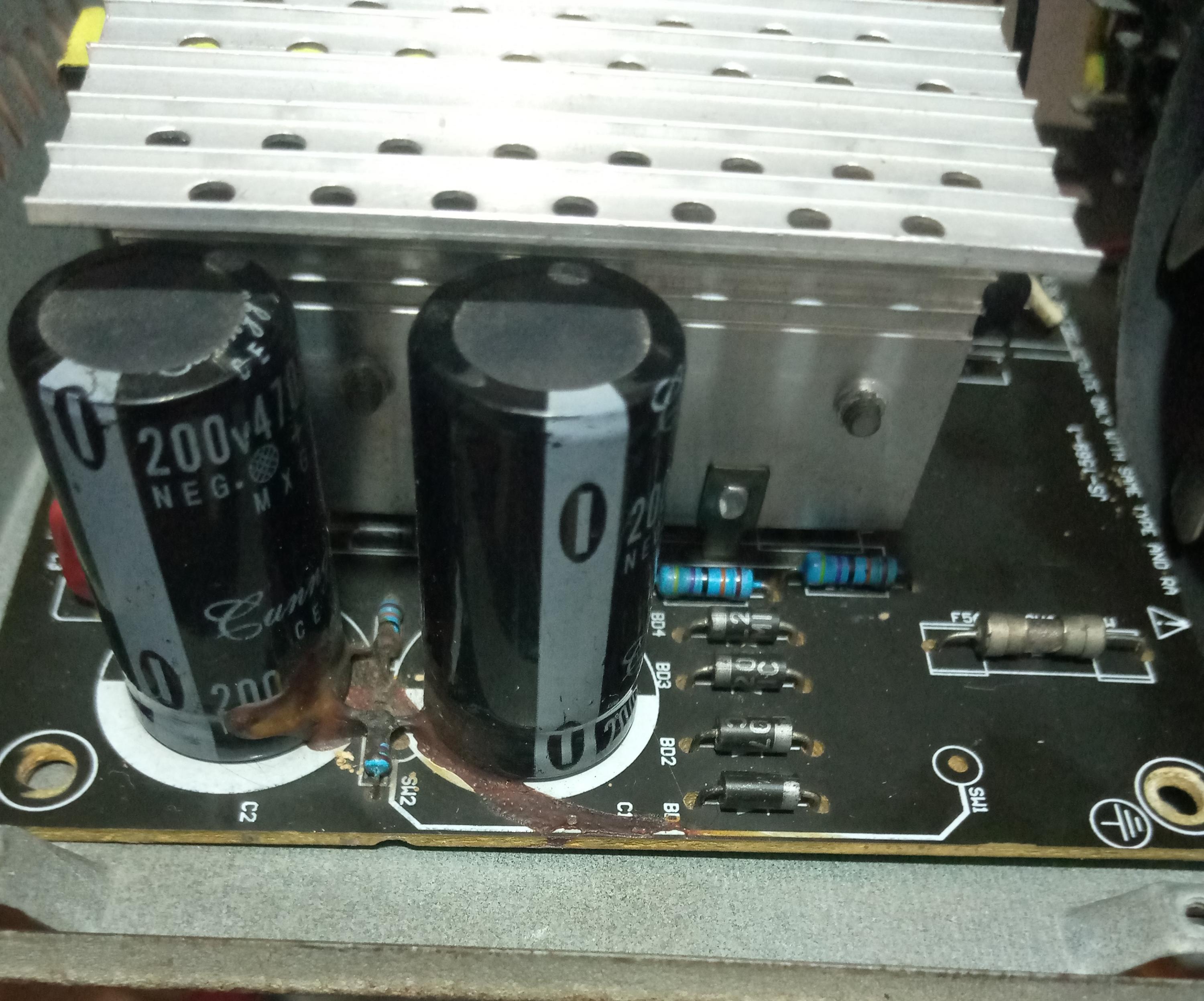

                    i tried to plug in dvd writer and see how it goes , my pc is running in different psu , and i powered this dvd writer with this psu with out sata cable first , it ran ok, it opened all good , but when i put sata cable in dvd writer and switch on my computer the psu fuse is blown and i first dint know its a fuse , i tried it again , the spark came again at fuse site , what could be the reason for this ? all the voltages were good and stable but when i tried with sata , this happen , could it be bad sata cable ?
                    i opened , i found a little screw stuck to the first pair of diode track at input side ,sighs, but how did it work with the screw stuck back at circuit touching the case down ! but only when i put sata cable from computer to dvd writer , it went spark and blown fuse and now those 2 diode pairs too gone .. please teach about this what happend, thank you.
                        Sorry, but nothing much I can teach you here.
                        You had a screw loose inside the PSU, and that is NEVER a good thing.
                        Most likely the screw wasn't shorting anything - VERY likely by complete luck - while you tested it with the DVD drive. And then when you tried to use the SATA cable, you either moved or bumped the PSU very slightly, and that caused the loose screw to go in the wrong place and short out... whatever it shorted out.
                        And no, a bad SATA cable or any other output cable should NOT cause the PSU to blow up. If by small chance it did, then the PSU wasn't worth using anyways. I understand certain things can be very challenging to find is some parts of the world, hence why some places are stuck with these cheap nasty PSUs (for example, I know many parts of Eastern Europe used to be filled with this cheap PSUs back in the 90's and early 2000's, and there was rarely anything better to buy.) But these cheap PSUs are a false economy - they don't and never were meant to power anything more than a low-end Celeron or Pentium dual core.
                        With that said, still keep your eyes peeled for scrap parts and/or local sites for used parts. Also don't worry that AliExpress is not available in your country - too many counterfeit/overrated transistors on there anyways. I bought a bunch of E13009's for repair of cheap PSUs, and all of them were counterfeit and couldn't hold even up to genuine E13003 spec. Total waste of time and money, but I expected that and bought them most just to see how bad they were.

                            Yes, if you want to repair it, please post pictures so we can see better what happened.
                            RL207 - that's more than likely a diode from the bridge rectifier... and a bit undersized for the task. No need to replace it with same exact diode, just one with similar or better specs, i.e. 600V DC blocking voltage or more and 2 Amps (3 or more preferable) average current. Or just get something common like a single KBL406 or RS606/RS608 bridge rectifier and replace all of the RL207 diodes with that.
                            Since the fuse has blown, you should remove and check the primary-side BJT's. Should be NPN type and same or similar to E13007 or E13009. Sometimes they blow shorted, other times open-circuit. Have to test them out of circuit to verify. Also check the NTC thermistor on the input, if there was one (fuse blowing can sometimes cause the NTC to explode or go high-resistance before the fuse goes.) And if one or both BJTs are bad, check every resistor, capacitor, and diode connected to their Base-drive circuit.

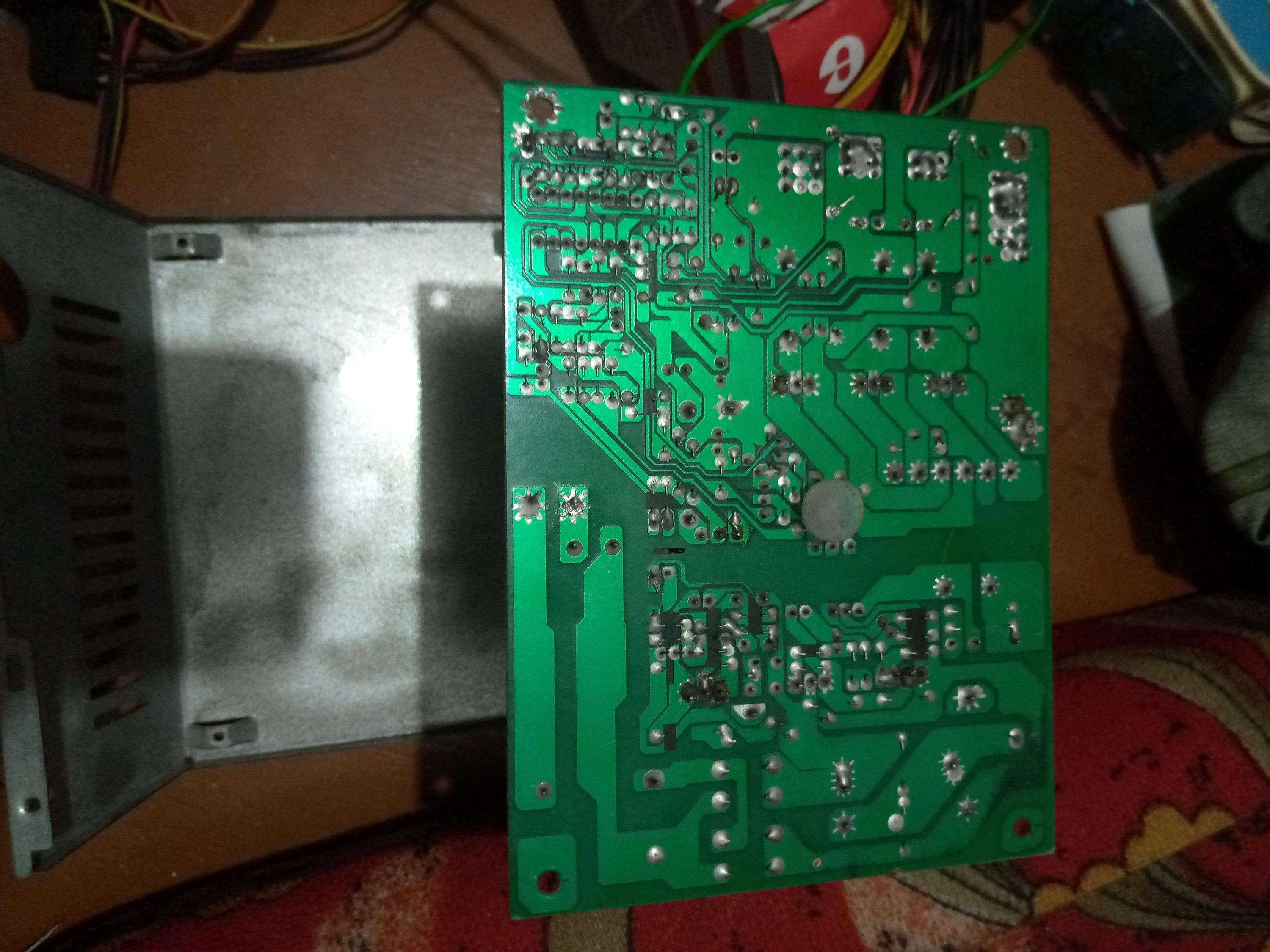

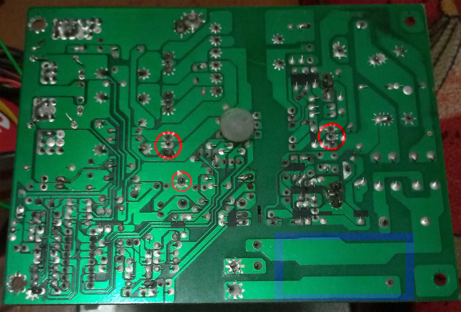

                              uploading
                              • playit
                                • Feb 2020
                                • 182
                                • india
                                please ask at any particular angle if these doesnt suffice , thank you
                                      These suffice for now, thank you.
                                      Again, before I begin, let me just state that the repair of such cheap PSU is probably only good for learning purposes only. In reality, these cheap PSUs are just not worth repairing, because of how poorly they are designed and the low-quality shoddy components they use. For example, the power supply shown here doesn't even provide any form of independent regulation on the 3.3V rail - it is just taken from the main transformer's windings directly. This is very bad for cross-regulation, and likely the 3.3V rail will be very high and/or fluctuate a lot as a load is put on the 12V rail. Also, not only are there no EMI/RFI filter components on the input, but the manufacturer didn't even bother to cut the PCB tracks and put it on the PCB design / layout for there to be any. So it goes to show the manufacturer plain-straight didn't care to make a reasonable attempt at designing a proper PCB layout. On top of that, the main transformer has a fake "35" -class label. Clearly the manufacturer is trying to scam us here. The real size of that main transformer looks more like 28-size, despite being wider on the top. It is simply too short to contain any reasonable amount of windings. Such PSUs belong to this thread, really:
                                      https://www.badcaps.net/forum/showthread.php?t=8490
                                      How this PSU hasn't blown up quicker with the PC you have is almost a miracle. My guess is that every component in it is running right to its limits. Certainly don't expect your replacement PSU to last any reasonable amount of time.
                                      But enough of my rants above. Here goes the troubleshooting.
                                      For starters, there are a number of bad/cold solder joints that need to be fixed (resoldered). I highlighted them in red here:
                                      I also highlighted a section on the input side of the PCB with blue to show where you can cut traces and install common-mode chokes and X2/Y2 caps (on the top side of the PCB, of course) should you get this PSU running and if you'd like to rebuild it a little better.
                                      Next, let's focus on the primary side. If one of the RL207 diodes has blown, chances are there may be more that are marginal (even if still measuring good.) My suggestion is to replace all of these diodes at once or use a single bridge rectifier as mentioned in my last post.
                                      Also, replace that 5 Amp glass fuse with a proper 5x20 mm ceramic fuse if you have one. You can see the manufacturer left space on the PCB for the much larger 5x20 fuse, but put a smaller one because of how cheap the PSU is.
                                      If you have a way to measure the primary 200V caps, do that too, as one of the RL207 diodes blowing up could have sent AC through them and possibly damaged them.
                                      Now take a look at this picture of yours:
                                      https://www.badcaps.net/forum/attach...3&d=1693943602
                                      The NPN BJTs on the primary heatsink look like a pair of (cheap) 13007 clones. Remove both and test them out of circuit with diode test on your multimeter. B-E and B-C junctions should show a normal diode voltage drop when the multimeter's red probe is connected to Base. C-E junction should show open-circuit. Chances are, if one blew up, both of these BJTs will need to be replaced. Be careful where you source your replacement BJTs from. I bought a bunch of counterfeit 13009 transistors on eBay, and they couldn't even hold up to the specs of 13003. For reference, real 13009 BJTs should be good for up to 400 Watts in a properly-designed half-bridge PSU, and 13007 are often good up to 300 Watts. Something like 13003 will likely croak at under 100W load... so beware and try to avoid counterfeits if you can.
                                      With the 13007 transistors removed from the PSU, test the rest of the components connected that lead to their Bases. I'm talking about the small components shown in front of the 13007 transistors. There should be one or two small diodes (usually 1N4148), some resistors (two of them are usually 2.7k), and 2x small electrolytic caps in the range of 1 to 10 uF. The circuit normally looks either like this:
