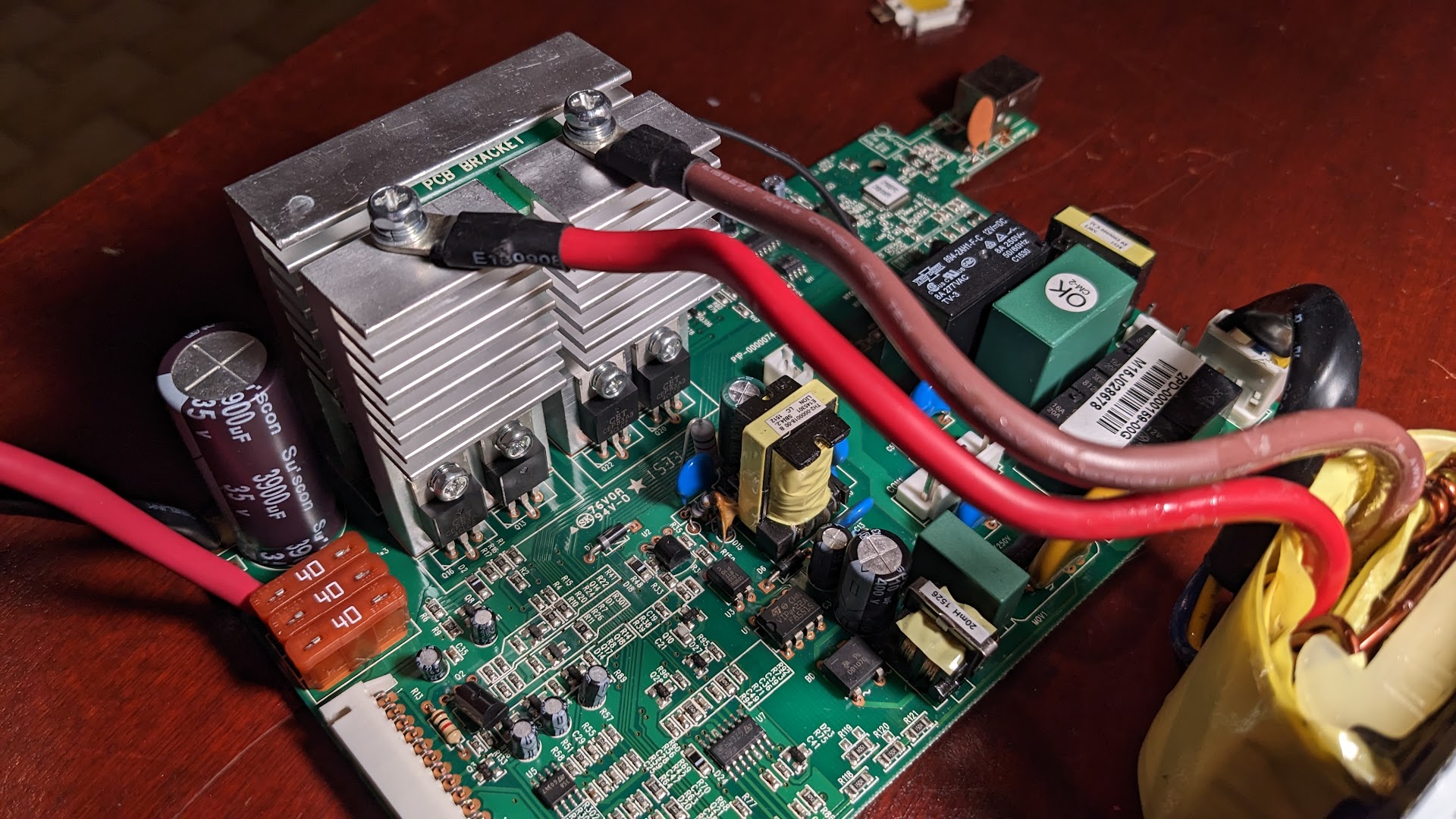

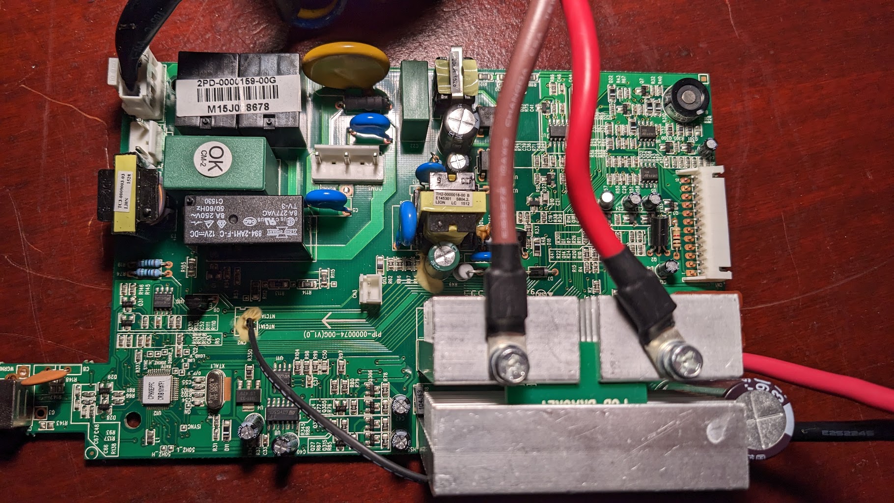

    I have a problem with a Cyberpower CP900EPFCLCD UPS unit that seems not charging the battery.
    With AC power connected I measure 13,50V on battery terminals.
    If I unplug AC cord, voltage drops below 10V after no more than 30 seconds causing UPS to shut off.
    I'm testing with a load of 20W.
    Plugging AC power again UPS turns on and battery charge level indicates 100% (even if I disconnect battery!!!!).
    Tried with new battery same behaviour.
    Therre is no sign of blown components. Could you help me troubleshooting this issue?
    thanks in advance

    13.5 should charge the battery .. 10v is low . test the battery . or leave to charge overnight and then test . even new batteries can be bad .

      I really do not understand, I tried with another battery pulled out from another ups.
      If I power on UPS whithout battery, it shows 100% charge level (?!?).
      With AC power: 13,6V on battery and current flow of 0.5-1A.
      On battery: voltage holds above 12V for 30 seconds then drops quickly below 10V and UPS shut off.
      I've just ordered another battery to test tomorrow.

            To me this would indicate that you have a bad battery or you have a severe over current condition on the primary side which is the battery side and the secondary would be the 120 volt ac side when you are on battery

              just an update. It was a bad (new) battery.
