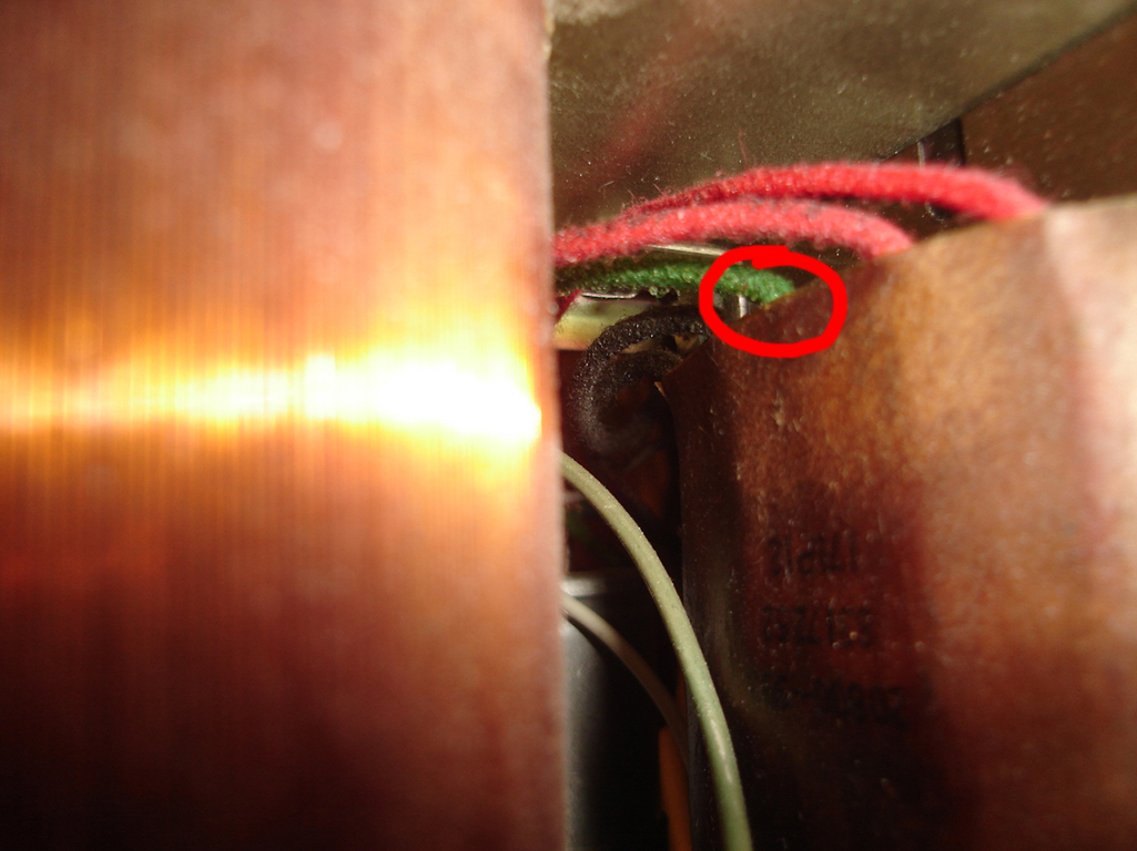

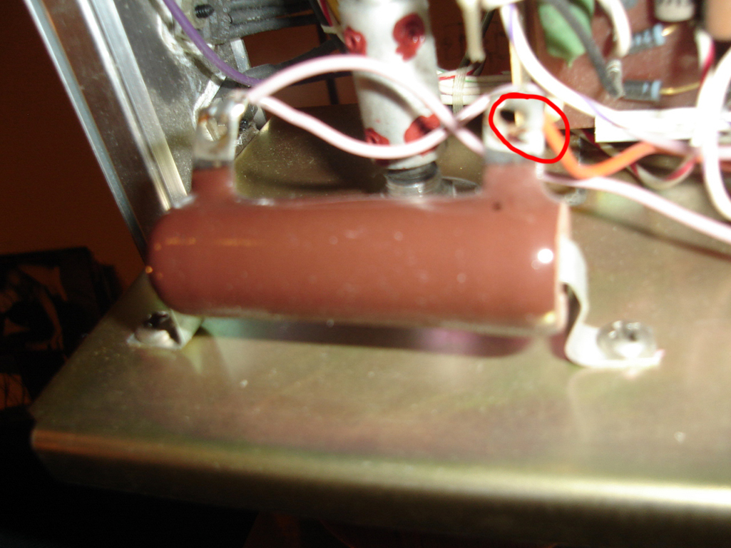

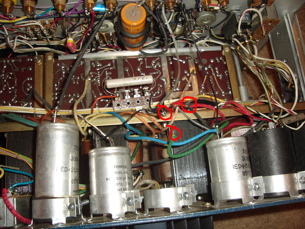

    The problem is the 0-400V DC source. There is a missing capacitor(which I'm assuming blew out and they took it out..) and the thing that bothers me is that there are 3 wires(shown in pic). My initial guess was that green is ground and black is negative and red is positive to the output . I traced the green wire to the middle of a bulky transformer, so im guessing that is the isolated ground(pic attached)? The black wire goes to the negative terminal of the 0-400V supply output, and the red is a little confusing.. It goes to this strange "wooden" resistor(pic shown)as well as some other spot on the circuit board. It does not go to the positive output as I thought.
    If I turn the supply on, there is a constant 38V between the red and black wire, no voltage reading at all between green and black or green and red. The ammeter and voltage meter pulse as if the 0-400V supply is trying to turn on...
    One last thing, that strange resistor gets very hot in only a matter of half a minute or so... Maybe there is some short?

    The "wooden" resistor is actually a ceramic wirewound type.

    Strictly from an age standpoint, I would be prepared to replace all of those large can caps. Their filtering ability has most likely faded due to their age and probably what caused the failure of the removed one.
    The power coming to that cap would be rectified somewhere, but one leg of the transformer could be the neutral/ground leg. That makes sense to see the green wire direct from the trafo to the cap. It's likely a full-wave rectifier, center-tapped. Depicted in the 3rd diagram down, here: http://en.wikipedia.org/wiki/Rectifier
    Going by the voltage (38v) you read there, this is more likely the 40v supply section.
    The high voltage in this supply, as indicated by the front panel, is limited to 150 milliamps. That resistor may be the limiter. Where does the wire from the other end go?

      I just got one of these, haven't even fired it up yet since one of the caps has
      a bizarre little mushroom of electrolyte oozing out of the 2500uF/75V cap.
      The cap you are missing is 500uF/75V. The negative side has three black
      wires, a braided ground line to the HV- and a green wire going to a transformer.
      The positive side of the cap has three orange wires. One goes to a bleeder
      resistor near the cap, one goes to a huge 100 ohm power resistor and the
      last goes to the regulator board.
      The six can caps should be replaced with short, fat snap-caps, the two
      HV caps (50uF/450V) should also be replaced. Looks like there are two
      dipped tants on the meter board that should be checked.
