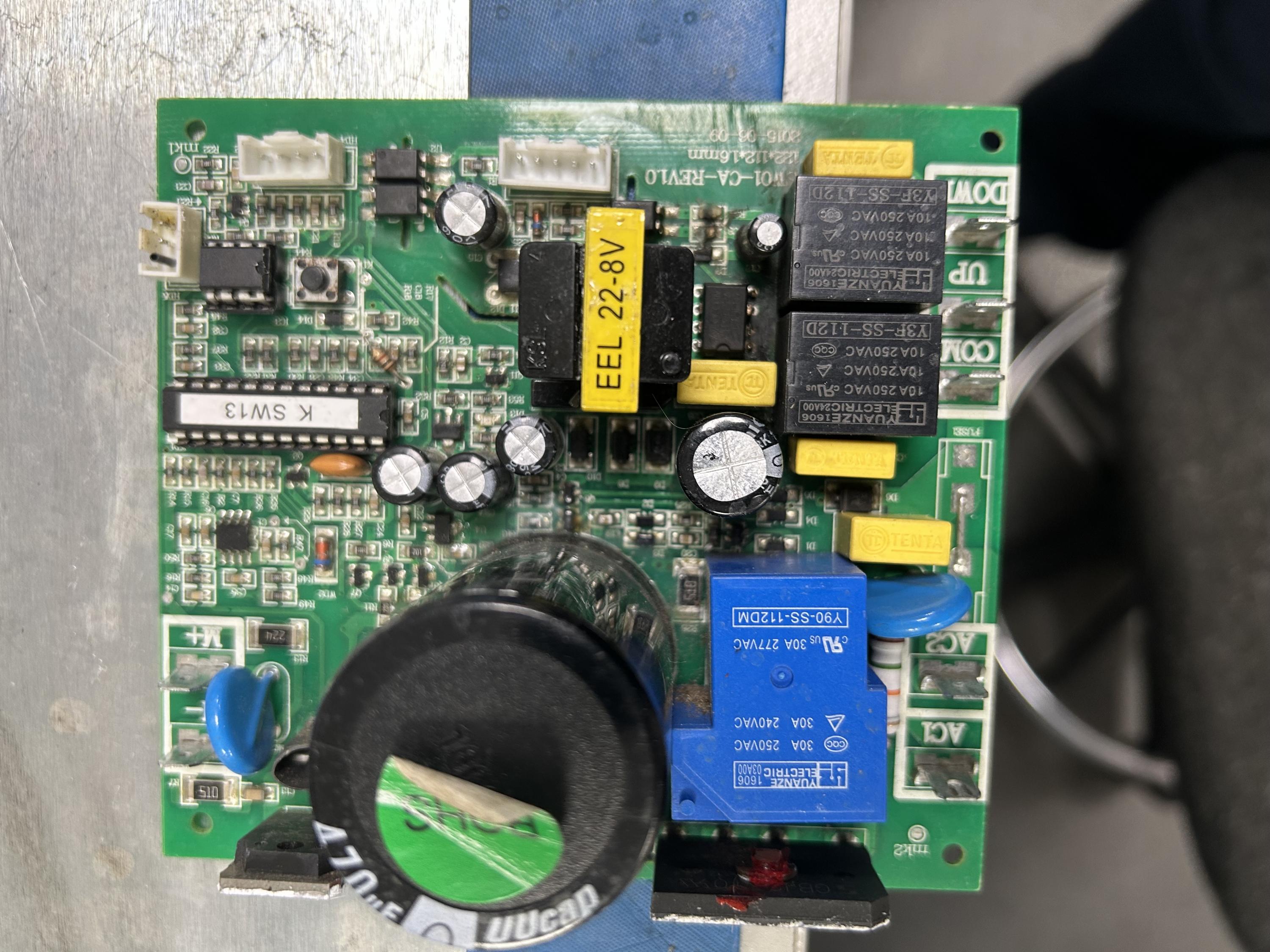

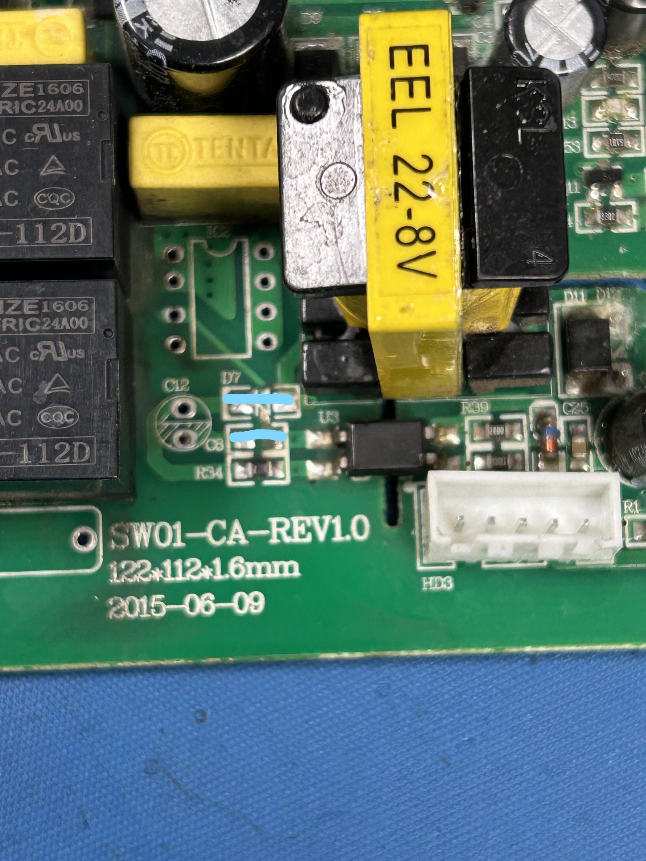

    Hi, I have a Reebok treadmill PSU SW01-CA-REV1.0 (KSW13) that's blown, I can identify most parts but have diode D7 and chip capacitor C8 that have burnt out and are unidentifiable - does anyone have a schematic or a PCB they can identify the parts from?

    Re: Reebok treadmill PSU SW01-CA-REV1.0 blown
    you need to remove the relays and the polyester and electrolytic cap and get rid of the rest of the carbon
    also the cap may have leaked and caused the arc
    the diode is probably just a regular rectifier like a UF4007 feeding power to the chip from the aux winding of the transformer

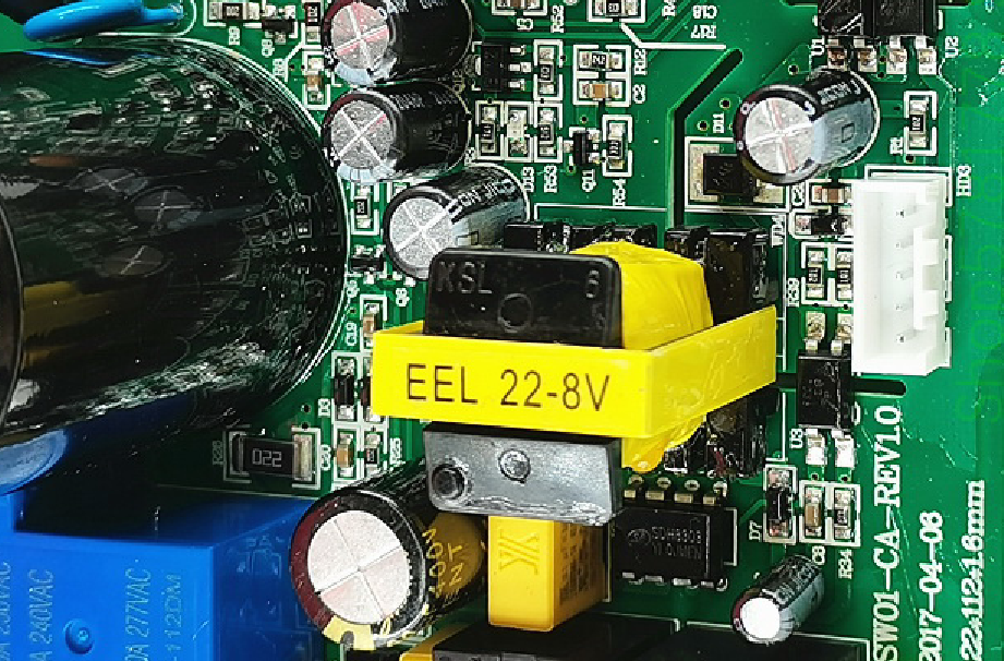

      What is the number on IC2?
      • lotas
        • Jan 2016
        • 4784
        • Russia
        From the photo you can see that it costs SDH8303.
