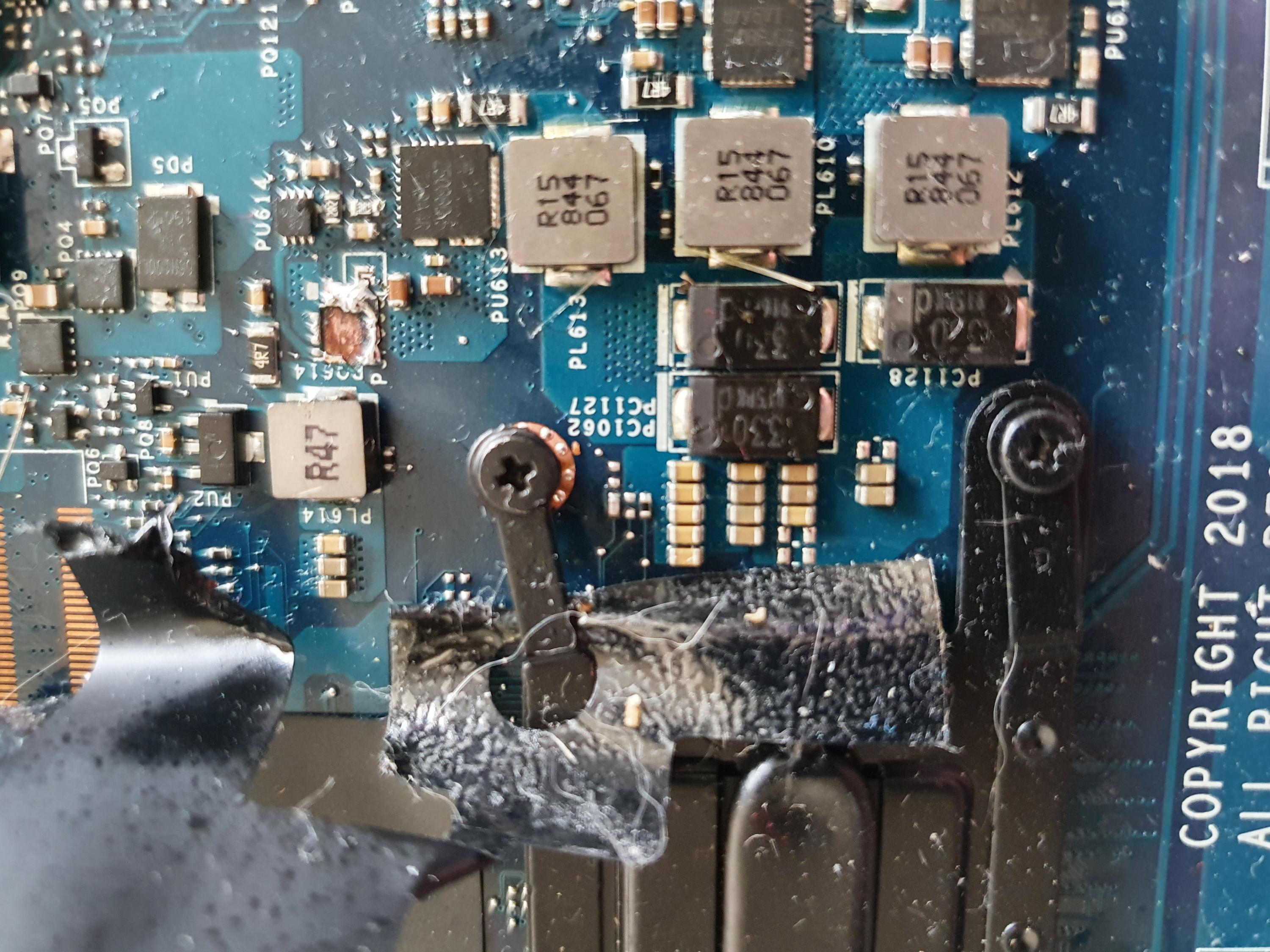

        DDM80 LA-F411P schematic or boardview needed
        I need to id component pq614. schematic or hd photo of board needed.
        • mon2
          • Dec 2019
          • 14662
          Re: DDM80 LA-F411P schematic or boardview needed
          What are the markings on PQ614 ?
          • Bisketti
            • Oct 2013
            • 252
            • Ireland
            No markings, its completely destroyed.
            • mon2
              • Dec 2019
              • 14662

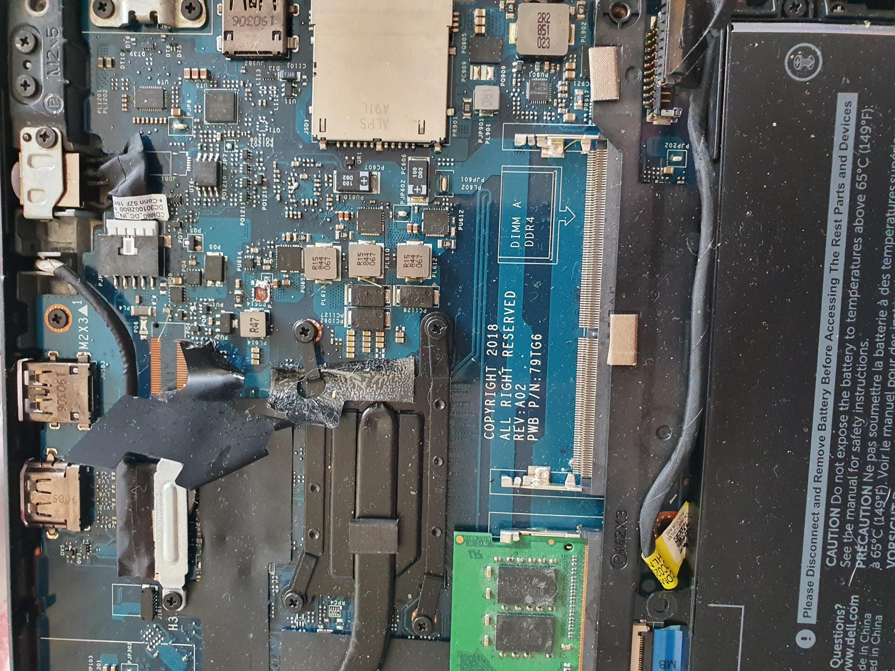

              Post a pic of the logic board that shows this location of PQ614.
              What IC is close to this (missing) mosfet? What are the markings of the IC ?
              • Bisketti
                • Oct 2013
                • 252
                • Ireland
                Here are a few pics. Im not sure if you can make out the IC but its z5038015.
                Pu614 looks damaged also.
                  Apologies its z5038Q15
                                For future reference:
                                PQ614 B09A03 - can be found on aliexpress
                                PU2 RT9058-33GX - SOT-89-3 package
