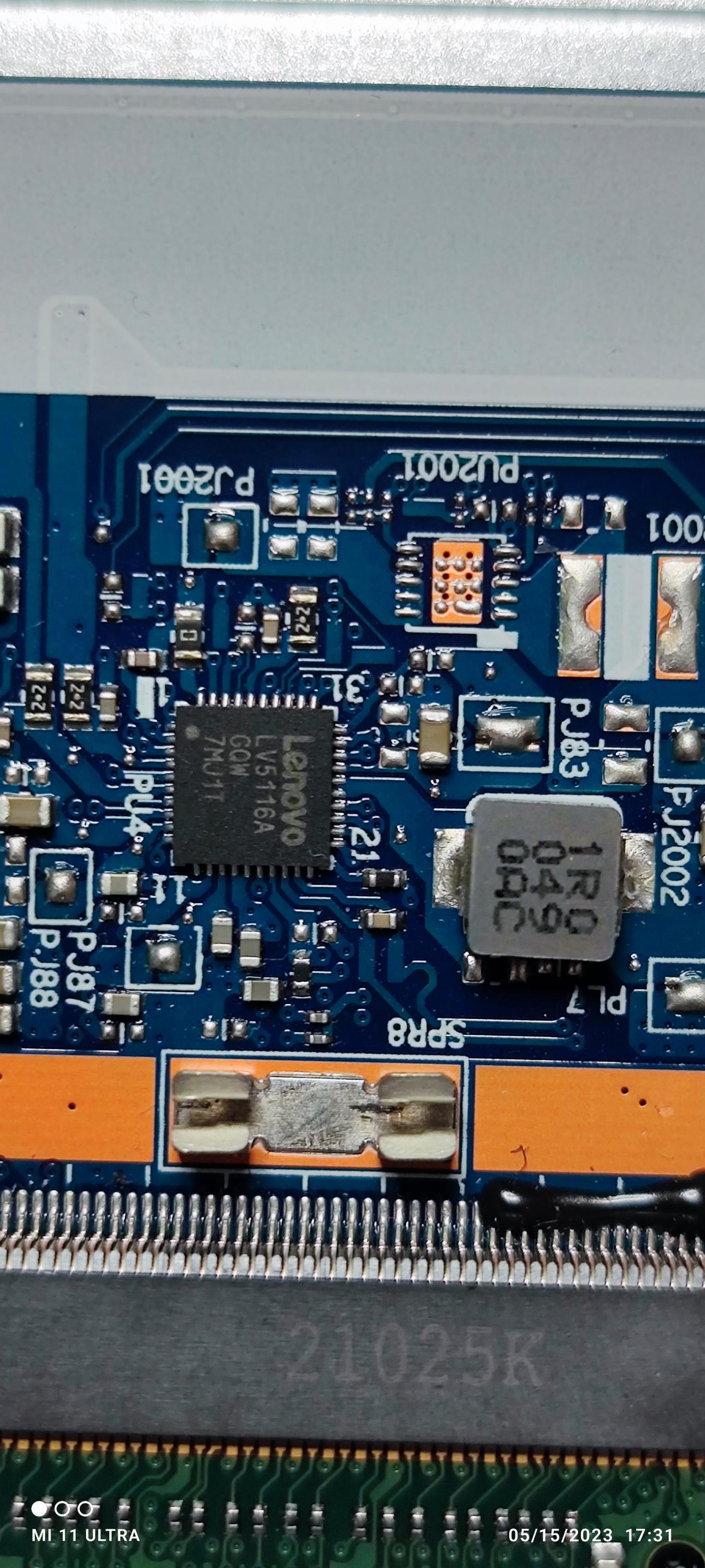

    Awesome thanks! Does anyone know the minimum hardware I need to connect(fan, keyboard, etc) in order to see if it is receiving power via the USB C input?
    Right now my plan is to replace the port and all the 0201 components near it because I suspect the previous repair attempt may have dislodged some, as there seem to be quite a few missing components. From there I can start troubleshooting component failures deeper in.
    Actually, is it typical for boards to have a few unpopulated components? Does this sound like a dumb approach?

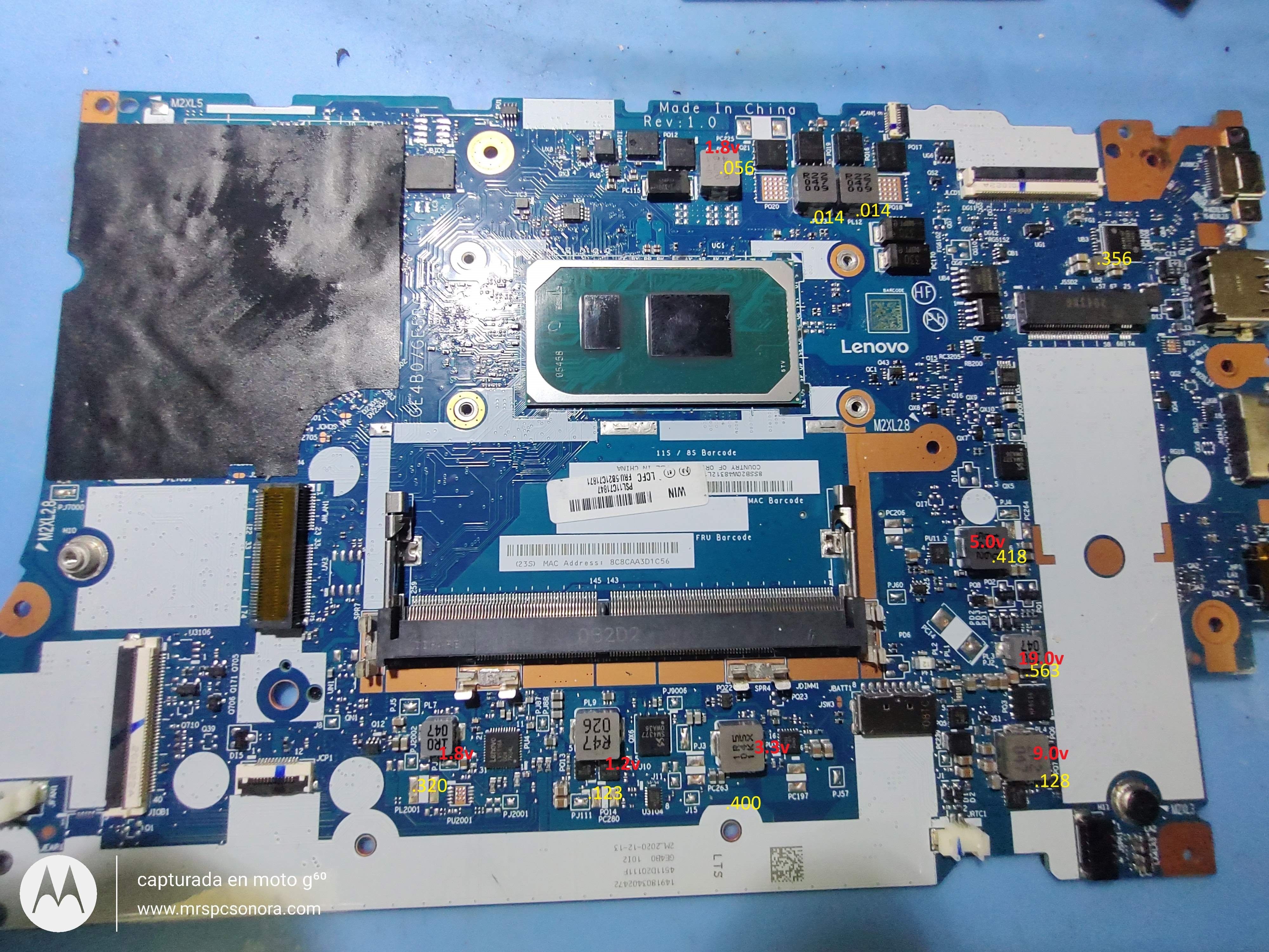

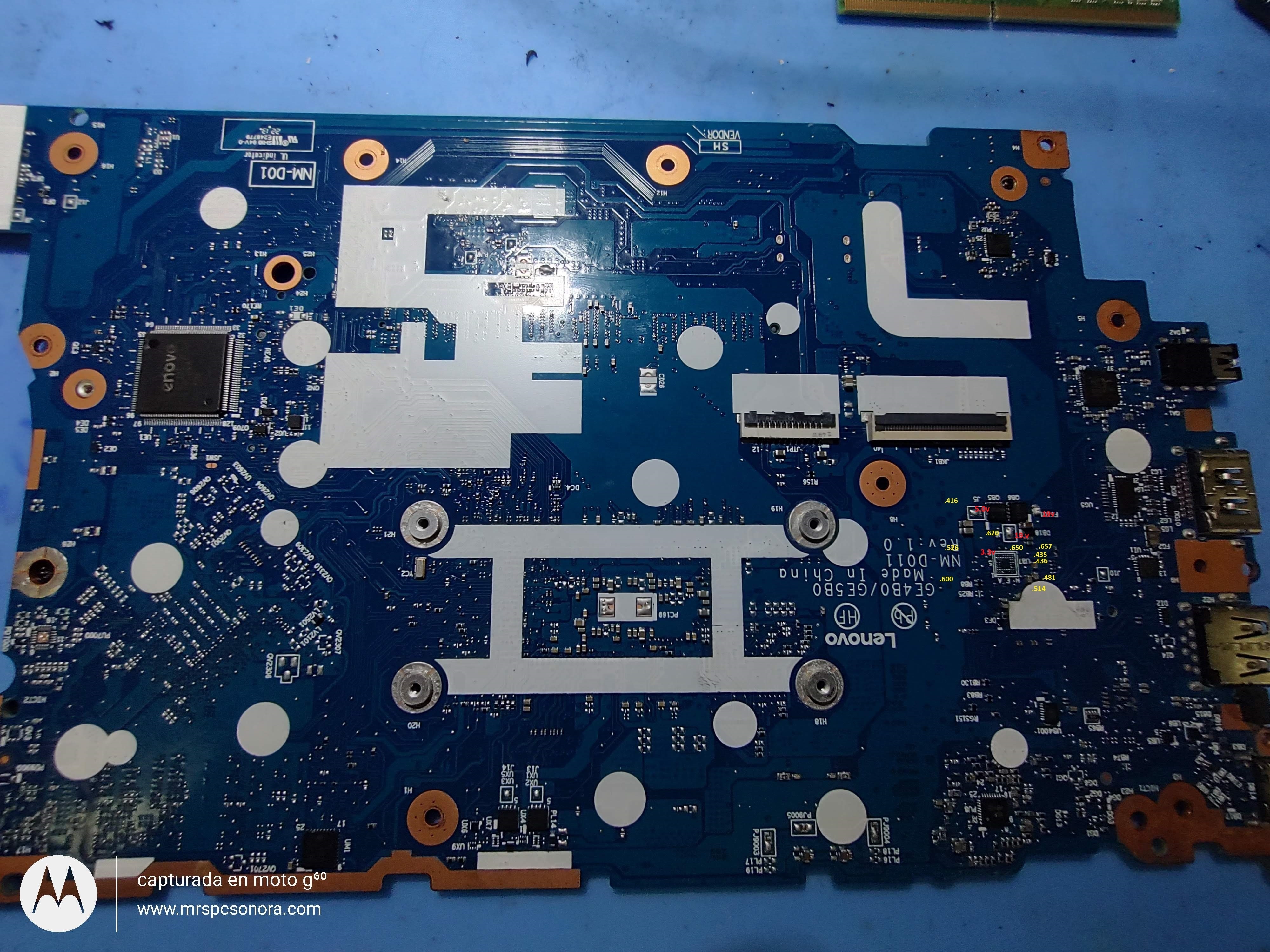

                        #31
                        imagenes con mediciones si les sirven de algo gracias a todos por sus aportes. Las mediciones estan tomadas con la punta roja a tierra.
                        Images with measurements if they are of any use to you, thank you all for your contributions. The measurements were taken with the red tip to ground.
