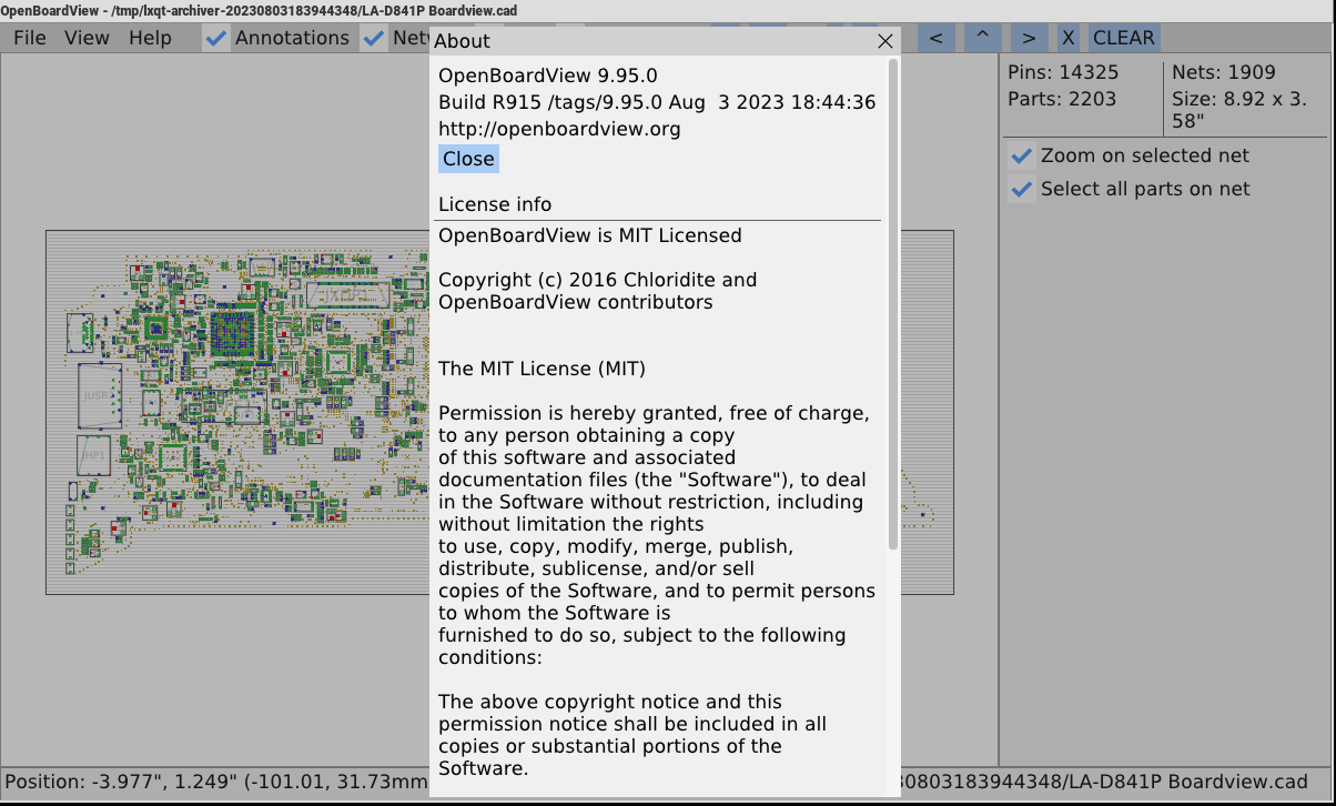

                      • cmn.fix
                        • Dec 2019
                        • 40
                        Re: Dell XPS 9360 - LA-D841P Rev:3.0 schematic/boardview
                        Originally posted by AL._.EX
                        Boardview
                        Hi, sorry but what software do you use to open that filetype? tried openboardview and autodesk online viewer to no avail.
                        • Vesko356
                          VIP Moderator
                          • Aug 2018
                          • 4386
                          • Bulgaria 🇧🇬
                          BoardViewer ---> http://boardviewer.net/

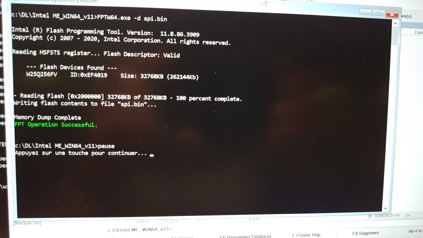

                                I have a DELL XPS 9360 (french model from France) coming from my work to fix the Intel ME Bios part, which has failed without any reason after a Bios update from a fresh Windows install made with the MediaCreationTool from Microsoft 🙄
                                As we work professionaly with Dell, I have asked them some help, but they told me that the motherboard must be changed 🤦
                                I do electronics, I have a 3.3V modded CH341A which I use for mainly flashing 24Cxx Eeprom.
                                So I started to look at the way to flash it.
                                I have found this great topic here: https://winraid.level1techs.com/t/de...-disable/35154

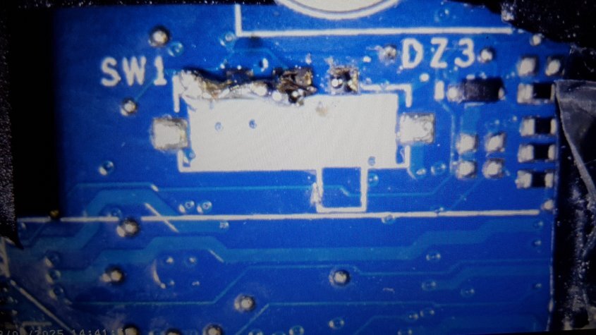

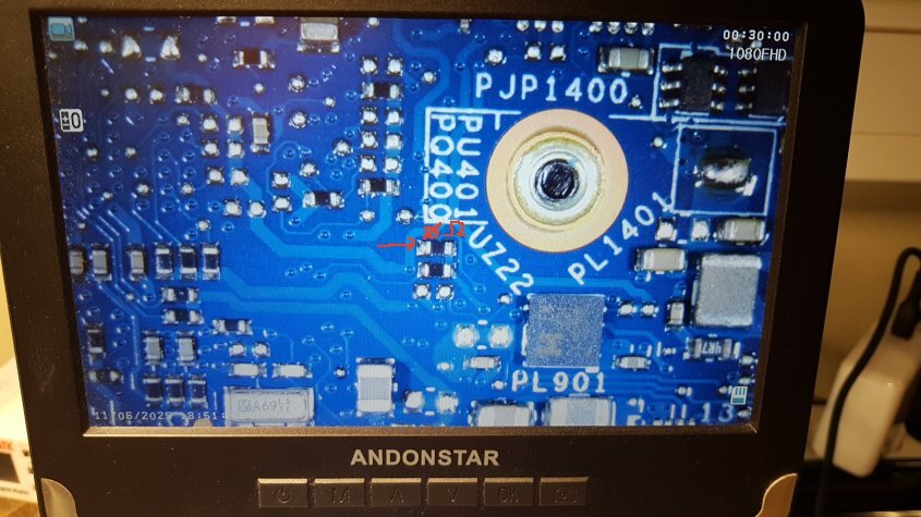

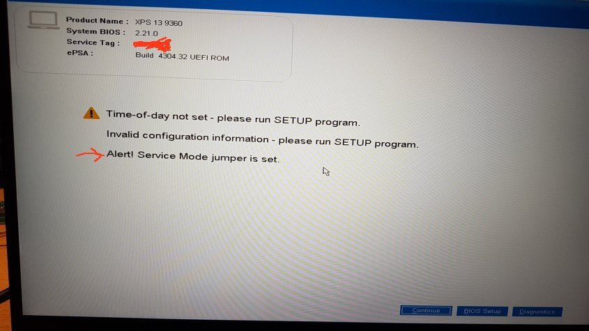

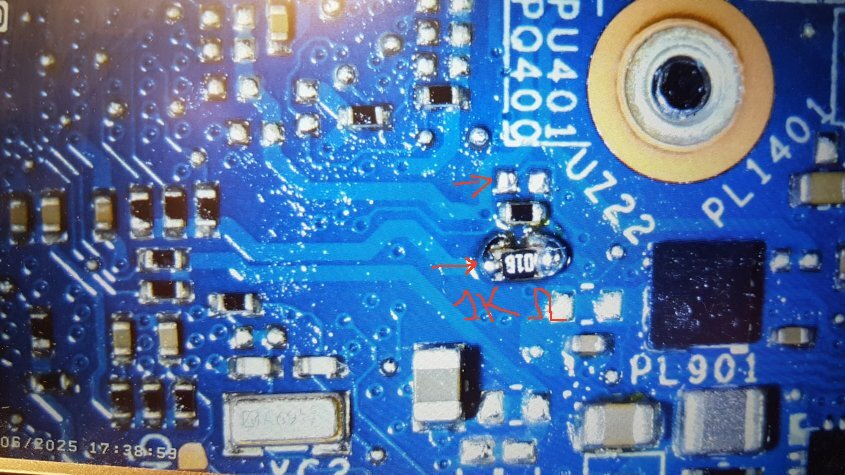

                                So after analyzing and understanding the shematic(page 13 from PDF) and the boardview, I share with you the way to put this computer in Service Mode 😉
                                To sum up:
                                - remove the 0 ohm R1191 resistor
                                - solder a 1K resistor in the RC9 empty location
                                - join the 2 solder points you want on the SW1 switch (1+2=service mode, or 2+3=normal mode)
                                Dell Bios tells that we are in Service Mode, and I have successfully extracted the Intel ME Bios (32MB) which I have now to fix.
