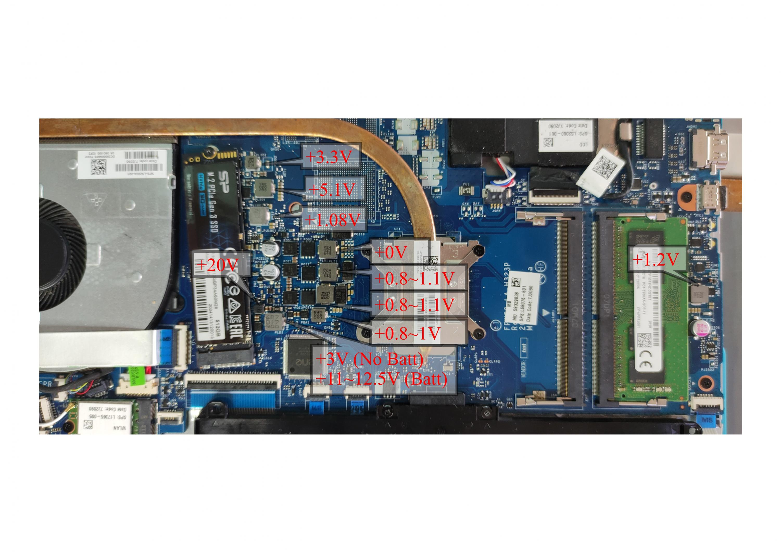

          Re: HP FPW50 LA-H323P have anybody schematic or BV?
          A 15s-du1016TU (with a LA-H323P motherboard) came in dead with water damage. A number of areas were affected, mainly a number of QFN's. Board worked ok after rework. I took the opportunity to grab some voltage references off it for future reference as there's no schematic currently available.
          Some other stuff:
          PU301 SY8286BRAC +3.3V (AWV)
          PU302 SY8270CTMC +5V (BTX)
          PU1001 SY8286RAC +1.08V (BAA)
          PUB1 BQ24725A (BQ25A Battery IC)
          PUM1 G5616B 1.2V (DDR4 Buck converter)
          PQA1, PQB1, PQM1 EMB09A03HP FET
          EC is ENE9022Q and programmable.

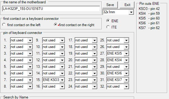

            SVOD programmer keyboard pinout for the ENE9022Q
              • 22097
              KB_pins=32 1MM DOWN LEFT KSO3=15 KSI4=28 KSI7=31 KSI6=30 KSI5=27

                Sorry to bother you but I'm trying to repair one of these boards and appreciate you taking time to post this information. The board I'm trying to repair is missing the +0.8~1.1V rail. I checked PQA1 and I do have 20V on the high side but only 0.2 on the output. I thought maybe I'd get lucky and it was just the FET so I swapped it with PQB1 as I had 3v out of it without a battery so I knew it was working. No change at all.
                History, this board was working fine until I opened it up to upgrade the NVME. I disconnected the battery and when I put it back together I get the dreaded 5 long flashes 3 short on the caplock.
                All the other rails are present and correct. I can't determine what triggers that PQA1 FET and the mosfets in that circuit to power the CPU. The SIO by chance????

                    hello, good afternoon, I received a plate just like this one, and I need to know the value of the plm2, which in my case is blown up or burned, that's your answer, thanks
                    • outta
                      • Dec 2012
                      • 18
                      • Mexico
                      From a similar board and some info here and there I guess you can use FBMA-L11-201209-121LMA50, which is a 0805 size, ferrite bead, 0.19uH, 5000mA. Keep in mind it blew because a short circuit after it. Check PQM1 and PUM1. They are likely bad.
