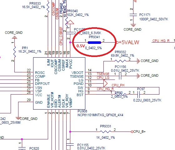

    Hello.
    Have this Lenovo g50-80 i5/AMD that turn of after half second.
    find that have no voltage on CP, GPU, MEM
    flashed bios and have GPU, MEM power but nothing on CPU
    VRM signal come, but have only 0.5V on PVCC, jumped 5V from 5VALW and got CPU POWER
    But i cannot find PR9341 that is probably bad. have anybody boardview or know its location?
    dont want run jumper wire

    NM-A361 Boardview
    plus software .
    hope that help you my friend .
