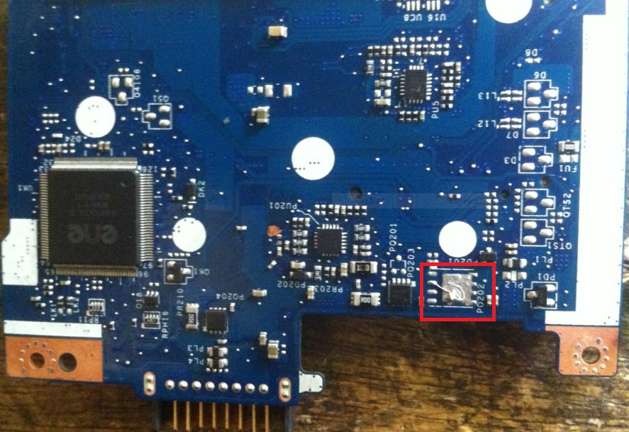

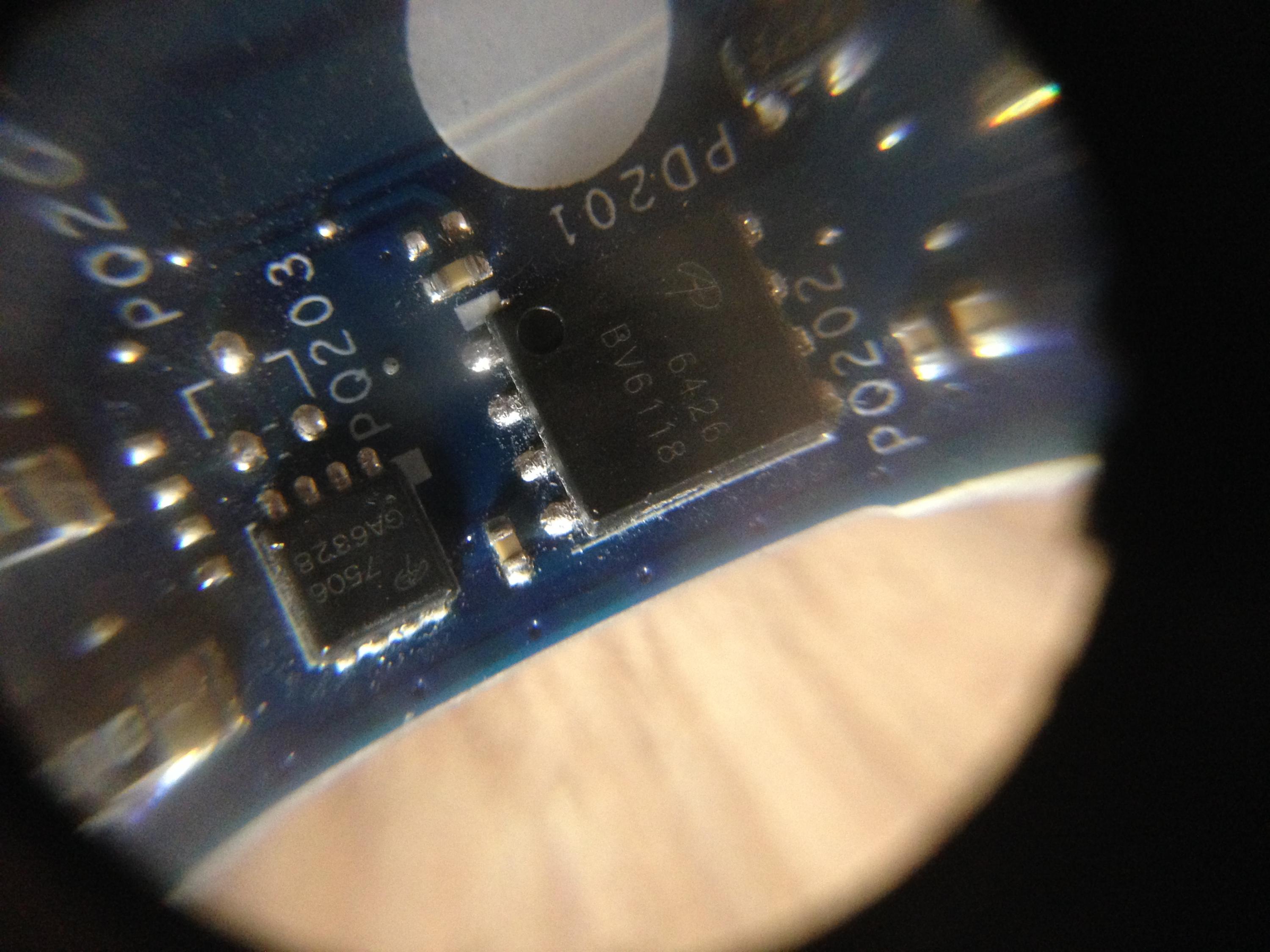

Finally I found it myself (but no the laptop diagram/schematic) and I can confirm 100% that 8A 3G B59 IC is RT8243A and any of this sub-models will work:
RT8243AZ RT8243A RT8243AZQ 8A=EC 8A=ED 8A=EF 8A=xx RT8243AZQW QFN20
If your chip is overheating and the 3.3V and 5V coils are not in short circuit then check the output pins 15 and 14 (LDO3/LDO5) respectively 3.3V and 5V ALWAYS ON. Most common problem will be the KB9022Q D Embedded Controller that is in short circuit due to faulty (broken plastic) DC Socket/Power Socket that short the middle info pin to the positive +19V.
The link of the Stand-By Voltage IC RT8243A is here
https://cdn.badcaps-static.com/pdfs/...6efd1981b0.pdfLast edited by raileanu; 05-10-2018, 09:17 AM.Comment
