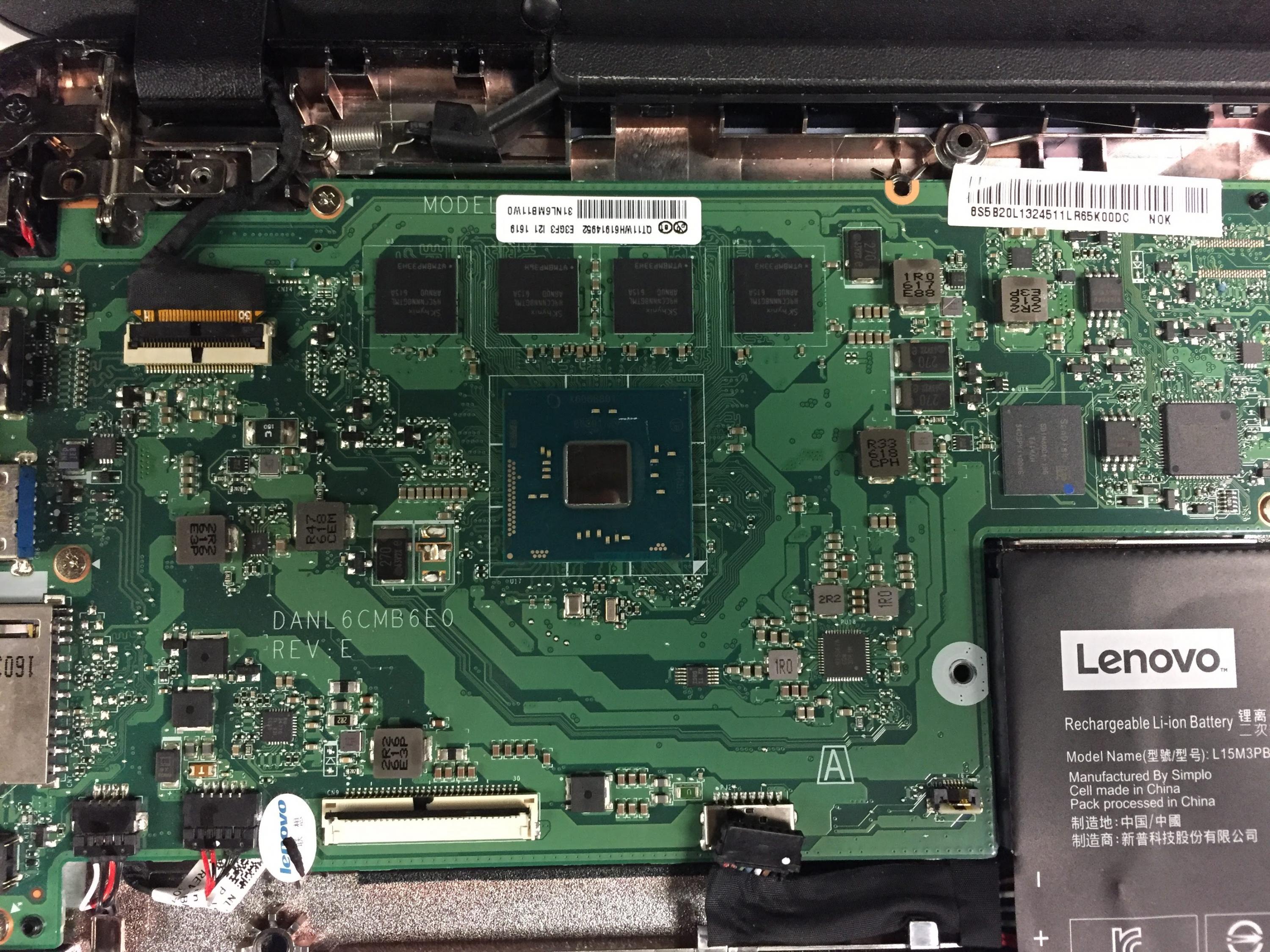

Lenovo Chromebook N22
  • shegoit
    • Jan 2017
    • 4
    Need schematic on Lenovo n22 -20 Model 80sf
    Number on board is DANL6CMB6E0 Rev: E

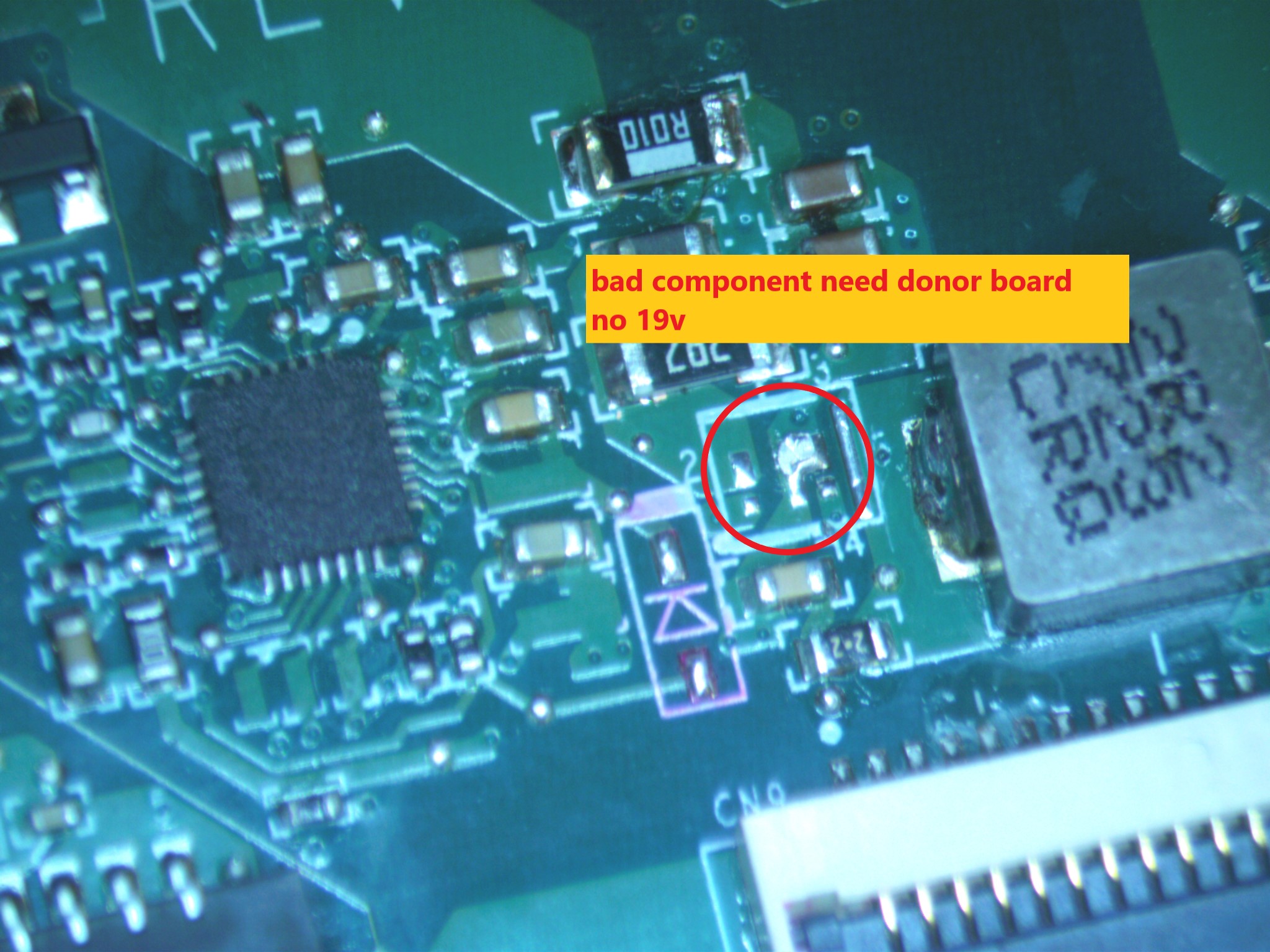

  • Prepaidconnect
    • Jan 2021
    Re: Lenovo Chromebook N22
    I think I am having the same no power issue with flashing charging light the component I have circle i think has the fault but need donor board to test it
      • 21857

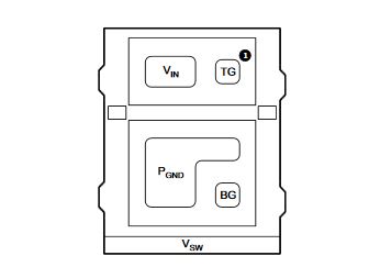

      It could be a TI csd87381p .See the attached Quanta NL6D schematic ,PQ6 page 37 .
      https://cdn.badcaps-static.com/pdfs/...c0ffa55a95.pdf
