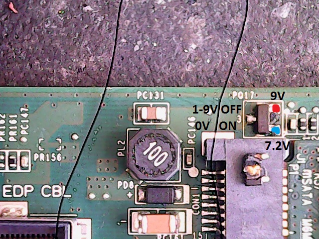

    Hi as the title states I'm looking for a schematic or boardview for the DAD13CMBAG0 / Dell xps 13 - 9333
    Actually if someone could assist me with the LED power rail. The PQ17 on the board burned and though the LED works there is no back-light. I have been trying a few similar SMD components that I took from similar circuits but they don't work. I'm not sure what exactly is needed here.
    Attached is an image of the circuit with the component replaced. PQ17 is the Component in question.
    With no component on the board the traces:
    1. 9V also directly gives continuity to 19V rail so No idea why its 9V and not 19V altho there are a few components sharing that trace.
    2. 7.2V
    3. 0V
    With a replaced component the voltages stay the same apart from pin 3. it is between 5-9V when the laptop is off. Switched on with no backlight but working screen, it gives 0V and it starts getting hot over time.

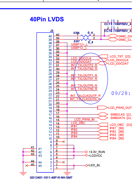

    Re: Looking for Schematic or Boardview for Dell XPS 13-9333 (DAD13CMBAG0)
    Working from an 04f94_Quanta_D13_Spyder_13.3+DA0D13MBCD1_UMA+1013+1730_cost_DELL+XPS+L321X
    schematic the pinout for the LCD seems very similar. And I'm Missing LED_BL Voltages. LED_BL is connected to the cap in the previous image that sits below the Diode that is below the Coil.
    EDIT: Added LED_BL Converter Circuit. Seems to be the same as the one I'm working on.... Now I just need to find an alternative or the same part as Q51
    AO3409 from the attached image

      • piernov
        • Jan 2016
        • 4439
        • France
        Output may be shorted. Check the resistance to ground on PL2. (if this is indeed the output inductor) Try with screen connected and disconnected.
          Piernov Thanks for the reply.
          Ohm check to ground from PL2 = Nothing just ---- on meter.
          Ohms across PL2 = 5Ohm with and without screen.
          To add. When screen is disconnected and I switch the board on the voltage on that line where PL2 is, is 10V (on scope) which seems to be the same for B+ (I checked at the mosfets that receive B+ for 3.3/5V)
          When I connect the screen (which is brand new/Also both old and new do the same) the rail with the 10V from PL2 remains 10V and then that PQ17 starts overheating after a few seconds... Until it starts smoking. So I don't know why its pulling so much current.
          As mentioned the screen does display but no backlight I tested that by removing PQ17.

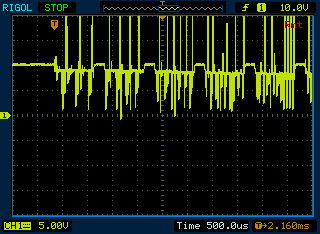

          I'm testing with the scope atm to see what's happening with the PQ17 when it starts heating up the wave is horrible will try and add it in a moment.
          Also to add I found a proper datasheet for the p-channel mosfet(PQ17) based of the schematic which is Q51(for the other xps) at the moment I want to replace it with something more similar to the one from that datasheet I linked for Q51. Because I think the one I used which seemed similar is not actually even close... So maybe the reason for the overheating because its current limits are so much less.... This is the current p-channel on there.... I will have to find something more similar to the A03409
          Will report back in a moment
          EDIT: Added the scope images probe was at PD8 just after PL2 for first image and 2nd image was right at PL2 after going though the coil you can see when the switching started.

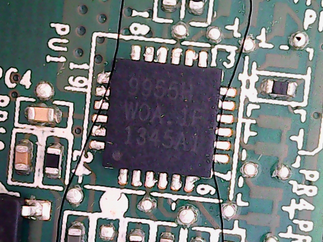

              After some testing and checking I found the Driver for the LED....
              Attached is a photo of it. It gets super hot... No idea where Id find an alternative like this. As it seems the usual ones on the other xps 13 has 13 pins this has 24.
              Also no datasheet for this so far on the internet...
              #Lines in the photo is from the camera lens#
              while alive { live(toFullest=true) }
                • 21853

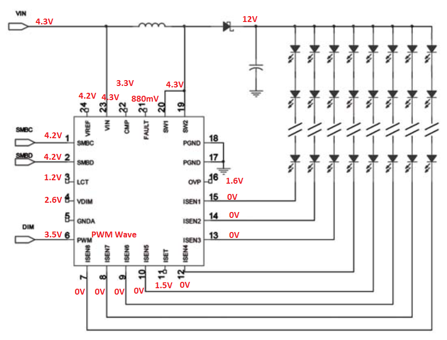

                I think the full part number is OZ9955ALN-B-0-TR .Its made by O2Micro
                https://www.aliexpress.com/store/pro...863197013.html
                Page 16 of this catalog has an application diagram
                  Awesome SMDFlea you are a Star! That example schematic they have on page 16 for OZ9955B is exactly the setup they have here on the board...
                  Somehow the PD17 the Mosfet from the original image of the board... blew again. now even tho its blown its letting through 7V roughly and after the PD8 (scotchy) its 12V which seems more reasonable but still no backlight. Also the LED driver doesn't heat up and its alot more "active" in the sense its giving out more likely voltages. Which makes me think that the mosfet they originally used is somewhat specific and different from the schematic for the L321X (xps13) I have been using as somewhat of a ref.
                  This is becoming a bitch....
                  * Just to say the original issue was that the client bumped the xps into a table and the sharp corner went right into the bottom of the screen where the screen cable connects on the LED board (screen side) and it broke it off, which caused some short circuit or something which in turn burned that PQ17 mosfet. Just so you guys have some idea of what happened.
                  Thanks for the help so far, much appreciated !

                            • 21853
                            I had another look at your photo on post #7 ,with my glasses on this time.... , it looks like a OZ9955h (H) , i don`t know if theres any difference between the B and H version and can`t find it in any O2micro catalogs .
                              Hi again SMDFlea!
                              Yeah I don't know the difference either, it maybe there just to throw people off? no idea... But following the OZ9955B schematic I get the exact same results on the pins on the board. Which also brings me to thinking that maybe the LED Driver is still OKAY. Because at the moment it seems to operate normally... It may just be the VIN that's the issue which is coming from PQ17(In the original photo post #1)
