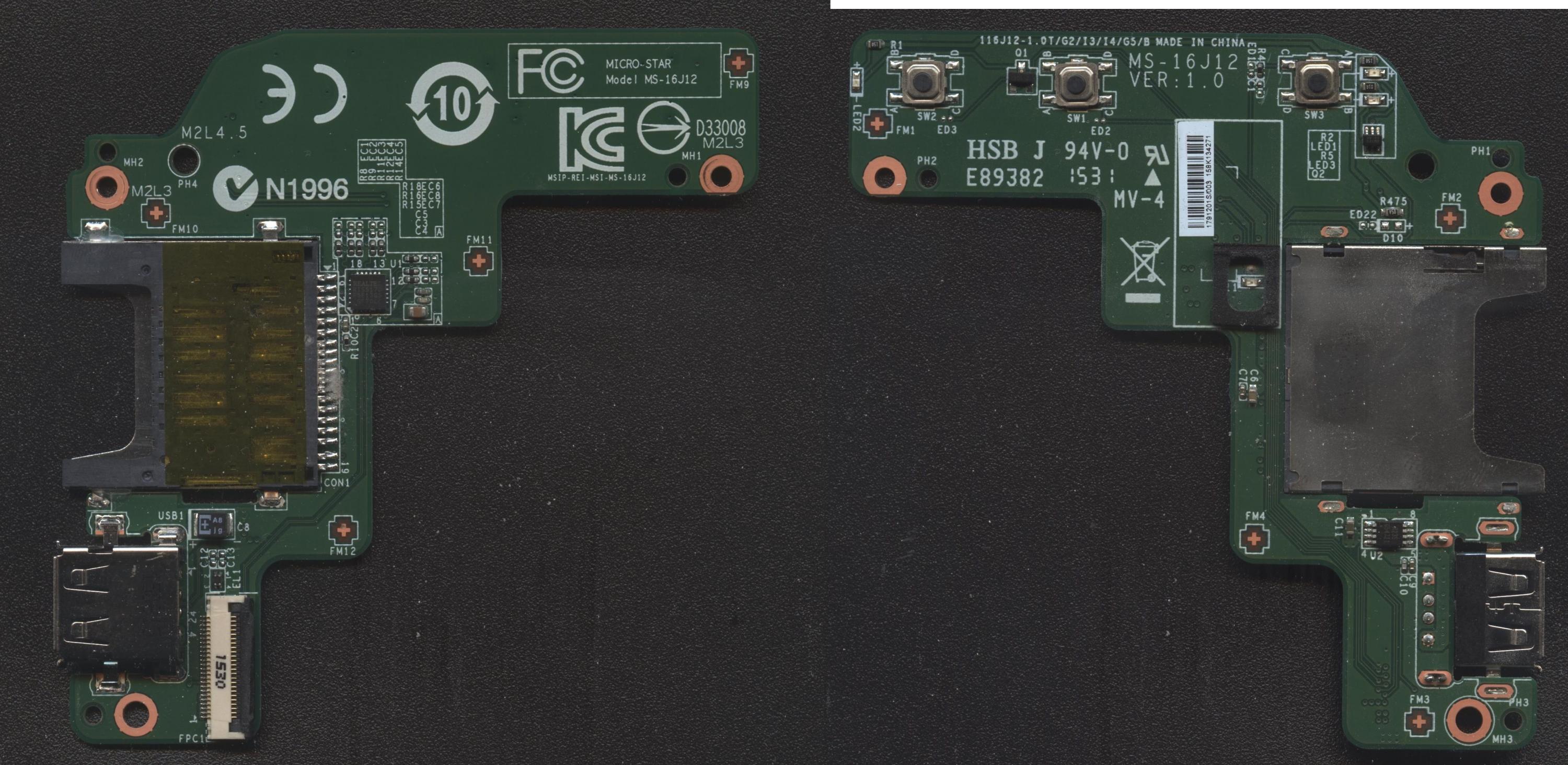

            Hello, I am looking for a schematic for msi ge62 2qd (ms-16j21 ver.1.0 in version 4.5mb). i will be grateful for any help.

                    Re: MSI GE72 2QC Schematic plz
                    In my laptop there was a damage to the usb2.0 socket, after initial measurements it turned out that between the mass and the date - there is 10 ohms and between the date + and the mass is about 60 kohm. there is also a high impedance between vcc (5V and ground. The laptop is msi ge62 2qd motherboard ms16j21 ver1.0. is it possible that there is some element between the bridge and usb that could be damaged and ground date-. I found a diagram on the vinafix website but it is a bit too expensive for me to download it. and the free versions of the schematics may not be complete. generally the laptop works fine, the temperatures oscillate between 40-50 degrees and the other components work. Please advise what could be done with it, how to save these usb and is it profitable and how much can it cost.Thanks in advance for all suggestions
                      Krilan1990, Write the name of the faulty connector (UCB CON1 - CON3).
                        usb 2.0 , this laptop has only one usb 2.0 port, next to the sd card slot and the power adapter port
                          Subboard 116J12-1
                          USB1: problems - U2 with strapping, EL1, FPC1. Motherboard - FPC1, HUB.

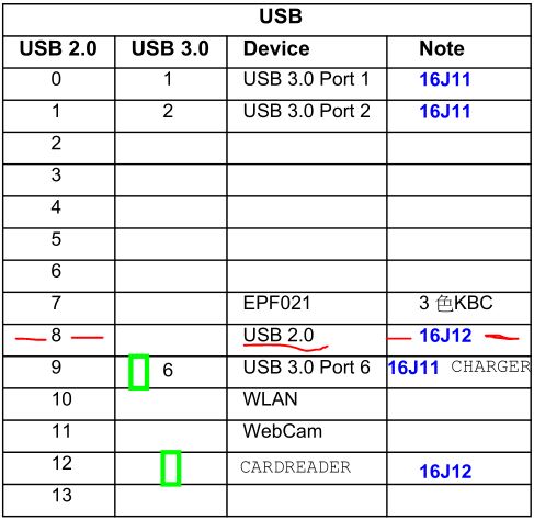

                            USB chart on page 28
                              thank you i found it. but I do not know if this socket has a system between the bridge that could be damaged?? did he break the bridge?
                                after connecting the mouse, the computer does not see the device, it does not recognize it. when I measure the signal pins with a multimeter, on the data pins I have 60kohm and 10 ohm. as one pin was shorted to ground. I do not know if there is a pullup resistor or some esd element between the socket and the bridge, there is no burn mark on the board and the computer works normally. only the usb2.0 port does not work.
                                  Disconnect the cable from USB1 and measure signals directly on FPC1 motherboard. They go directly to the HUB.
                                      I measured on a turned off laptop. when the 16j12 board is disconnected, it is out of range and when I connect the tape to the motherboard and measure on the pins, it has this value
