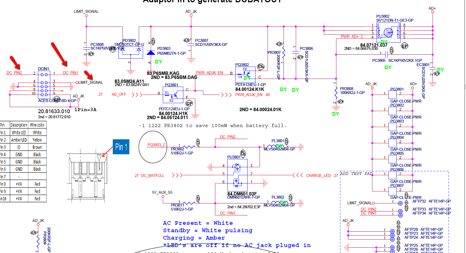

    Hello i have this HP that wont turn on with AC adapter, but if i insert battery when AC adapter is connected the laptop will start by itself.
    Anyone have schematics? Or have idea what can be problem?

        hey i found board view, here it is if someone need it.
        Can you help me, what voltage i shoud have on DC_PIN1, DC_PIN2, LIMIT_SIGNAL and AD_JK
        i only have 19V on DC_PIN1, DC_PIN2 and LIMIT_SIGNAL
        AD_JK is 0V

          Re: HP dv6 Envy (Goya/Balen 1.0 DDR3 11254-3)
          The connector's pinout table is on the left on your picture.
          You should have 19V coming from power brick on pin 8/9/10.
          Pin 1 should show a couple of volts when adapter is plugged it, and pin 2 should show a couple of volts when the battery is charging.
          Pin 3 is the power brick identification pin, voltage will depend on the power rating of the power brick, but might be a couple of volts too.
          You may have reversed the pin numbering, check that again, and check that the cable is plugged in the correct way.
            hello, i check voltage
            pin 1 - 0V
            pin 2 - 0.45V
            pin 3- 0.61V
            pin 4,5,6 - 0V (GND)
            pin 8,9,10 - 19V
            i tested this only with AC adapter (no battery)
              but i think schematic is no good, on my board PU3802 is not populated, also PR3807, PQ3802 so i think it is some different circuit
