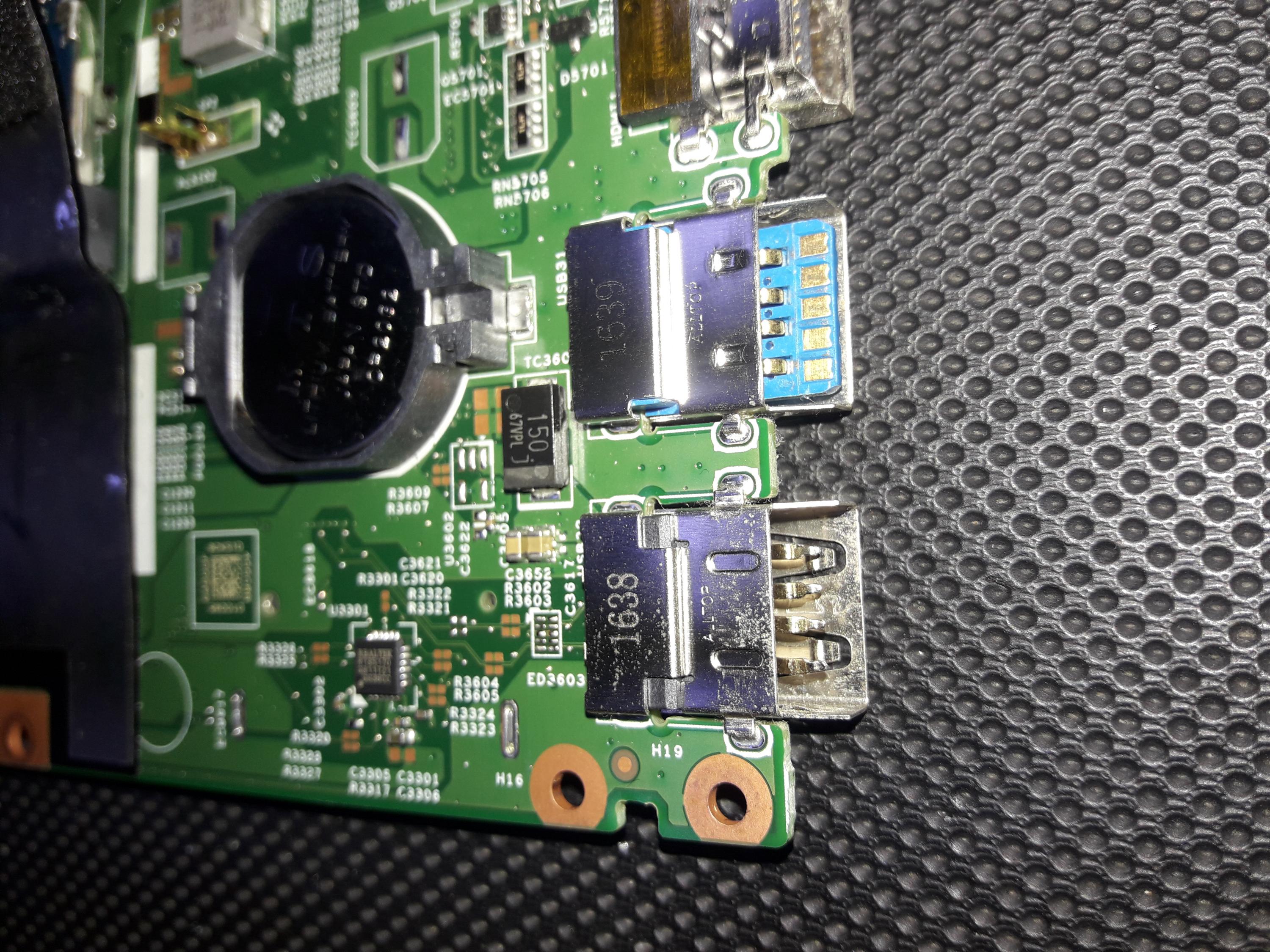

So, I fixed the usb by sacrificing the integrated web camera. Took the camera, cut the cable, identified the power and ground lines + data +/- (always twisted wires), ignored other two, found an unused space on the MB to place a new usb port, soldered the wires, cut the plastic cover of the laptop to support for the new usb port, and it was done. An usb 2.0 port, with something like 3.3 V instead of 5.0V (last measure) but it seems it supports a mouse and/or an usb memory flash.
Thanks for the advices though, I'm sorry it didn't worked out with the strap, it would have been wonderfull, but I didn't knew how to debug the short I was having.
