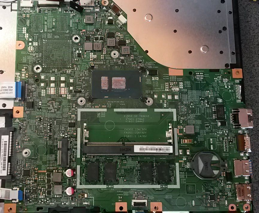

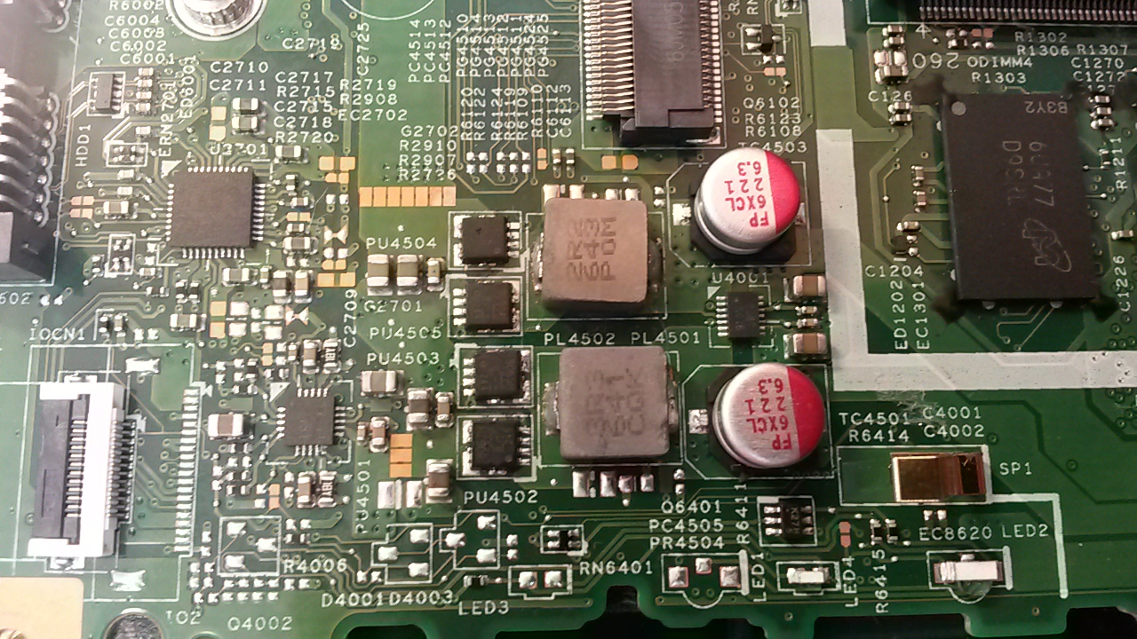

    I have faulty Lenovo V110-15ISK with Motherboard LV115SK MB 15277-1 448.08B01.0011
    There is a short 'pulse' of 3.3V and 5V, checked for short, replaced mosfets (PU4502, PU4503, PU4504, PU4505).
    Checked for shorts, find only on CPU supply choke 3.3 Ohms. No shorts on chokes supplying other components.

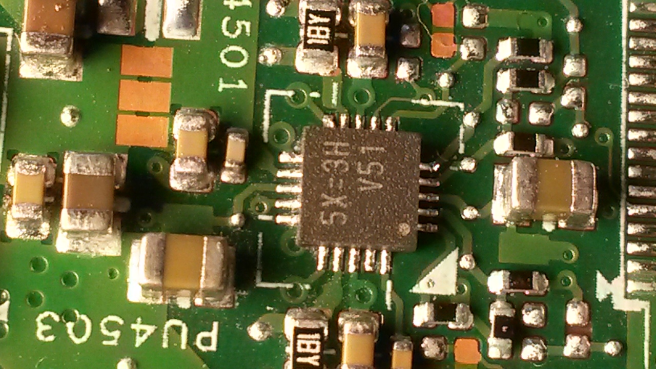

    wanted to replace controller for 3.3V and 5V (PU4501), but no marking on component.
    Could anyone help me determine component, maybe got a schematics?

    Schematic unavailable for this model as per vinafix. Can u tell the marking on PU4501 so that someone can suggest an alternative or may be datasheet?
      Re: Lenovo V110-15ISK schematics
      Marking on PU4501 IC is 5X=3H V51
      Any idea with that can it be replaced?
        Richtek RT6575DGQW
          Thanks piernov!
          Purchased component from ebay RT6575A.
          After adding 3,2V on EN1 and EN2 pins got right voltage on 5V and 3.3V chokes, but IC PU4501 turns very hot. Will see after replacement.

              Inject 5v/3v and see what gets hot.
                very often SIO chip is shorted
                  Injected 5V/3,3V find hot only the same IC PU4501, SIO chip cold
                              I need to know what electronic piece is U3601, it is related to tthe two usb ports, one of those shortcircuited and u3601 fried. Please help !
                                By looking at an image of your mobo, U3601 seems to be simply a switch which passes 5 volt supply to USB port when an enable signal is received - probably from SIO but without schematics cant tell definitely. First make sure if it is connected to the 5V line of USB port. If yes, one of IC's pin must be receiving 5 volt as input. Simply short the input 5V to output via a jumper. That should fix it assuming other sections of the board are fine.
