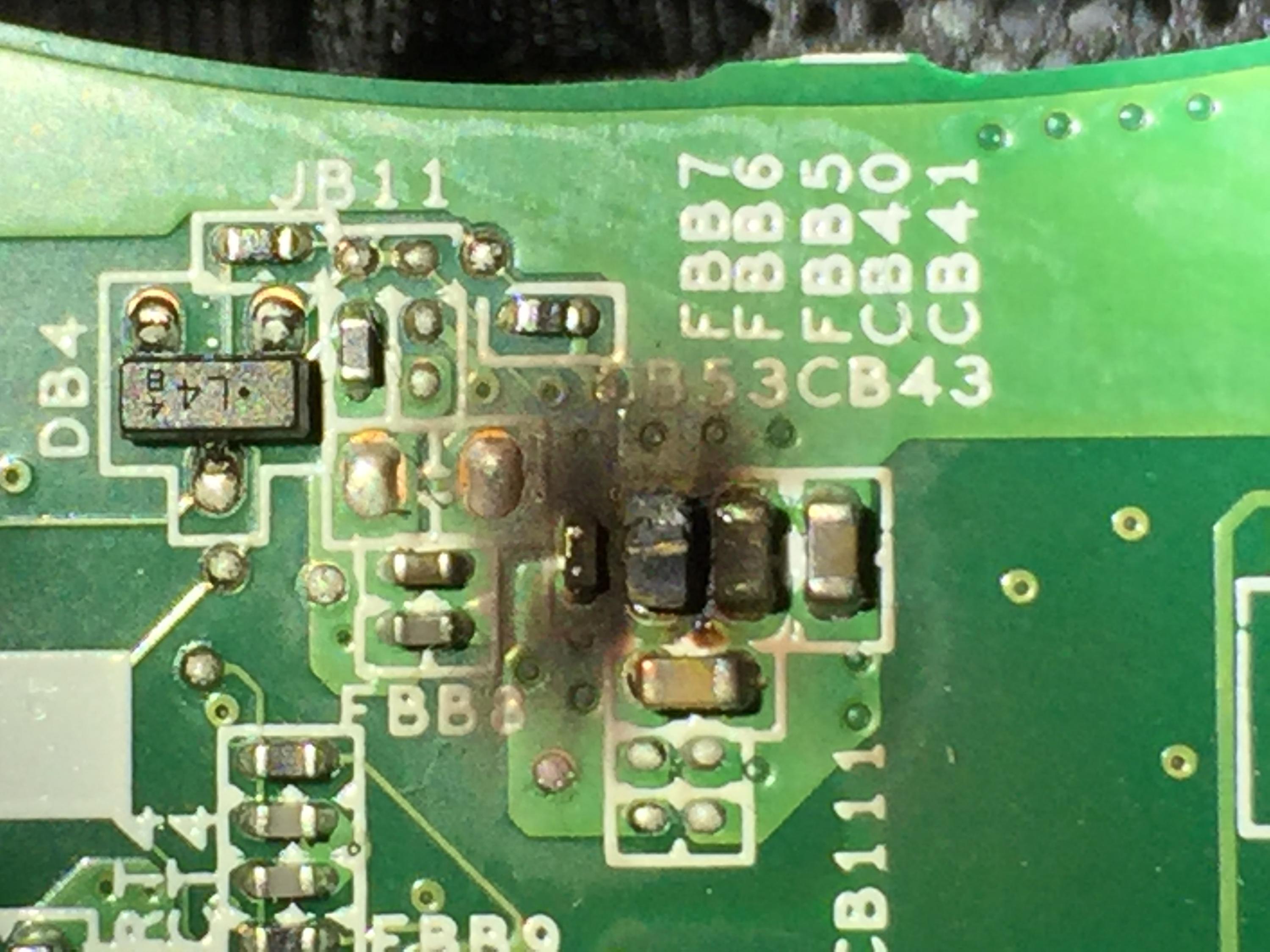

    I have a HP laptop with some burned parts & need to identify. If you could help with the schematic or what the parts are below so I may replace them. Photos below.

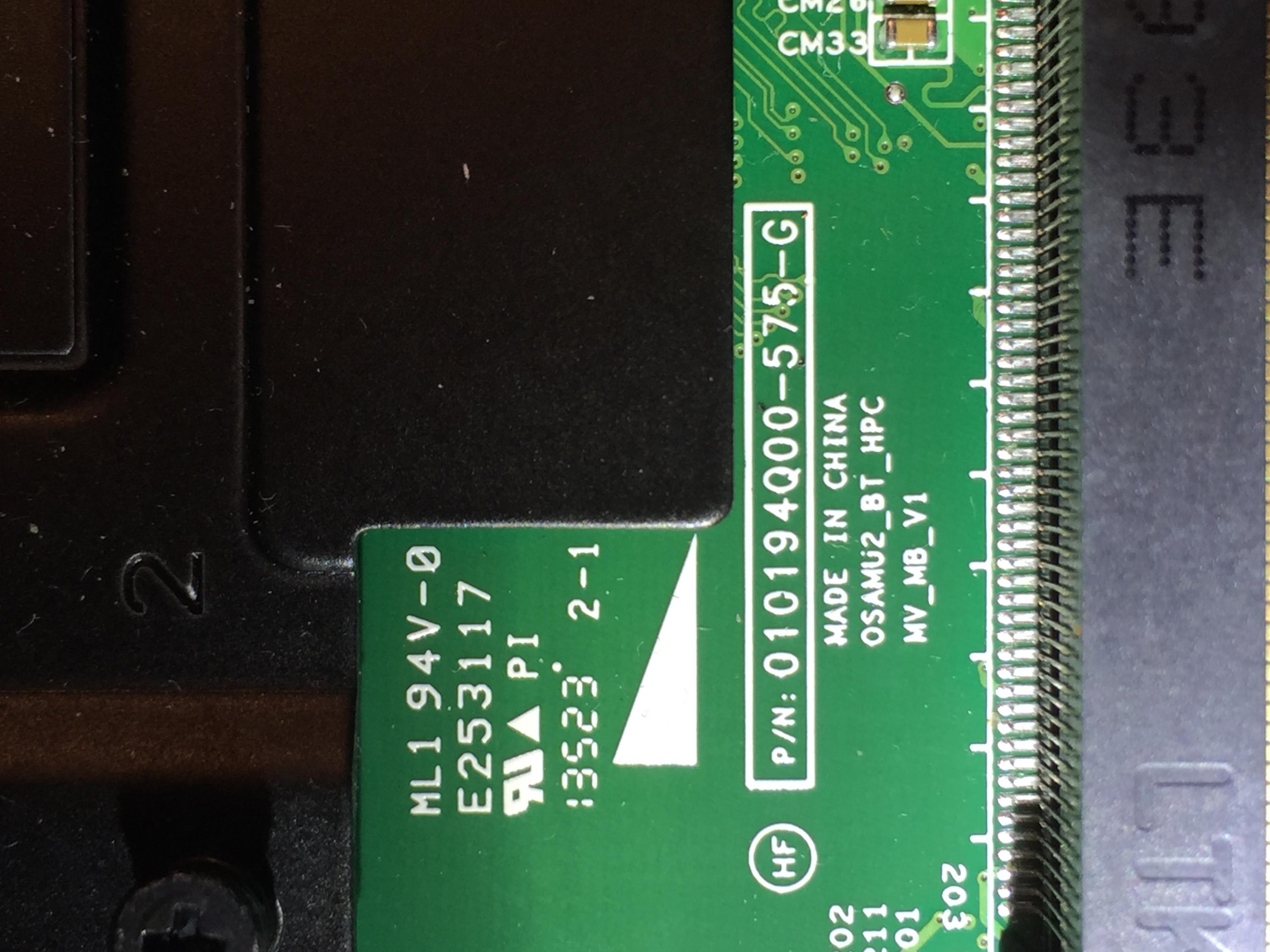

    laptop model #: HP 15-D035DX
    motherboard p/n: 010194q00-575-g

    you have other problems,
    that's an inductor, so there is probably a short after it.

      can you clean it first?
      Like STJ said, you got a short there.
      take it out and clean it.

        Thanks for your help. I found some broken traces & more shorts. It wasn't worth my time & decided to replace the board.

          Where is the short?
          Now that the board is scrap , Inject 3v and see what`s dudu.
