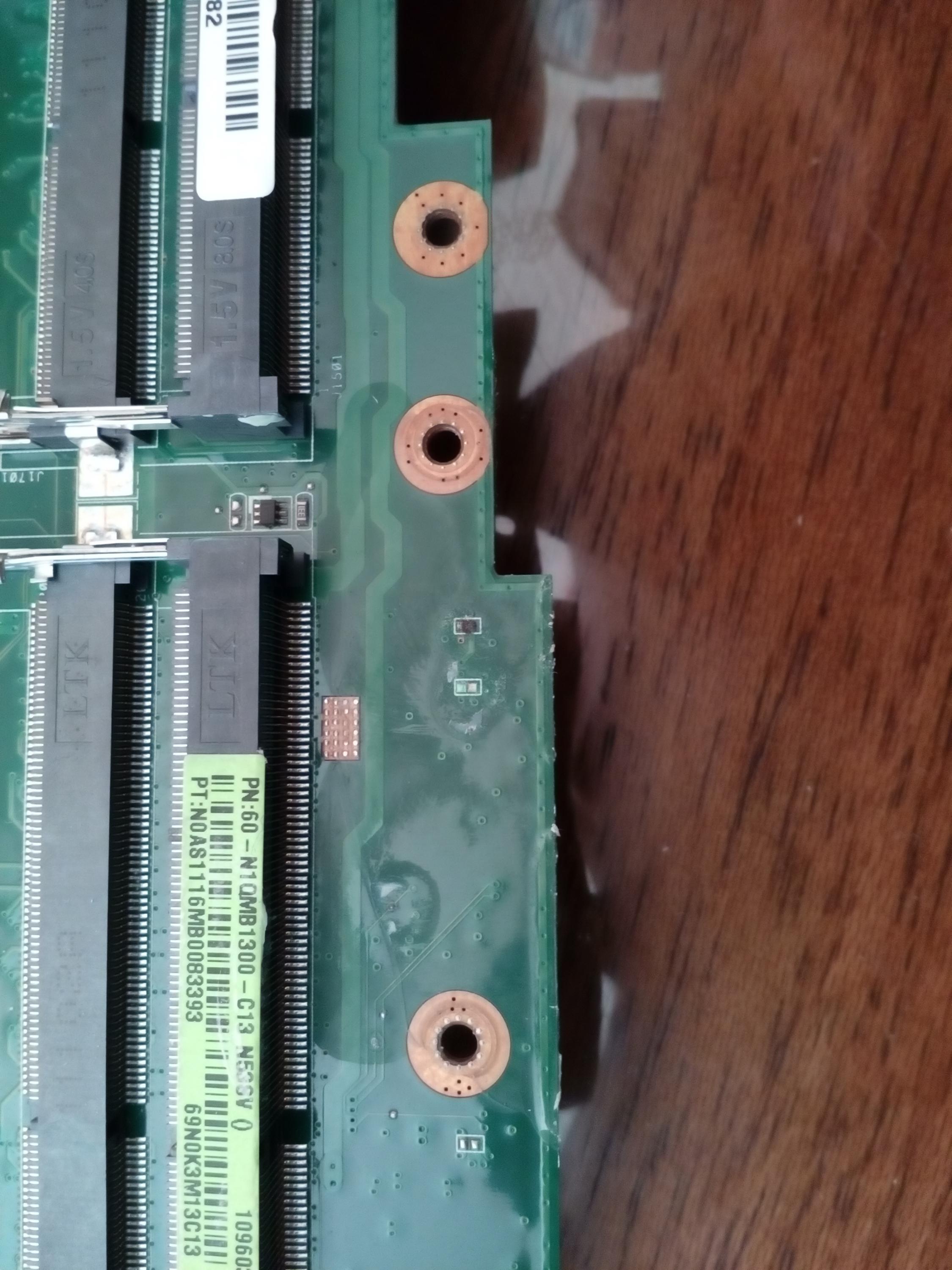

    G'day,
    My toddler tipped her milk over my Asus n53s laptop which resulted in some shorts to surface mount components on the motherboard near the ram slots. Anyone have a schematic to show what they are, or a board sitting around to check against? After the two possibly 3 ? Components in the photo.

    All three are capacitors at 5v rail. Should work without them also, clean the pads and replace with similar size caps.

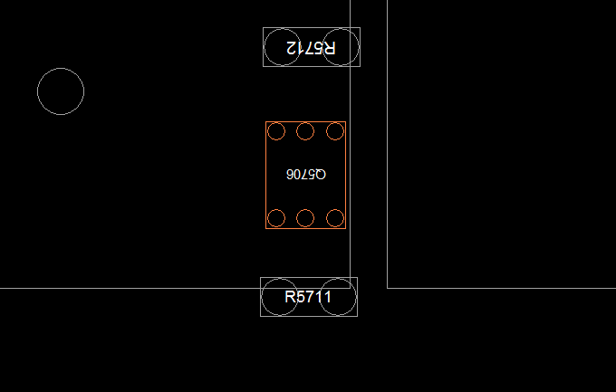

      Q5706 - um6k1n

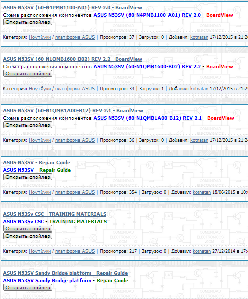

        Hi
        This should help you out S Series not released .

          asus n53s mb n53sv
