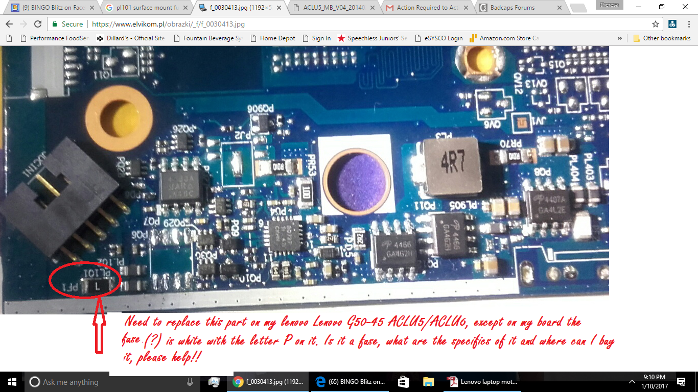

            I believe the part I am looking for/at is a fuse but not sure need help. I don't know what all the parts are because I am new to working with electronics in relation to circuit boards. So I would appreciate it if you can make it as simple as possible.

              Use the above schematic page 51 PF101 is 7amps check for short first from the fuse to ground before fitting the new fuse.
