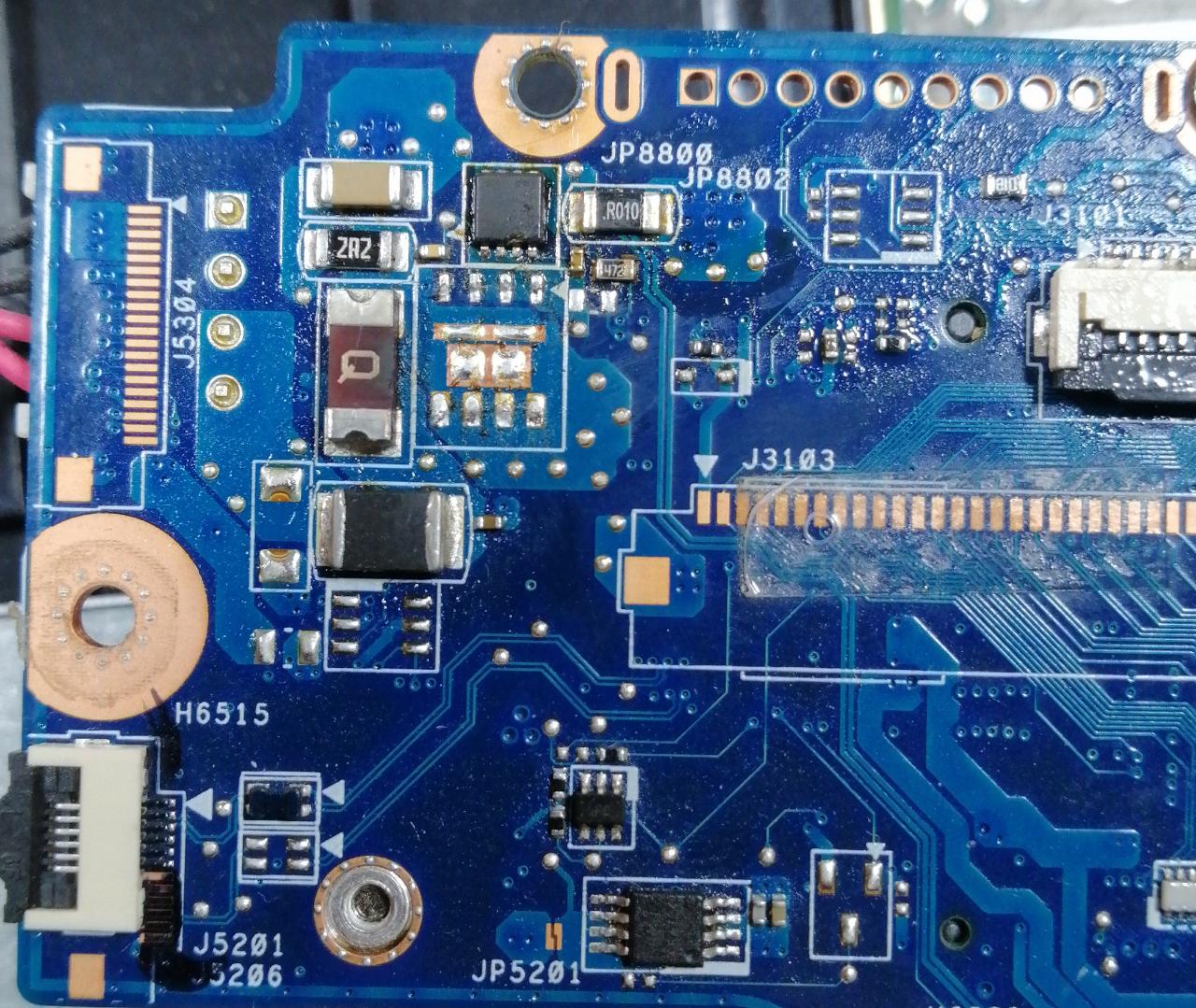

        i need to know q8800 it is missing from the board, i have board view but cannot find the ic name
        thanks

          Re: C850 (plf/plr/csf/csr uma mb rev 2.1
          Q8800=si7840dp

                      Re: Help! I need schematics for this board. Toshiba C850 (PLF/PLR/CSF/CSR UMA MB REV
                      plf/plr/csf/csr uma mb rev 2.1 schematic also.. plzzz.. When I connect my power adapter, the power (3V 5V) IC gets hot. what should i do?

                          #52
                          first check the LDO and short circuit, if your LDO is ok you can check the always output then you can find out the problem area
